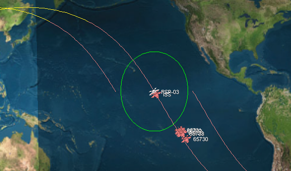

The five cubesats deployed from ISS on Sep 19 (GHS-01,Dragonfly, ASC, RSP-03, STARS-Me2) are objects 65729 - 65733
Is this information correct?
Looking at the cospar this seems to be the case, the objects are already 8 minutes ahead of ISS.
@fredy Maybe choose some random object ID’s from this range to the SatNOGS obs.
Yes these are the candidates for the J-SSOD#32 satellites.
I’ve just done it and I’m going to re-schedule observations.

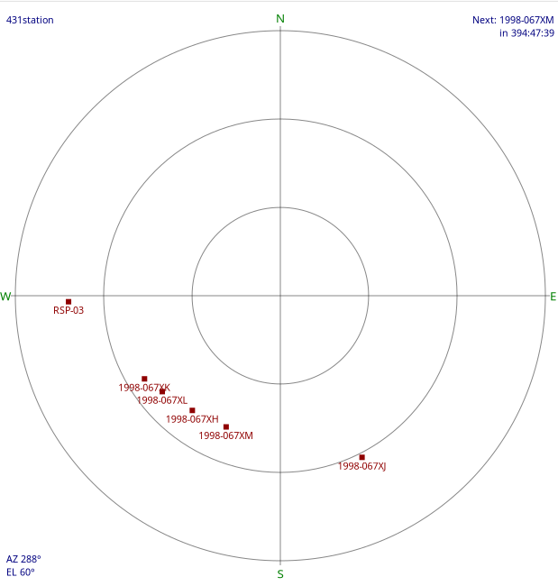

Below a pass showing the 5 new objects (1998-067**) against the one we used until now (RSP-03).
As we can see it seems that the TLE generated based on GHS-01 signals is close to the real ones (after 3-4 days of the observations) which kind of verifies that these signals were coming from GHS-01.

  1. For GHS-01 I’ve used the good observations and it seems that fits better 65731, however this should not be enough to identify it. We will need more observations
  2. 65730 is more separated than the others, a wild guess is that it is the “Atsushi Space Challenge” satellite. This is based on the nature of the mission that, I guess, doesn’t have subsystems in it, so its weight is different from the other cubesats, so maybe this explains the difference. Again this is a speculation that may not be true!

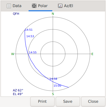

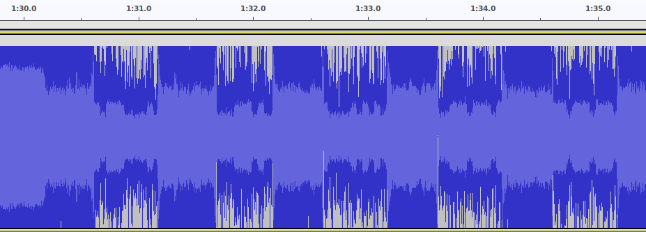

There is another interesting RSP-03 observation at:
… instead of just a center carrier / CW-type waveform, there are non-stop data packets. Unfortunately I’ve not yet been able to decode them w/ any of our standard baud rates & FSK framing types.
However, around the 1:30 point, there is clearly CW being transmitted as well. Sadly, it’s covered by the data packets so you don’t get much of a CW decode either.

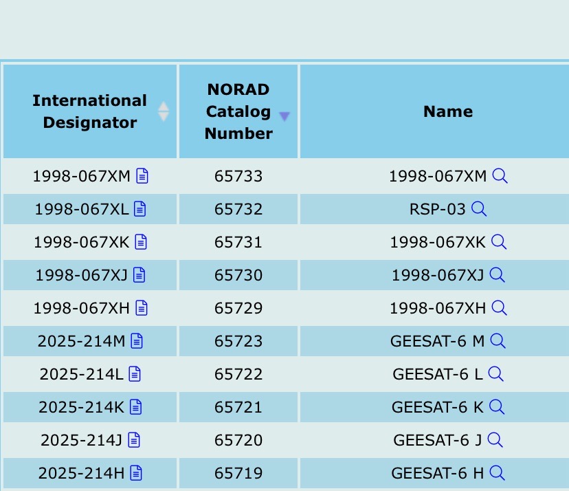

Is 65732 a random choice or it is based on some evidence?
Do you want me to change RSP-03 to follow this object in DB?
Hello @fredy, SatNOGS community All,
We noticed that CelesTrak has updated the catalog, and RSP-03 appears as object 65732.
In addition to this, RymanSat has actually received weak CW signals near 437.05 MHz over Japan, and based on this confirmation we have officially started uplink/downlink challenge operations (see: https://x.com/RymanSat/status/1971854527482810875
Our intention here is not to request an immediate change of the TLE in DB, but simply to share information that may help the community. If more validated evidence becomes available, we would like to formally propose an update of the TLE association. Of course, we respect SatNOGS maintainers’ autonomy and final judgment on such changes.

65729 98067XH
65730 98067XJ
65731 98067XK
65732 98067XL
65733 98067XM
