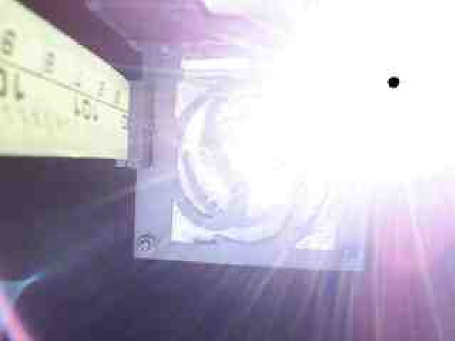

restore, not perfect , from 5 observations, image #221:
over
i you interest to implement this on your groundstation, follow this
tutorial - step by step

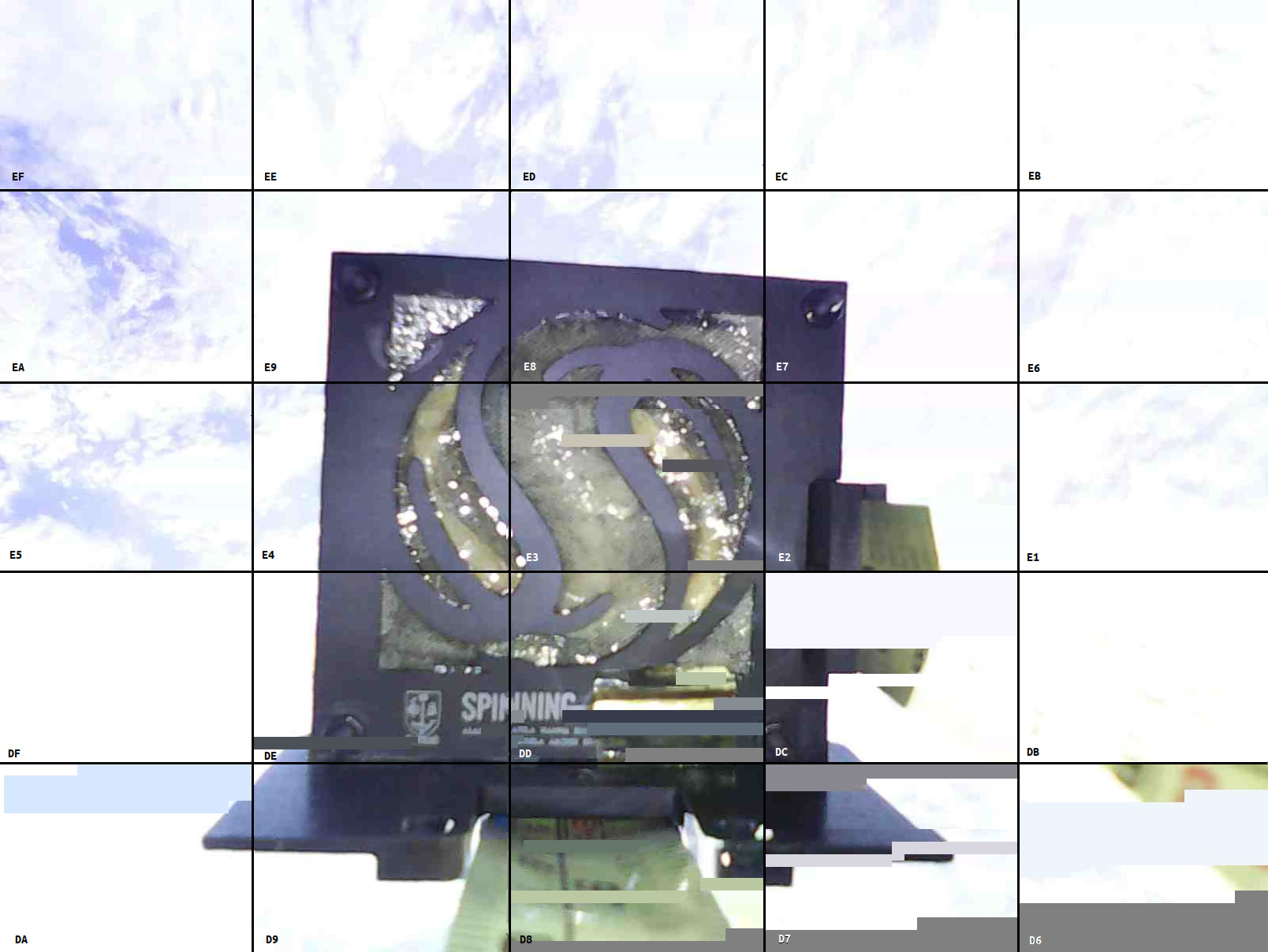

image 234 , restore from some observations: 14232526 , 14223856
just update to latest satnogs docker client (satnogs-flowgraphs-2.5.2), no need addon.
replay the ogg audio file on soundmodem

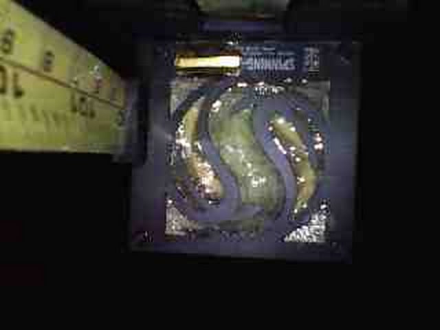

HADES-SA SSDV Images June 3-5
#227 , 228, 231, 232, 233

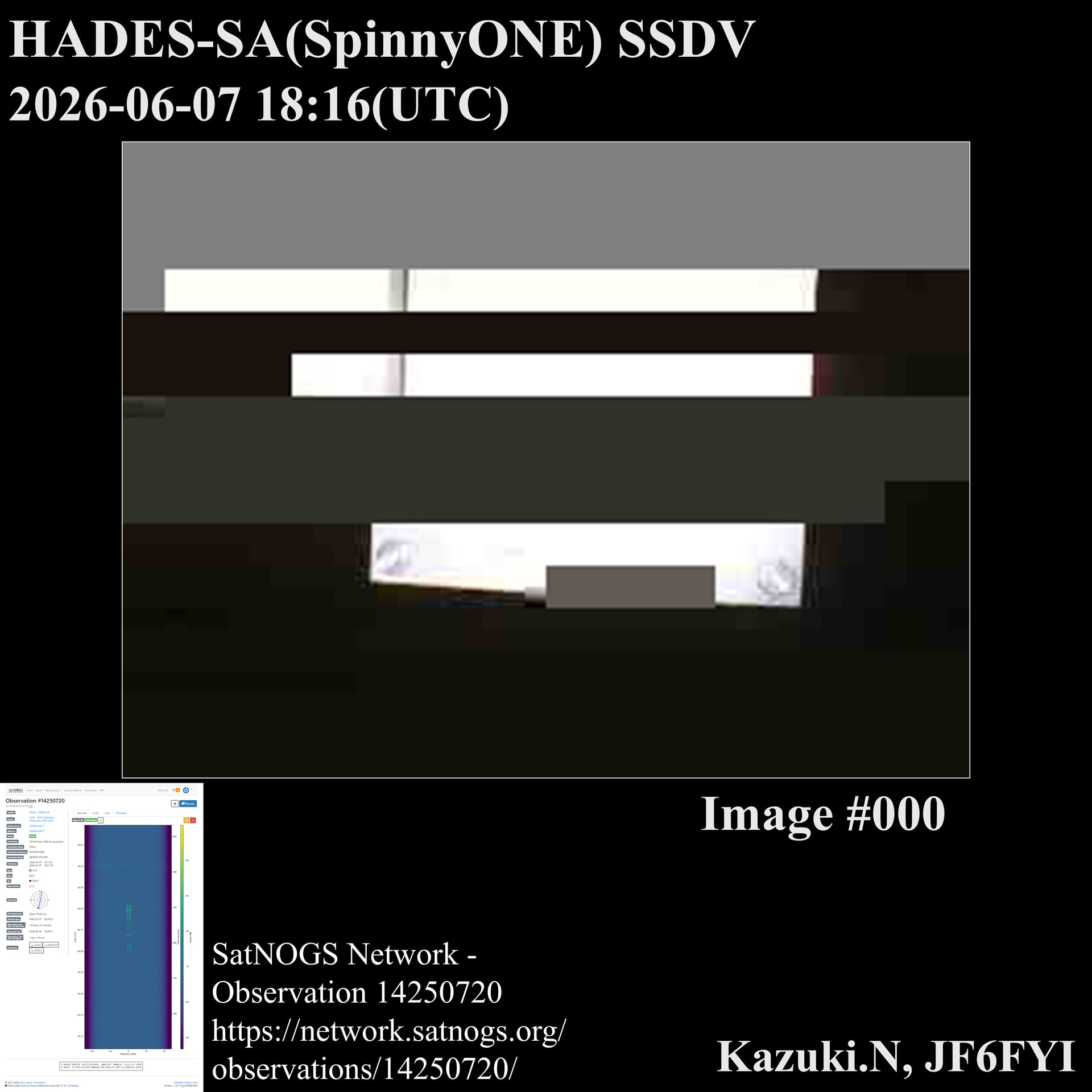

2026-06-07 18:16
SatNOGS Network - Observation 14250720
With the update to satnogs-flowgraphs-2.5.2, my SatNOGS ground station is now able to record audio that can be decoded later. This is a very welcome improvement, as it allows me to conveniently analyze observations made during weekdays and late at night when I am unable to monitor passes in real time.
The image I recovered has an ID of 000. Does this indicate that the image was retransmitted?

On the HADES-SA (SpinnyONE) satellite, SSDV Image ID 0 is a pre-loaded commemorative mission plaque stored in the satellite’s Flash memory . It was designed as a backup image to be transmitted if the digital camera experiences processing issues or fails to capture a new photo.
Hello @PY4ZBZ ,
Thank you. That cleared up my question.

Obviously the preloaded image #000 has been overwritten. Here is the original image as it was received in Greece a few minutes after the deployment of the satellite Transporter-16 Rideshare: VSFB SLC-4E : 2026-03-30 11:02 UTC - #72 by sv2hwm

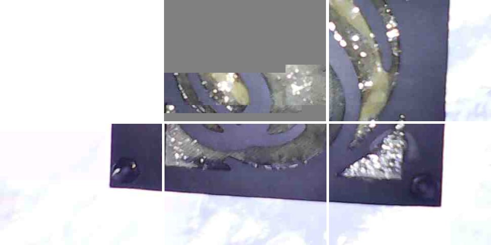

I, JE9PEL, rotated Image 25-tiles 180_degrees and combined.
https://www.ne.jp/asahi/hamradio/je9pel/hadesas2.htm

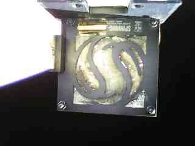

Image #016 copied in Brazil.
