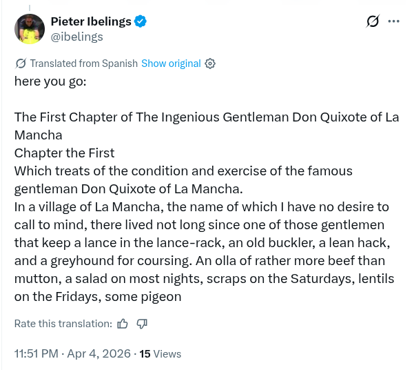

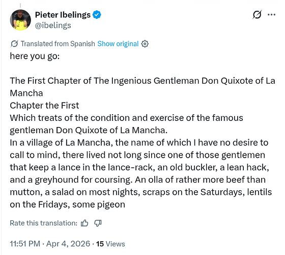

… if anyone who speaks the language has time to listen to my .wav file linked above, it would be great to know if it’s understandable. Thanks!

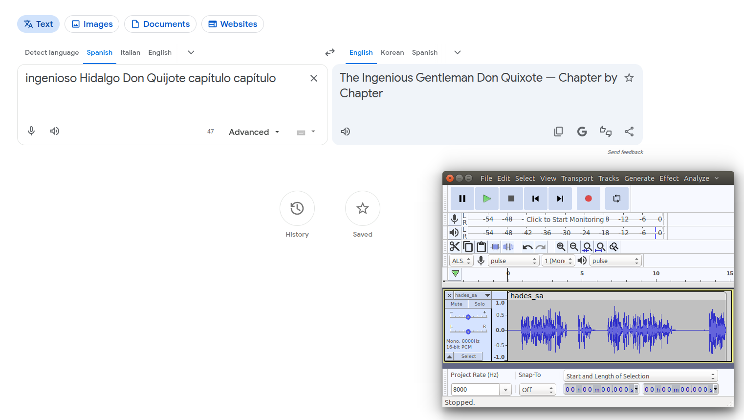

Just for fun, I let Google Translate listen to the CODEC2 audio. Appears to be a good translation of several words.
Thank goodness for smart people!
