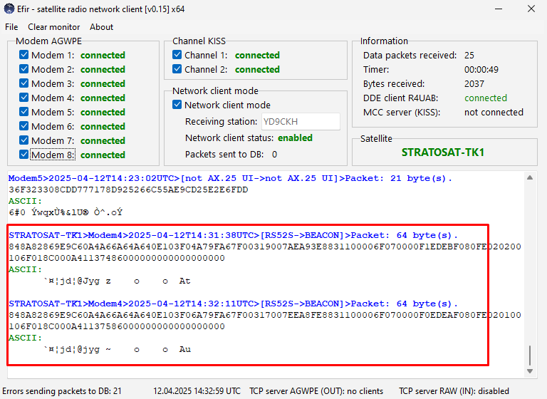

thank you for your information. but i never seen the signal for Digital Image…
onlly a beacon from StratoSat-TK1
If I’m not mistaken, transmissions are only made in the Russian region.
Add frame length parameter to GEOSCAN deframer
A couple of months ago GEOSCAN framing has been modified, more details via this link.
My best guess is, that this isn’t modified within the geoscan soundmodem version and could explain why only StratoSat-TK1 (old framing) is decoded.

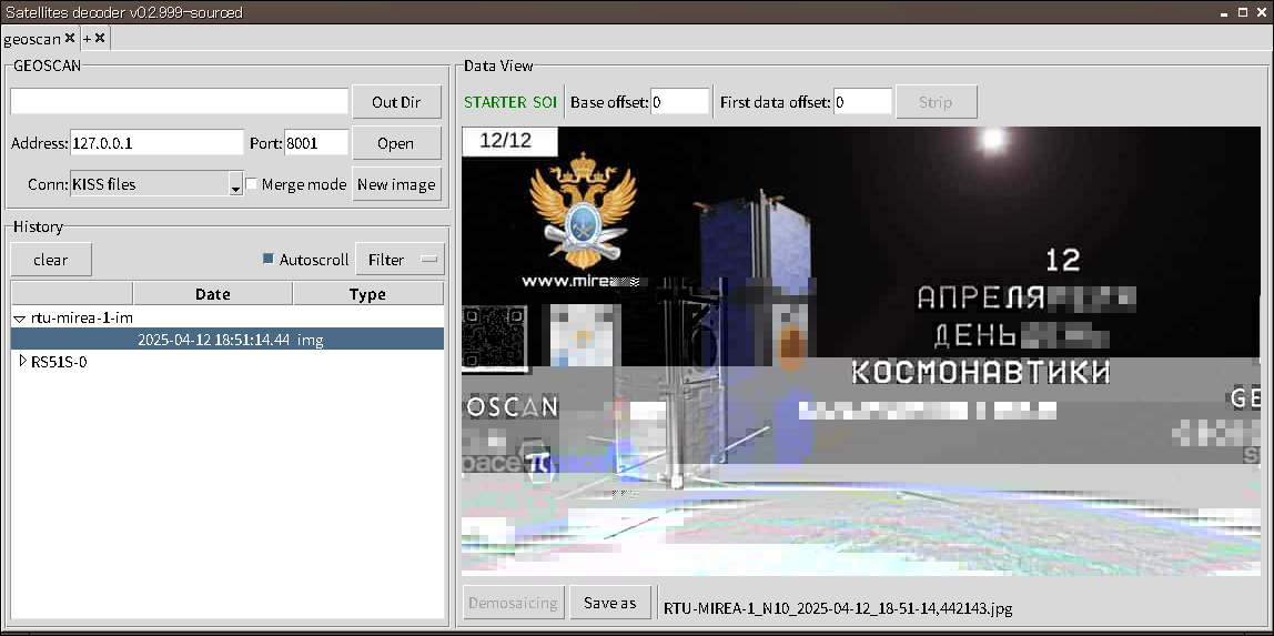

I’m using gr satellites for decoding and load afterwards the kiss files into baskiton’s SatsDecoder to extract the images.
Good to see this an option.

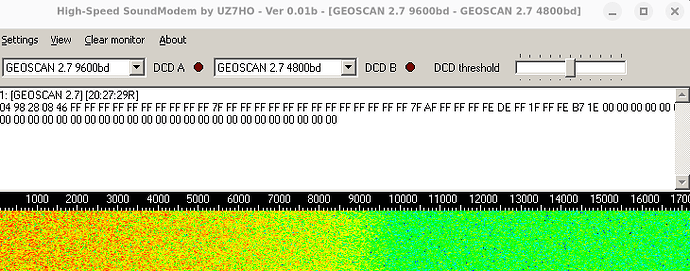

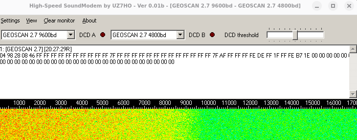

Andy, UZ7HO has created an updated GEOSCAN hs_soundmodem that support the alternative frame size as used by for example RTU-MIREA1.
Below a RTU-MIREA1 audio replay.
I am not yet sure if this version will work on both frame sizes or just one, if so you will need two version of this soundmodem software.
I just got a confirmation that you will need two version, the previous versions can be found at this location.

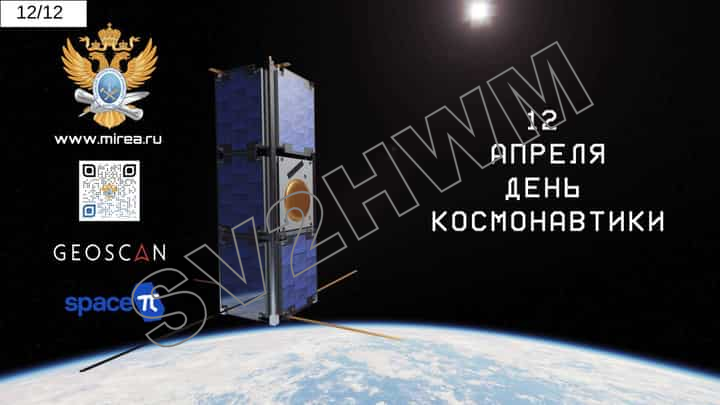

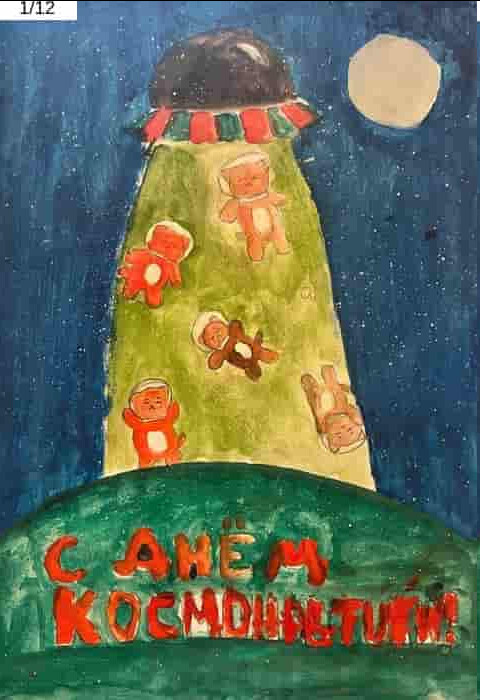

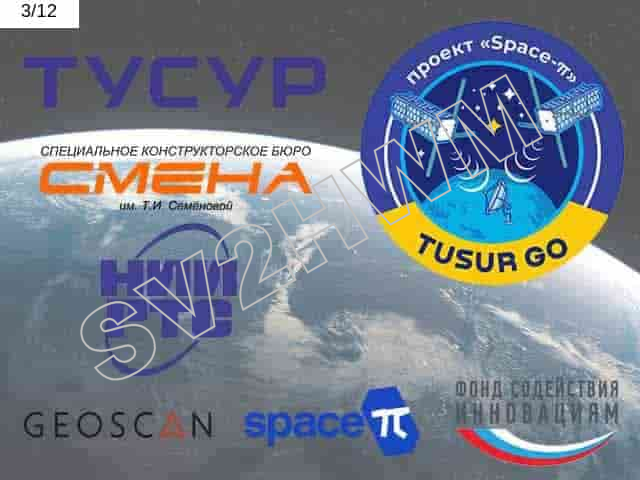

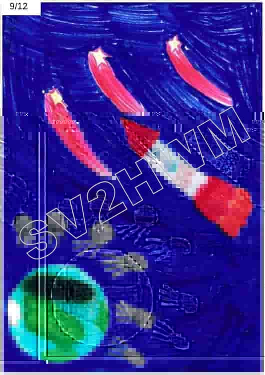

2025-04-11 06:34 UTC - RTU MIREA-1 - Replay of recorded IQ in :greece:
2025-04-11 06:39 UTC - TUSUR GO - Replay of recorded IQ in :greece:
2025-04-11 19:34 UTC - RTU MIREA-1 - Replay of recorded IQ in :greece:
will this work with TUSUR as well?
Yes, it’s working with RS78S, too.
