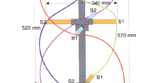

A UHF ground station is useful, a VHF turnstile could be made without too much bother or you could try this. I need to make one of these to give a comparison though
