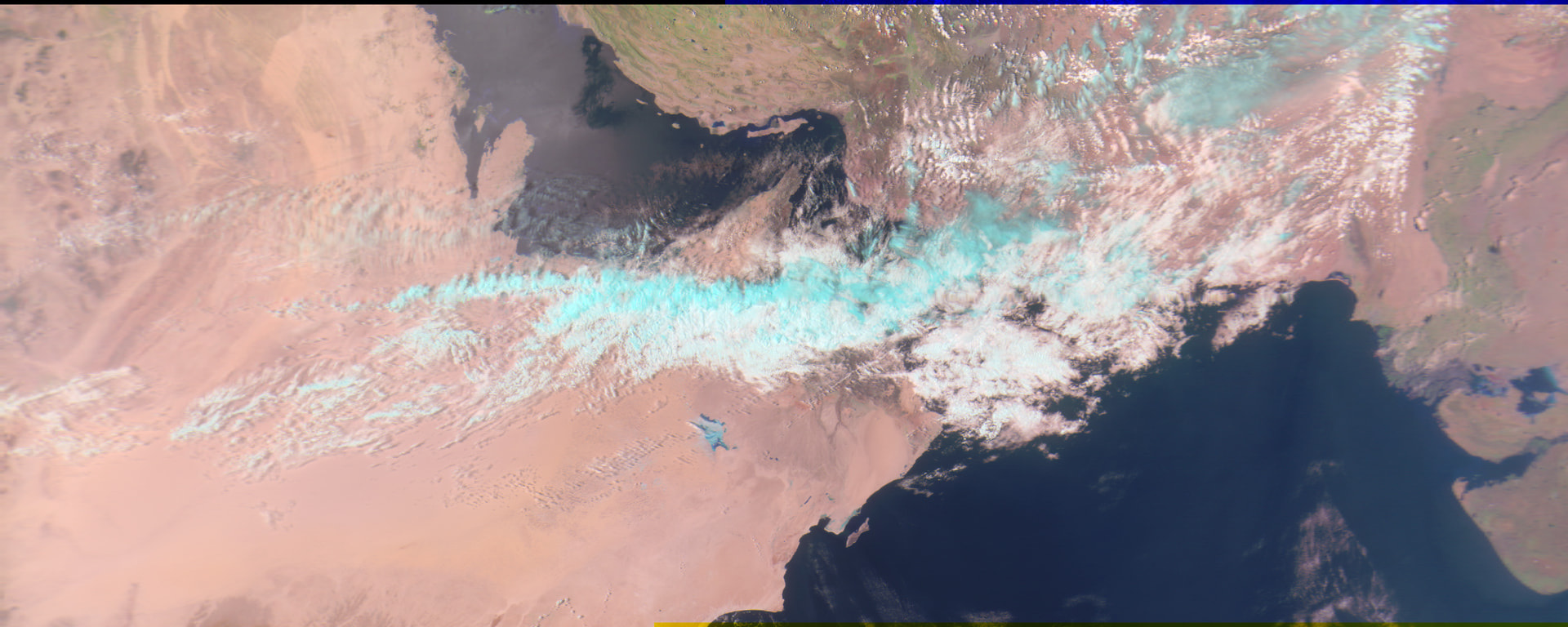

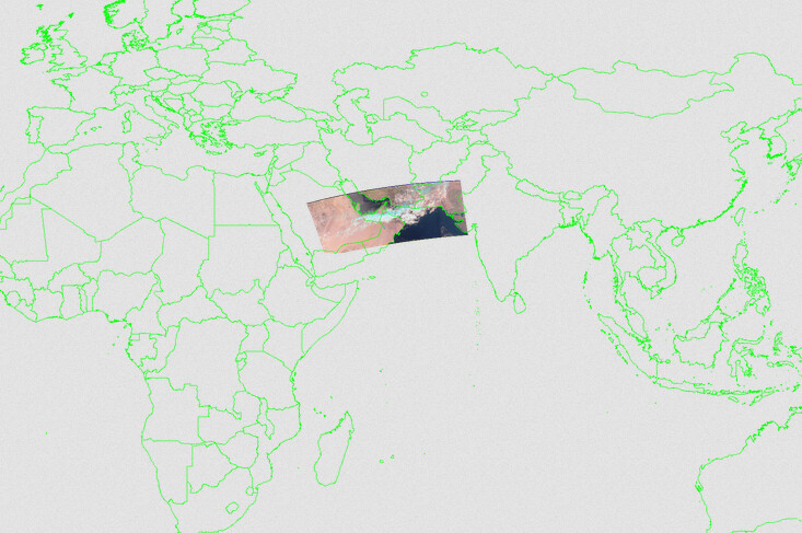

Hi @bali my friend, here is the observation of 57166 - METEOR M2-3
Thanks for the recommendations.
wow! spectacular. beautiful scene.

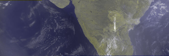

i reupload here for archieve:

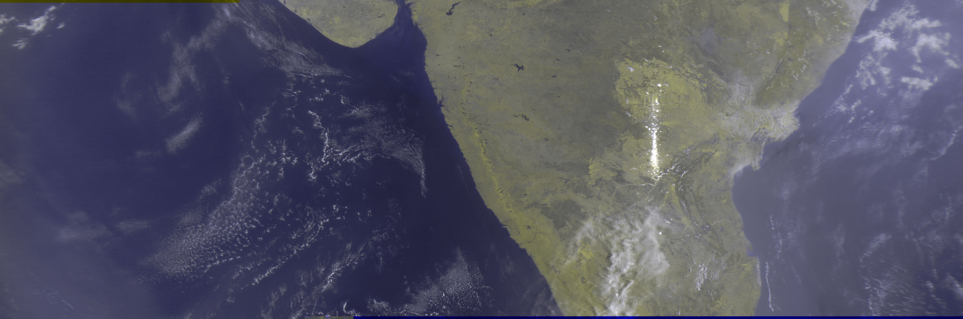

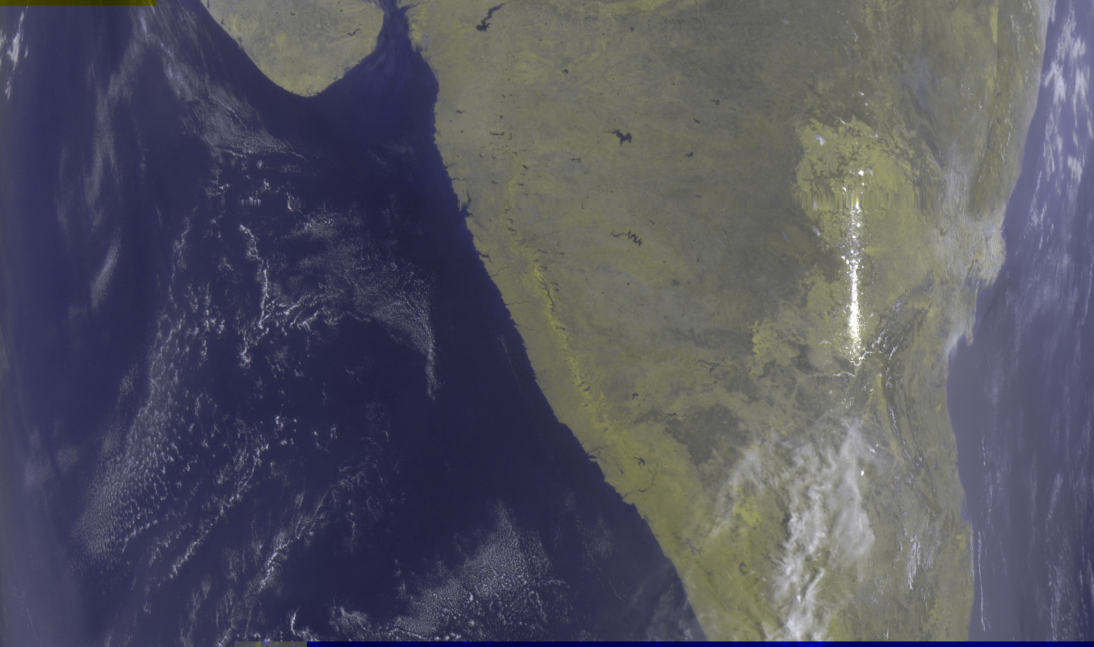

i’m wondering what is the white line in the photo.

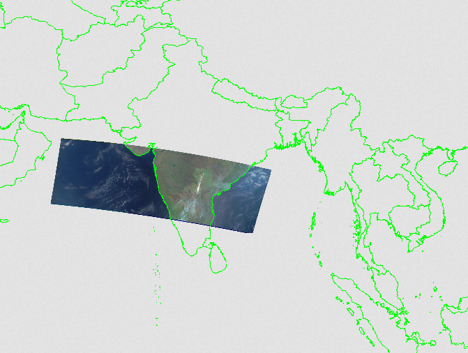

@bali Here is the observation of 59051 - METEOR M2-4
not 100% sure but it’s most likely a sunlight reflection artifact from the satellite sensor during scanning
incredible and good signal at low elevation to the west. wow hormuz straits
kewl!
