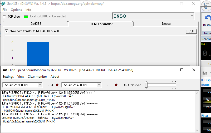

last signal:
Decode:
gr_satellites 58470 --wavfile satnogs_12707175_2025-11-09T06-15-42.ogg

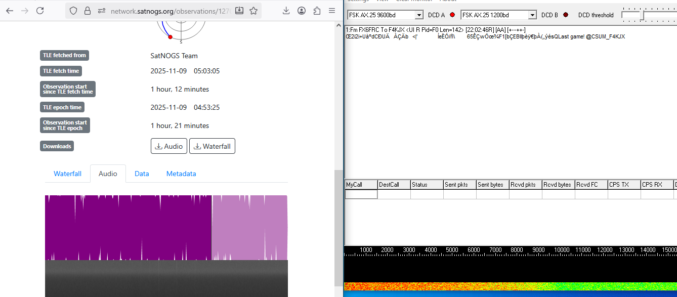

or maybe the last one…
gr_satellites 58470 --wavfile satnogs_12708504_2025-11-09T07-10-31.ogg
-> Packet from 9k6 FSK downlink
Could not parse telemetry beacon Error in path (parsing) -> header -> addresses -> callsign
stream read less than specified amount, expected 6, found 2
ENSO has now re-entered, probably somewhere between India and Antarctica.
The last received transmissions from SatNOGS Network was:
The last observation with decoded frames in Network:
I tried to convert back your decoded beacons to hexadecomal to use thair website to have the meaning of the data, but it tells me wrong AX25 header for every one of them.
Hexa
8c10f5311069f03110692b030455d0ba0200640143d055c481c1c7c40062810e0f3c007c27008181818181cc65cbe039fb5c093232ca11c703770000d20a9cbf00462e00000a02032f0335c60045003601100049004e00000002020107fec80000007824e60108fb6f000200000000000000000000004c6173742067616d652120404353554d5f46344b4a582020
8c10ff311069fa3110692b030455d0ba0200640143d055c481c1c7c40062810e0e3c007c28008181818181cc65cbdc37f85c093433ca11c703770000d30a9cbe00462f00000a02033a0340c70045003601100049004900000002020107fedc004cff5425c9fec2fc83015400000000000000000000004c6173742067616d652120404353554d5f46344b4a582020
8c100a321069043210692b030455e0ba0200640143d055c481c1c7c40062810e0f3c007c28008181818181cc65cbd935f65e093434ca11c703770000d40a9cbe00462f00000a020345034bc60045003d01100049004900000002020107ff90ffe0fed826b2fc95ff14012100000000000000000000004c6173742067616d652120404353554d5f46344b4a582020
8c10143210690e3210692b030455e0ba0200640143d055c481c0c7c40062810e0f3c007c27008181818181cc65cbd831f360093634ca11c703770000d50a9cbf00463000000a0203500356c70045003b01100049004900000002020107ff7cff54fec82793fc7101e7004600000000000000000000004c6173742067616d652120404353554d5f46344b4a582020
8c101e321069183210692b030455e0ba0200640143d055c481c0c7c40062810e0f3c007c27008181818181cc65cbd32ff15c093635ca11c703770000d60a9cbe00463100000a02035b0362c70045004201100049004900000002020107fee8ff80fec02884fde90373005100000000000000000000004c6173742067616d652120404353554d5f46344b4a582020
8c1028321069223210692b030455e0ba0200640143d055c481c0c7c40062810e0f3b007c27008142818181cc65cbd02bef5d093736ca11c703770000d70a9cbe00463200000a020367036ec80045003601100049004900000002020107feacffd8ff10297ffffb03bd010700000000000000000000004c6173742067616d652120404353554d5f46344b4a582020
8c10663210695e3210692b03045510bb0200640143d055c481c0c7c30062810e103d007d2700818181da81cc65cbbc19d962093e3ccb11c703770000dd0a9abb00463800000a0203c303cdc8004a004601100049004e00000002020107fe64004400d4318a01f6fa44018a00000000000000000000004c6173742067616d652120404353554d5f46344b4a582020
8c107a321069723210692b03045510bb0200640143d055c300c0c7c30062000e0f3d007d27000000000000cc66cbb310d26209413fcb11c703770000df0a9bbb00463a00000a0203eb03f6ca004a00460110004e004e00000002020107ff18ff48fe683539fcfffe4602ac00000000000000000000004c6173742067616d652120404353554d5f46344b4a582020
It seems it’s supposed to start with at least 8C 68, not 8C 10.

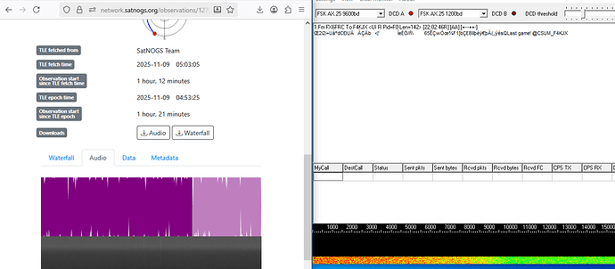

Watchout for the difference between the AX.25 Header and the AX.25 Information.
The header here is indeed valid with FX6FRC and FK4JX.
You are trying to decode only the AX.25 Information in a tool that needs both the AX.25 Header + AX.25 Information.
need --hexdump option so like this:
gr_satellites 58470 --wavfile satnogs_12707175_2025-11-09T06-15-42.ogg --hexdump
result
((transmitter . 9k6 FSK downlink))
pdu length =        158 bytes
pdu vector contents =
0000: 8c 68 96 94 b0 40 e0 8c b0 6c 8c a4 86 e1 03 f0
0010: 8c 10 f5 31 10 69 f0 31 10 69 2b 03 04 55 d0 ba
0020: 02 00 64 01 43 d0 55 c4 81 c1 c7 c4 00 62 81 0e
0030: 0f 3c 00 7c 27 00 81 81 81 81 81 cc 65 cb e0 39
0040: fb 5c 09 32 32 ca 11 c7 03 77 00 00 d2 0a 9c bf
0050: 00 46 2e 00 00 0a 02 03 2f 03 35 c6 00 45 00 36
0060: 01 10 00 49 00 4e 00 00 00 02 02 01 07 fe c8 00
0070: 00 00 78 24 e6 01 08 fb 6f 00 02 00 00 00 00 00
0080: 00 00 00 00 00 00 4c 61 73 74 20 67 61 6d 65 21
0090: 20 40 43 53 55 4d 5f 46 34 4b 4a 58 20 20
