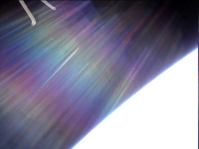

ENSO Image
2025-10-27 10:30:27 UTC.
El 9°, Alt. ~301 km according current TLE. QRM.
339 Frames uploaded.
Decay prediction November 9

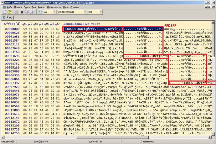

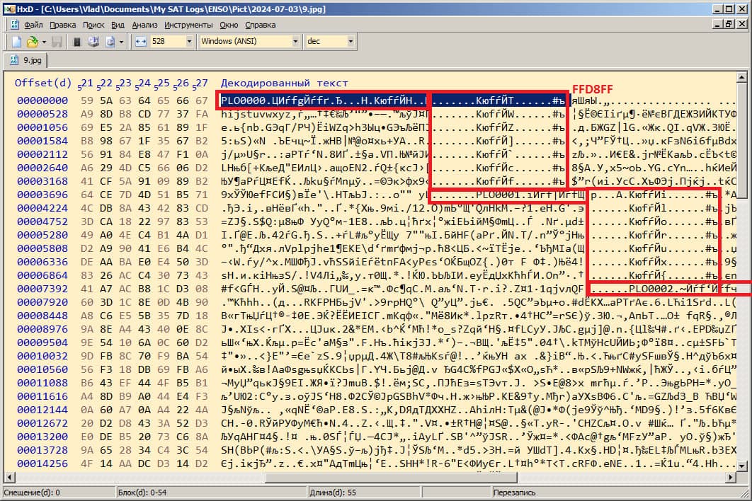

Hi Vlad,
How do you decoded the packets to an image?
I decoded manually.
I didn’t find any publicly available decoders.
Could you describe how you decoded the packets to an image?
You just need to cut off all unnecessary (service information) and you will get a sculpture :slight_smile:
This process takes me more than 30 minutes, it will take me several hours to describe in detail.
Unfortunately, I don’t have that kind of time right now, but if you will insist, I’ll try to find the time the day after tomorrow.
The excess is highlighted in red and it starts with “PLO0000”.

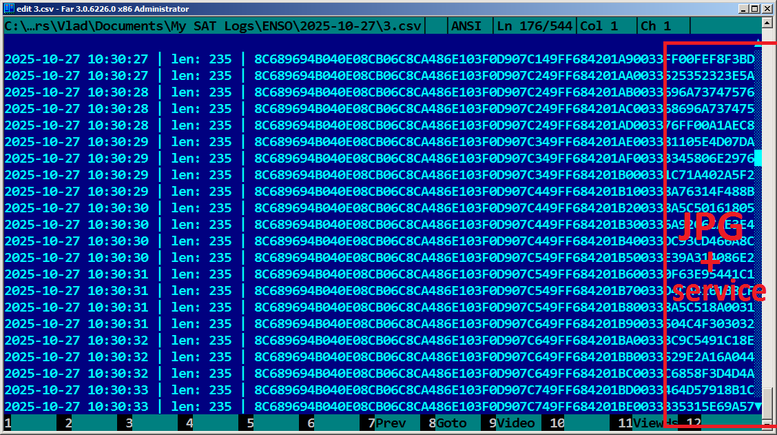

For decoding I used:
  1. My *.KSS File from GetKISS+ (DK3WN)
  2. kiss_csv.py from @SA2KNG :
    GitHub - kng/geoscan-tools: Process frames from satellite Geoscan-Edelveis · GitHub
  3. FAR (File and Archive Manager)
  4. HxD HEX Editor.
Please read:
After careful reading, you will see that the information I posted above is enough to manually decode the image.
Huge thanks to @K4KDR and @SA2KNG for the information and programs.
thank you. i will try
Do not forget that the source file must contain FFD8FF (JPEG file header), otherwise decoding does not make sense.
OK. noted

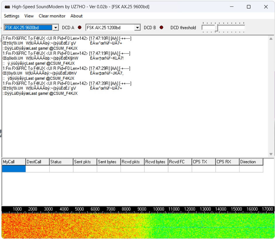

Hello, I captured a several ENSO telemetries from the SatNOGS station/ manually. Is there any link where I can found the decoder? I see everyone was using High-Speed Soundmodem Ver. 0.02b with FSK AX.25 9600bd but I can’t find the HS Soundmodem with that version.
Thanks
High-Speed SoundModem for FSK without G3RUH
I’m using gr_satellites.
