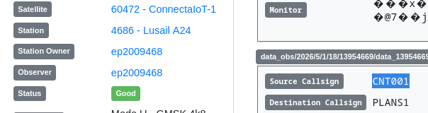

My station is good i received signals and got the hex codes, SatNOGS Network - Observation 13954669 here is my observation, my professor wants a person from the community to verify this observation. I also tried scheduling the satellites you recommended I think my setup is limiting the signals that i get, so ill just stick to this and explain that the other hex codes couldnt get decoded and show him this post that i did. Thank you for your help.

I looked at observation 13954669.
From what is visible there, I would consider it a valid technical result for a small ground station project.
The observation is marked Good, the waterfall shows signal, the pass geometry looks strong, and SatNOGS extracted several data entries for ConnectaIoT-1 using the U-GMSK 4k8 AX.25 telemetry transmitter.
So I would describe the result like this:
  • RF signal received from ConnectaIoT-1
  • valid pass / TLE / observation context
  • demodulation and framing reached the AX.25/data level
  • raw payload bytes were preserved
  • full payload semantics remain unknown because there is no public decoder/spec available for most of those frames
That is still real technical work.
For your report, I would not write “I failed to decode it”. I would write that the signal was received and decoded up to the publicly identifiable protocol/framing layer, while the application payload could not be interpreted without an ICD, public decoder, or official payload specification.

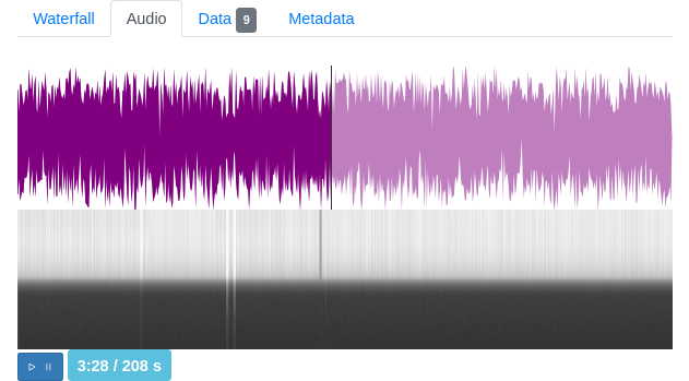

for solid proof this is the based:
run gr_satellites in listening mode:
gr_satellites CONNECTA-T1.2.yml --audio --samp_rate 48000
CONNECTA-T1.2.yml.txt (377 Bytes)
then reply the audio from this obs:
result:

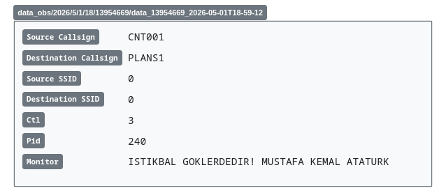

-> Packet from 4k8 GFSK downlink
Container:
    header = Container:
        addresses = ListContainer:
            Container:
                callsign = u'PLANS1' (total 6)
                ssid = Container:
                    ch = True
                    ssid = 0
                    extension = False
            Container:
                callsign = u'CNT001' (total 6)
                ssid = Container:
                    ch = False
                    ssid = 0
                    extension = True
        control = 0x03
        pid = 0xF0
    info = b'ISTIKBAL GOKLERDEDIR! MUSTAFA KEMAL ATATURK\x00' (total 44)
identic same result with satno web decoder:
