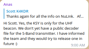

Not the reply that we would like to see ref. a KSY for the NuLink S-Band downlink, but I give them credit for answering the question.

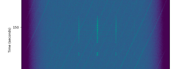

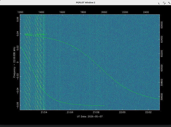

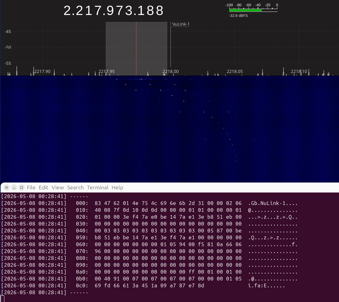

NuLink-2 observation https://network.satnogs.org/observations/14005735/ was EVER so close to having packets to decode, but I didn’t have any luck on replay. Just needed a bit more signal and a bit less noise.
I don’t know how long it will be before someone else puts up an S-Band satellite that transmits using a mode that we can decode, but I sure am glad I got to experience “normal” RX & decode on S-Band w/ these NuLink sats.

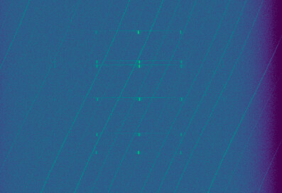

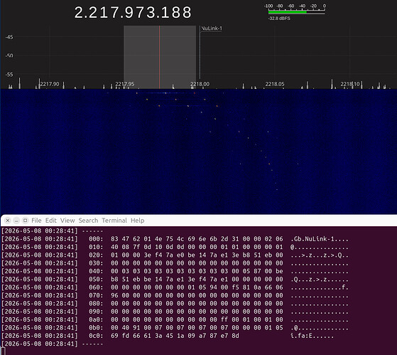

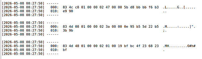

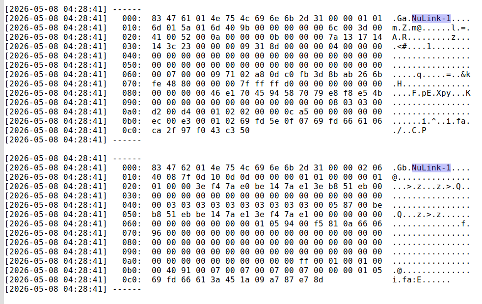

Tonight I went back to NuLink-1… only one packet strong enough to decode but each burst results in -2- frames:
From space-track.org analyst list, we have for NuLink-1 a match with object 88063 and the TLE changed to use the temporary NORAD ID:
NULINK-1
1 98322U          26127.89154852 +.00002157 +00000+0 +21581-3 0  0012
2 98322  97.7386  26.1005 0003363 102.6521 257.5074 14.92465676 00068

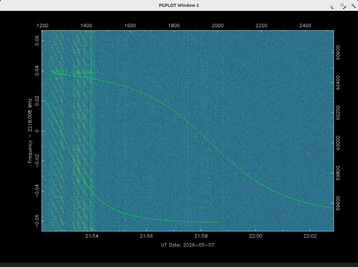

Observation https://network.satnogs.org/observations/14005791/ showed a different pattern of packets for NuLink-1… perhaps it was over the Team’s ground station.
… I was hoping for more decodes but again, it’s all about SNR & you can judge for yourself by looking at the waterfall.
However, a few decodes came out - much shorter frames that I’ve been getting from the 30-second beacons over the U.S.
**Note: timestamps are the time of replay - not the time of the observation

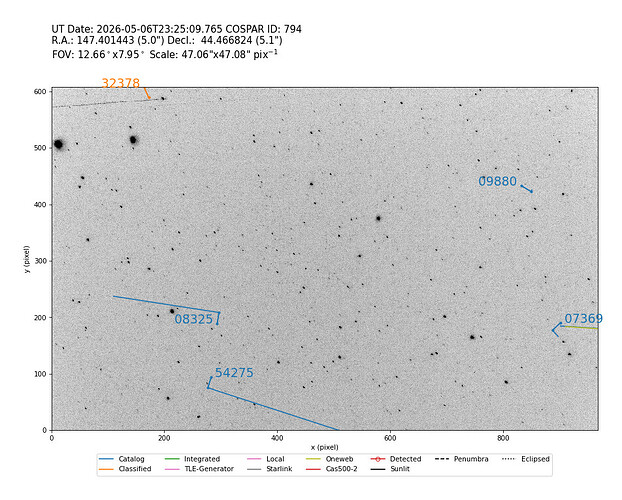

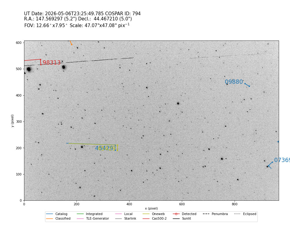

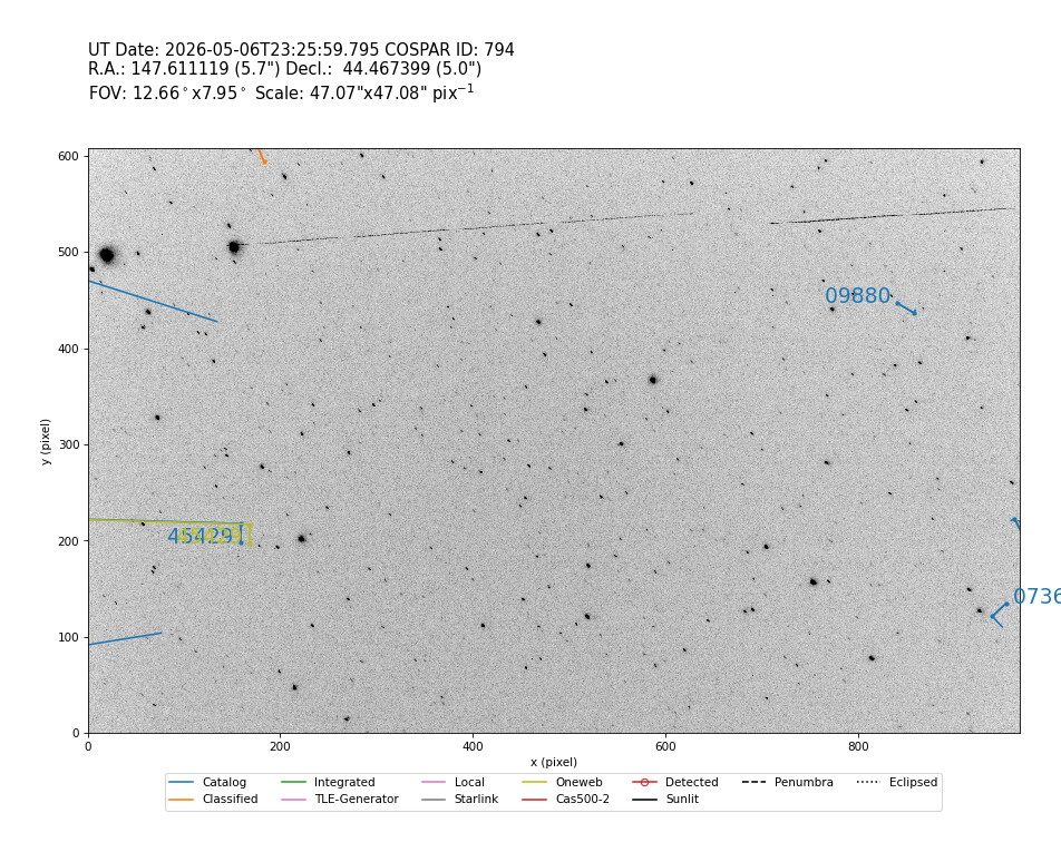

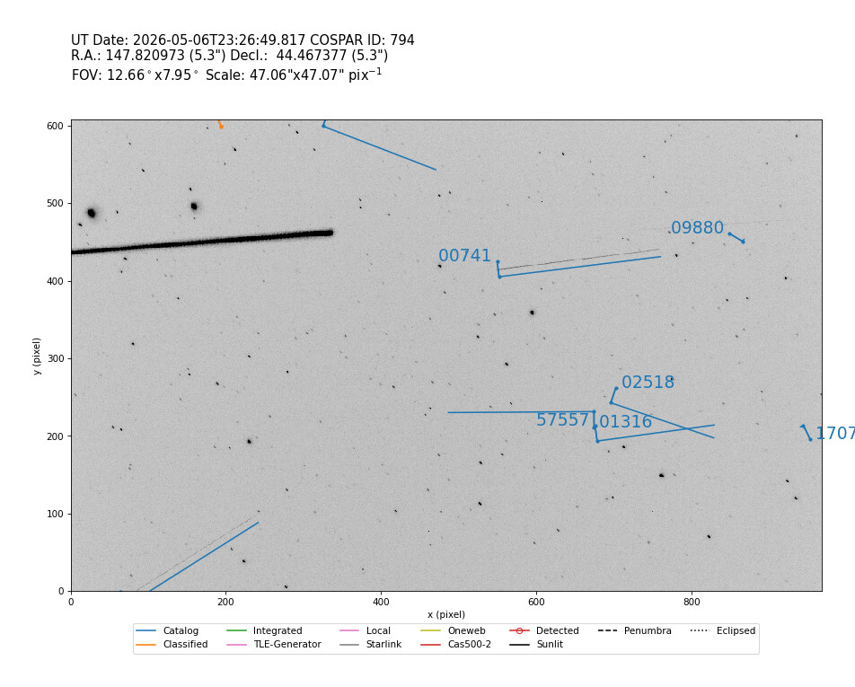

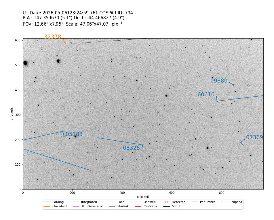

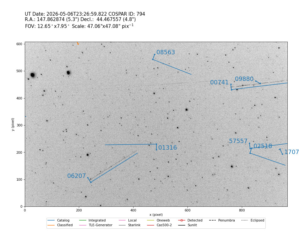

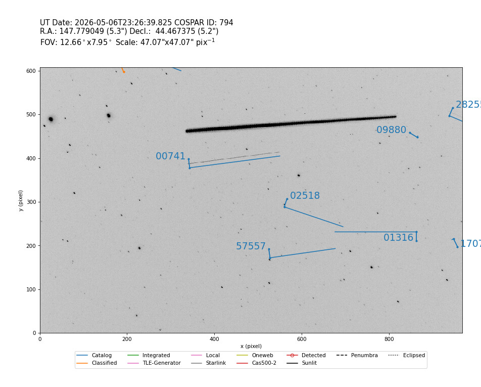

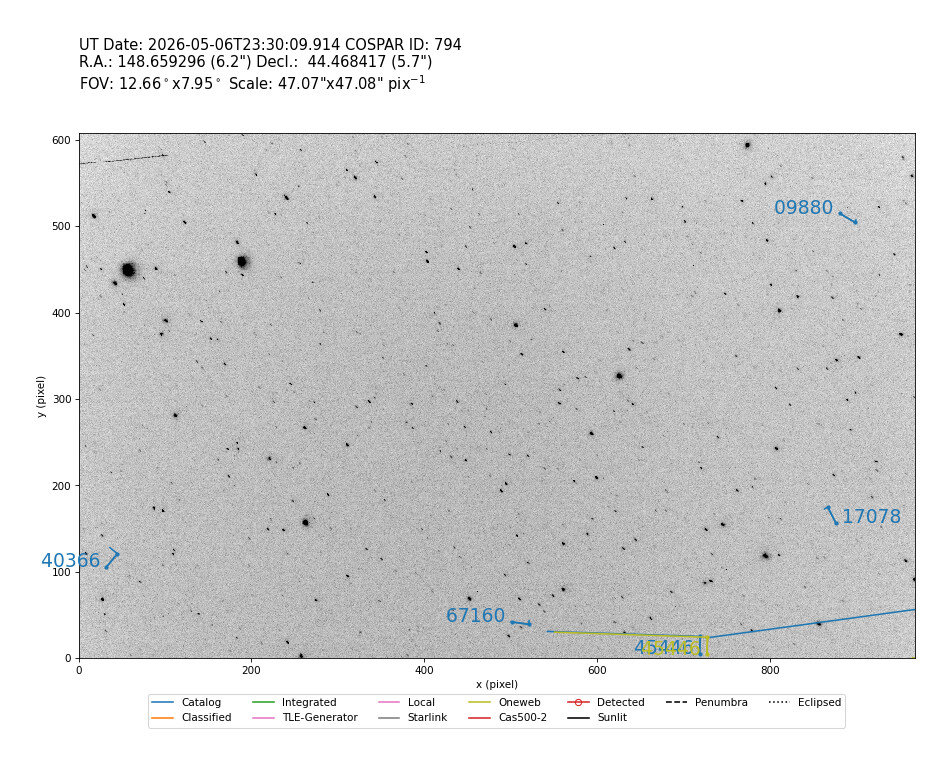

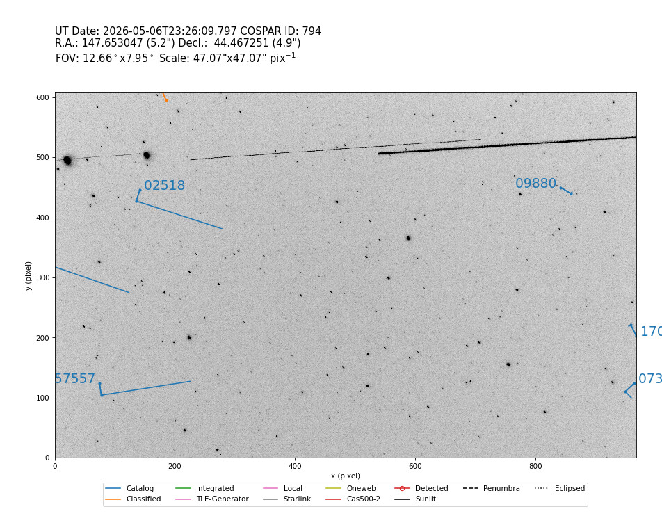

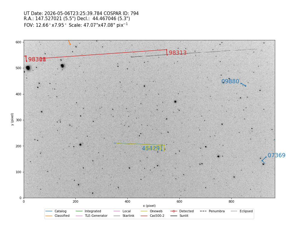

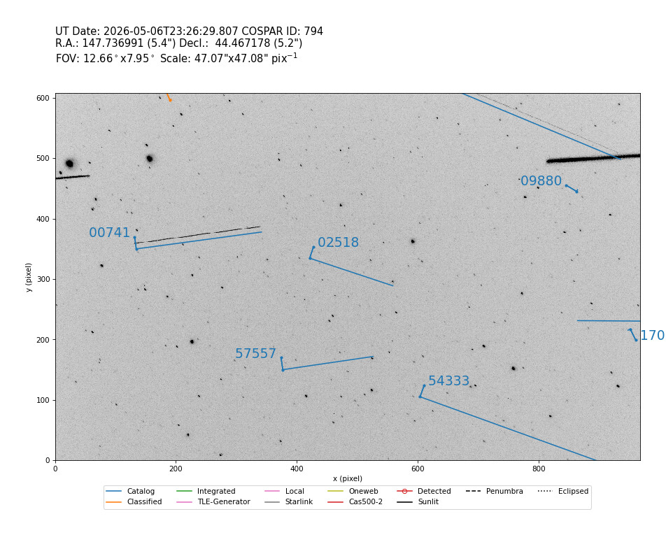

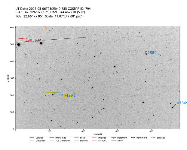

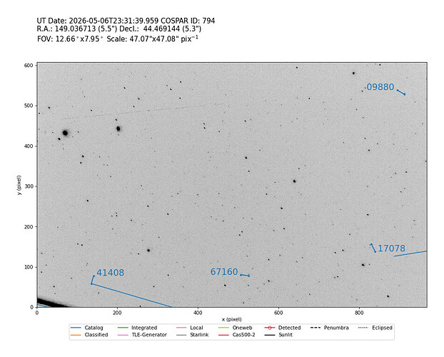

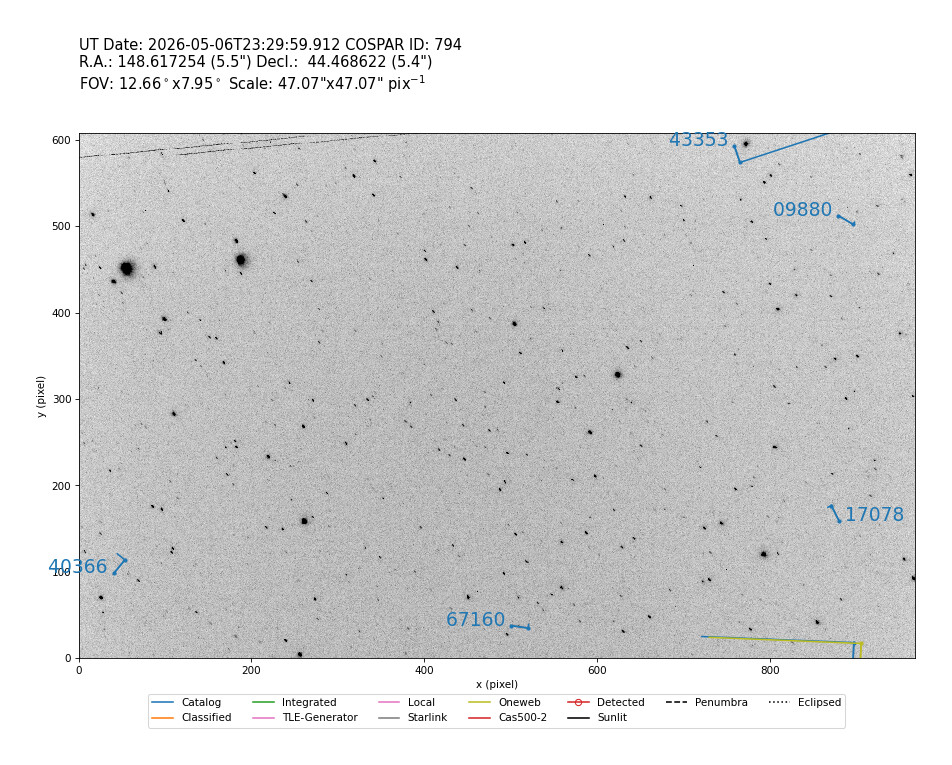

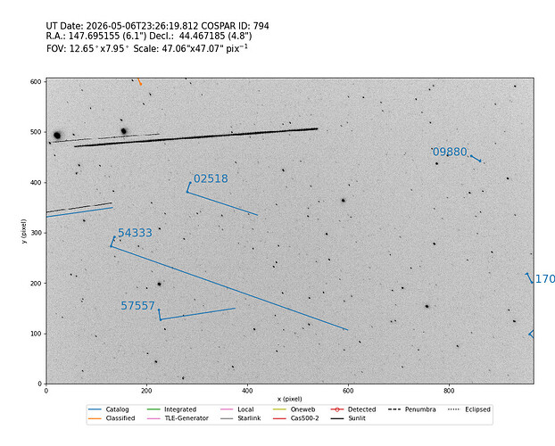

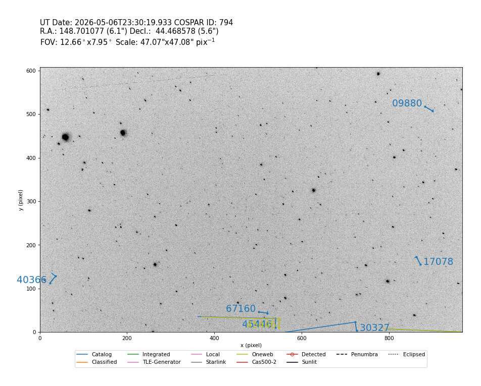

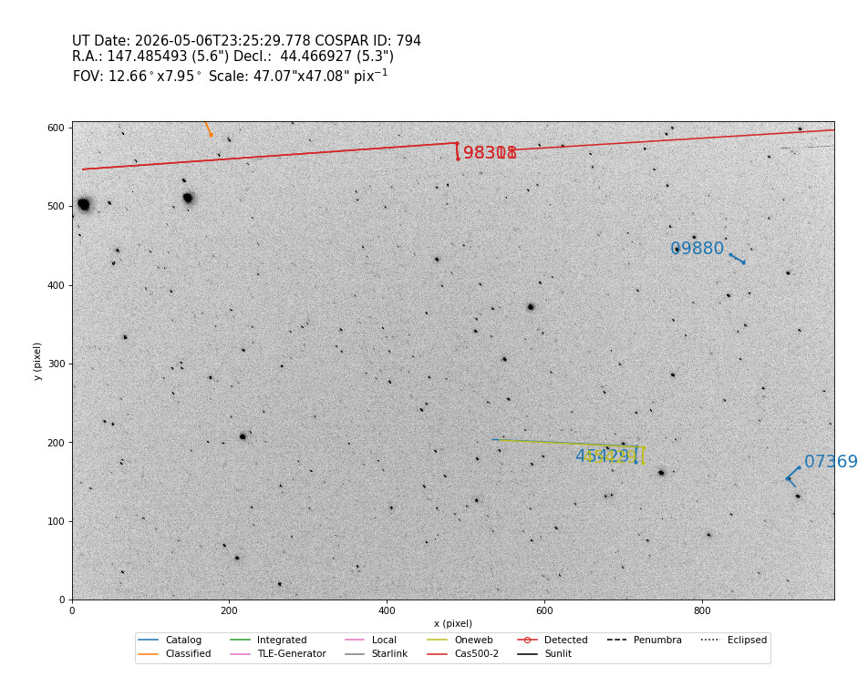

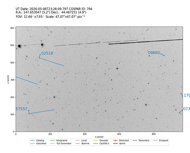

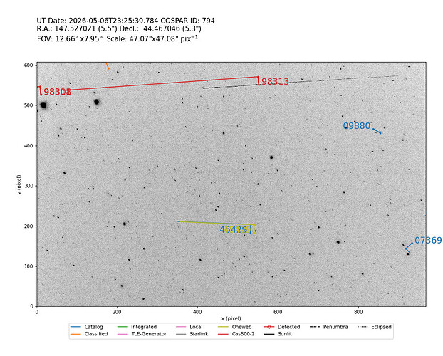

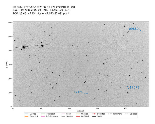

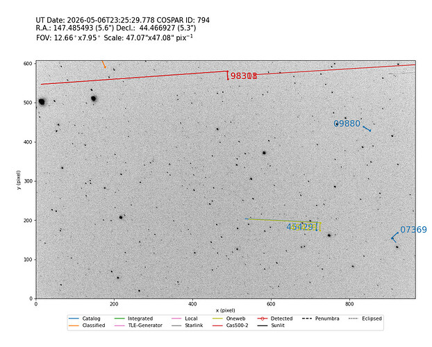

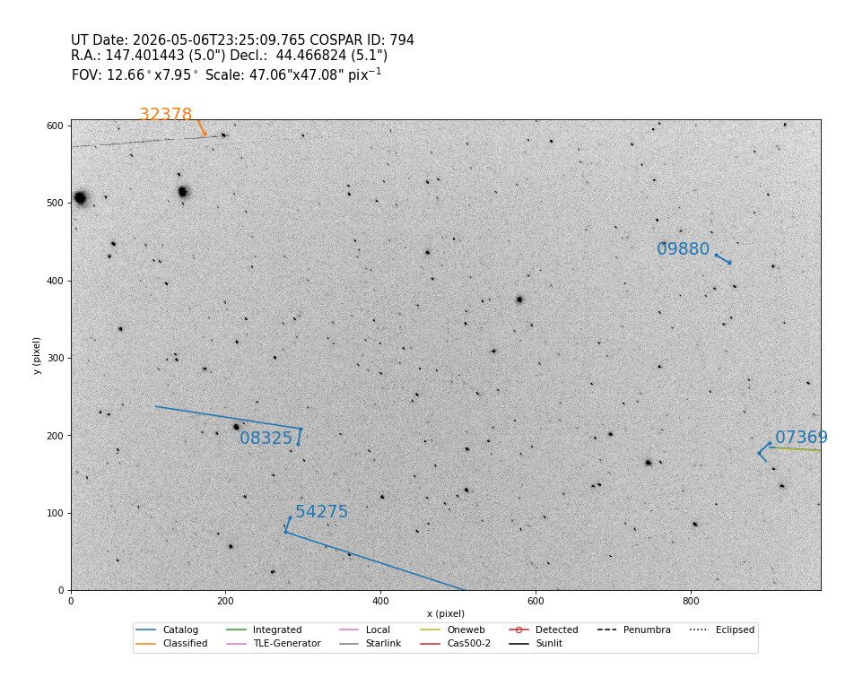

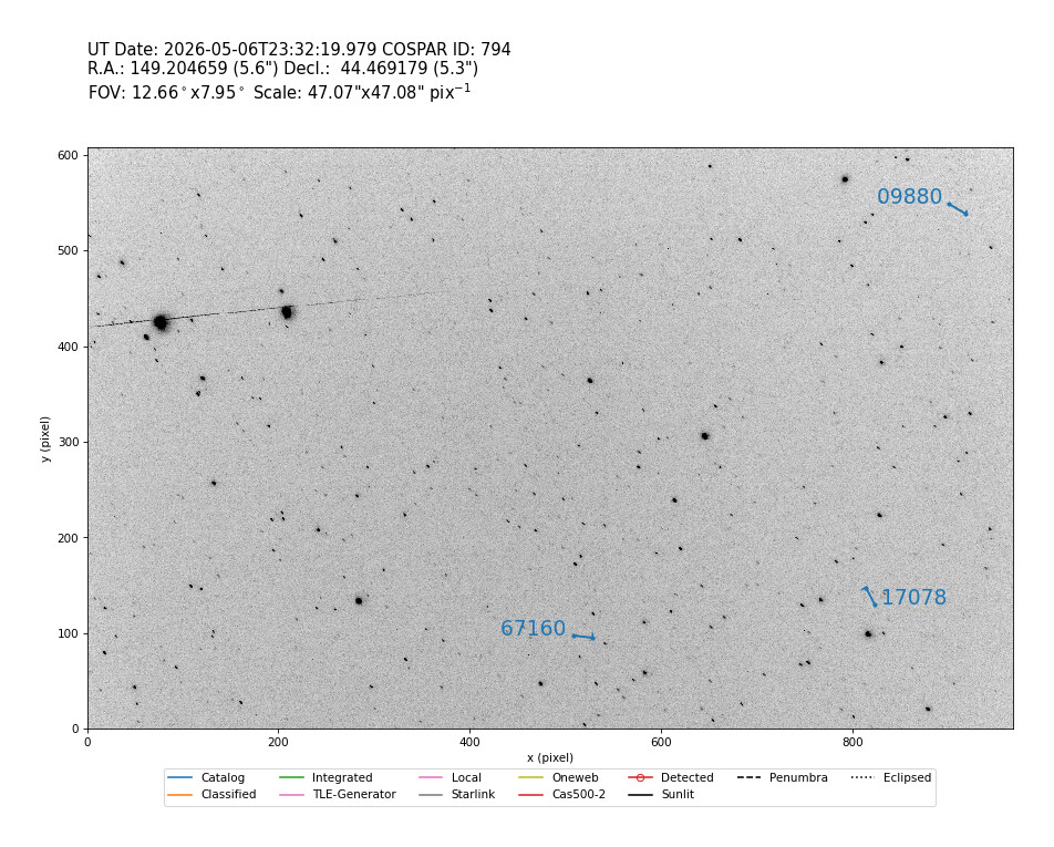

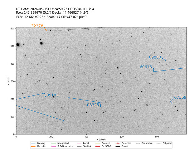

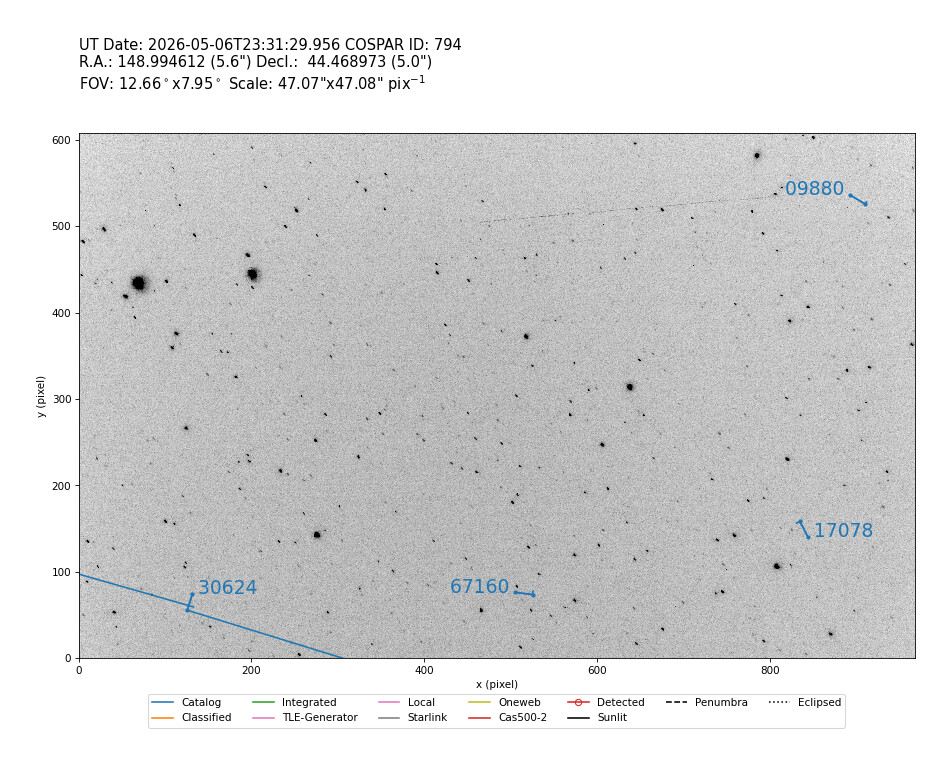

I happened to optically observe several satellites of this launch. I had listed all recent TLEs in this thread and added that as a TLE source to STVID. Such that the red L-Shaped overlays correspond to the TLEs found in this thread. The pictures have inverted black and white colors for better visibility. Here are the pictures.
It started with two faint ones in the top left:
The TLE of BRO-21 98311 and HYDRA-3 98308 was close:
Also Drishiti 98313 TLE is close to a visible sat:
Followed by a few fainter ones:

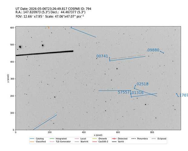

Next a bright satellite:
The bright one is being followed by a even brighter one:
Then a very faint one:

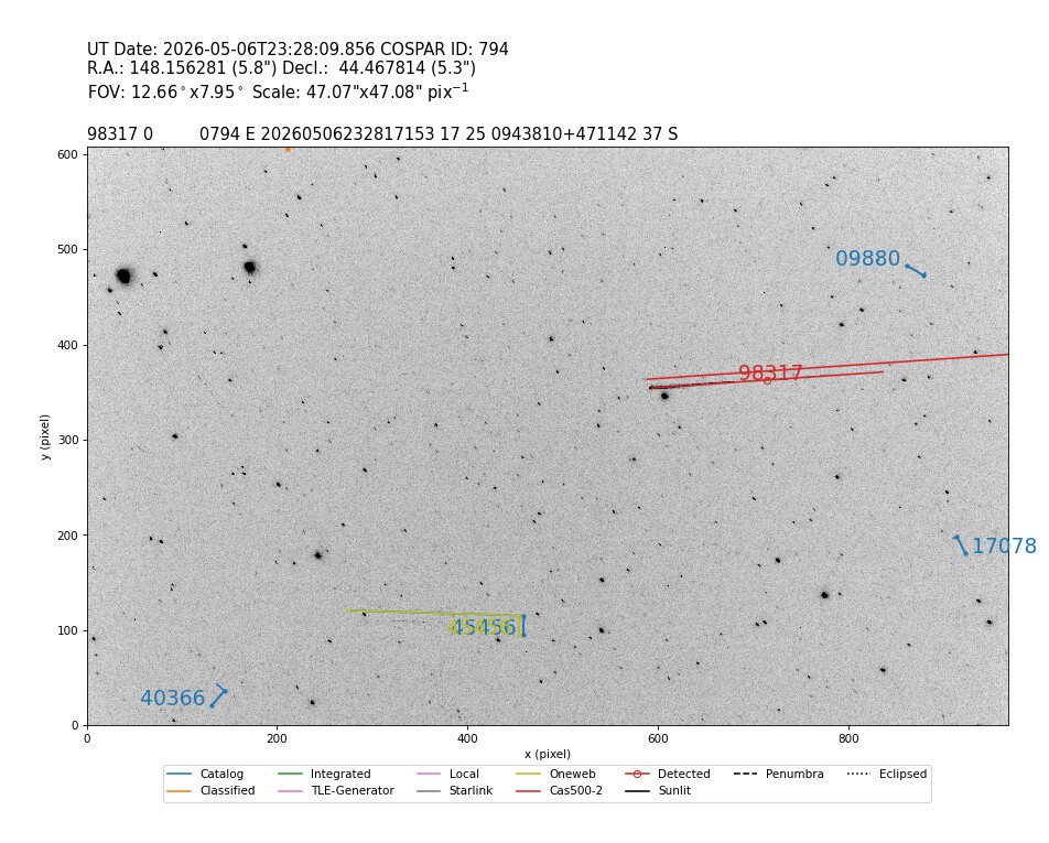

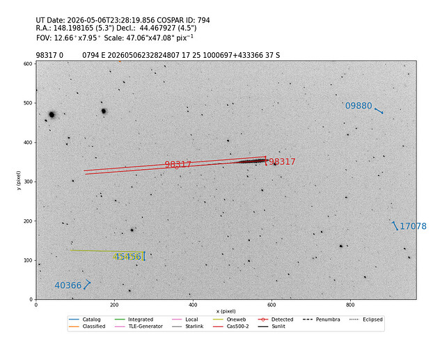

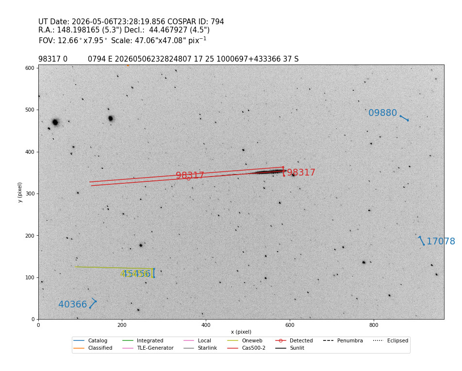

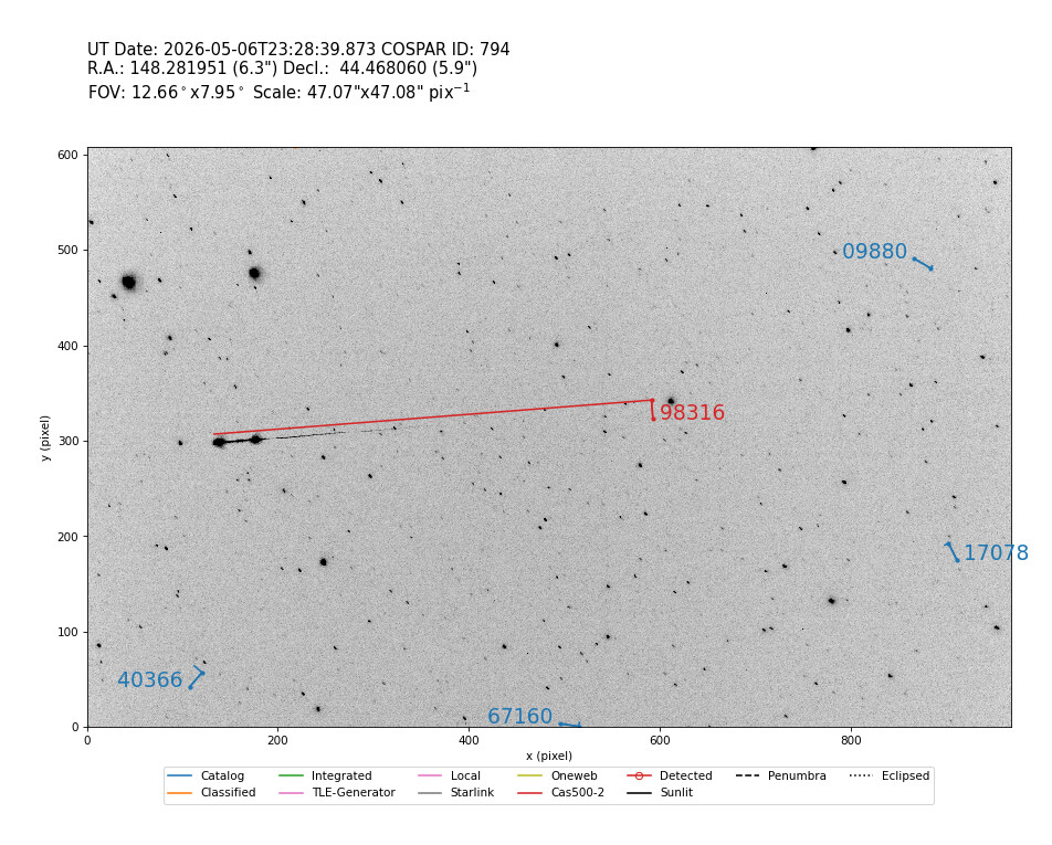

Next two pictures show HELIOS 98317 giving a nice bright flash! Is it tumbling slowly?

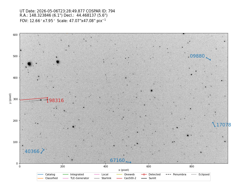

Next two pictures show SELENE 98316 gave 4 bright flashes, and must be tumbling fast!!

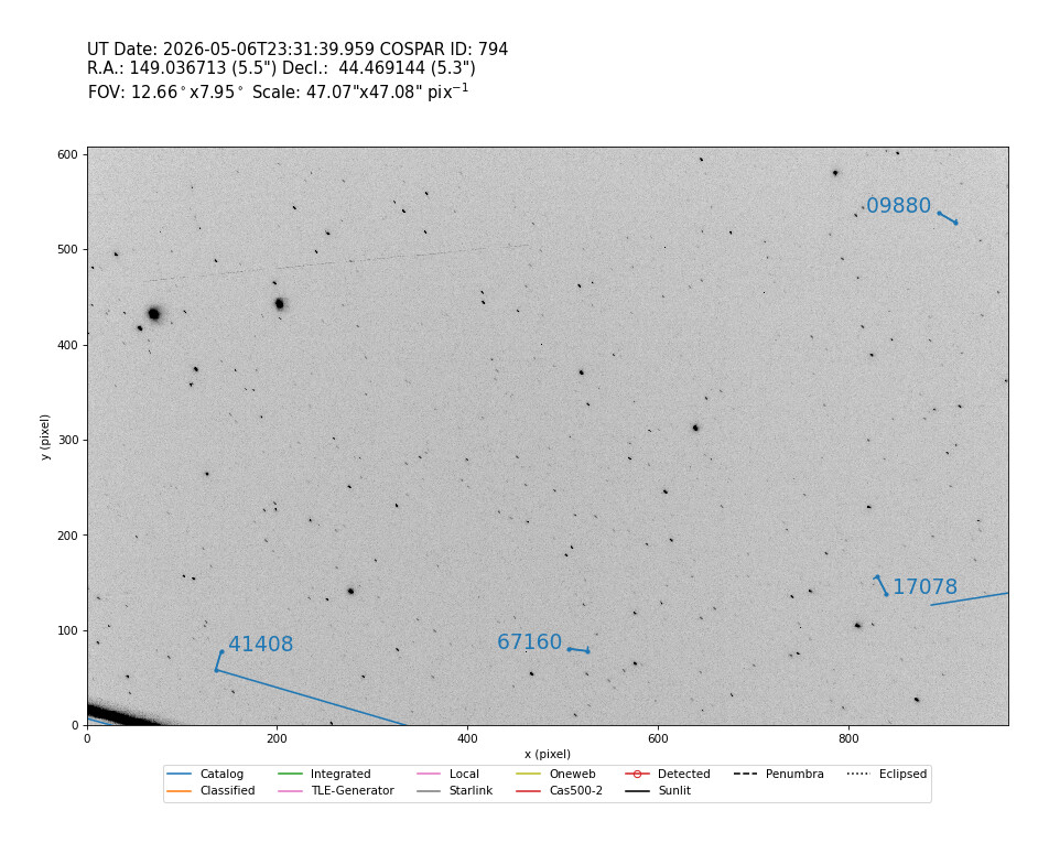

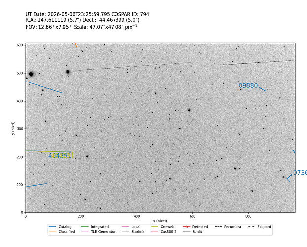

As the next one drift into view, this must be another (second) batch of satellites. All faint:
This shows that the optical observations can be a nice little extra besides the RF obs we are used to. It is possible to generate circular TLEs from these obs, that might be helpful in following them. Cheers!

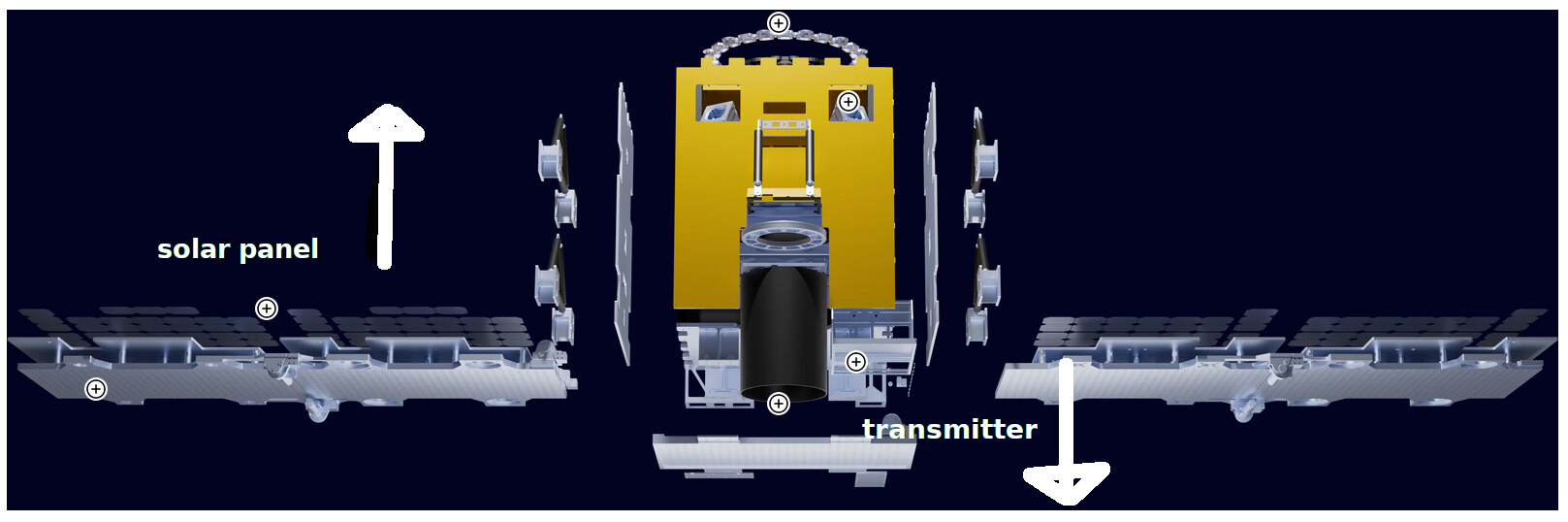

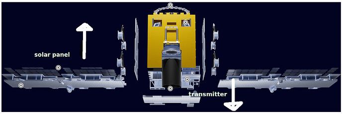

interesting. seen like slow tumbling?
observation around that time (2026-05-06 23:35 UTC)
faint signal. maybe caused by solar panel that toward to earth (we see bright line), and transmitter to space (faint signal received by earth)

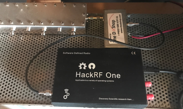

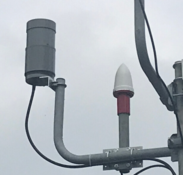

It’s not nearly strong enough to try to decode but Nulink-1 can be seen on the S-band helical setup :slight_smile:

I don’t think so. I see this pattern on a lot of satellites and it’s an artifact of the camera.
The images where taken and processed with STVID. See GitHub - cbassa/stvid: Satellite tracking with video cameras · GitHub
It detects the streaks and matches it to TLEs, when possible. If nothing matches it measures it as a unknown starting from 90000 for the first sat in a picture. Second sat gets 90001, etc. The counting restarts at each picture. Therefore a lot of 90000 and 90001 measurements and tles. The measurements are not (yet) supported on Satnogs and are reported at the seesat emailing list. See EV Obs 2026-05-06/07 from E. Visser via Seesat-l on 2026-05-08 (SeeSat-L May-26)
The measurements are in IOD format. See IOD Observation Format Description
From these measurements you can make a TLE using the satfit of sattools. See sattools/src at main · cbassa/sattools · GitHub
This is the complete ecosystem of software for optical observations.
There is a low priority Satnogs Optical project, that uses this software and attempts to build a network of cameras.

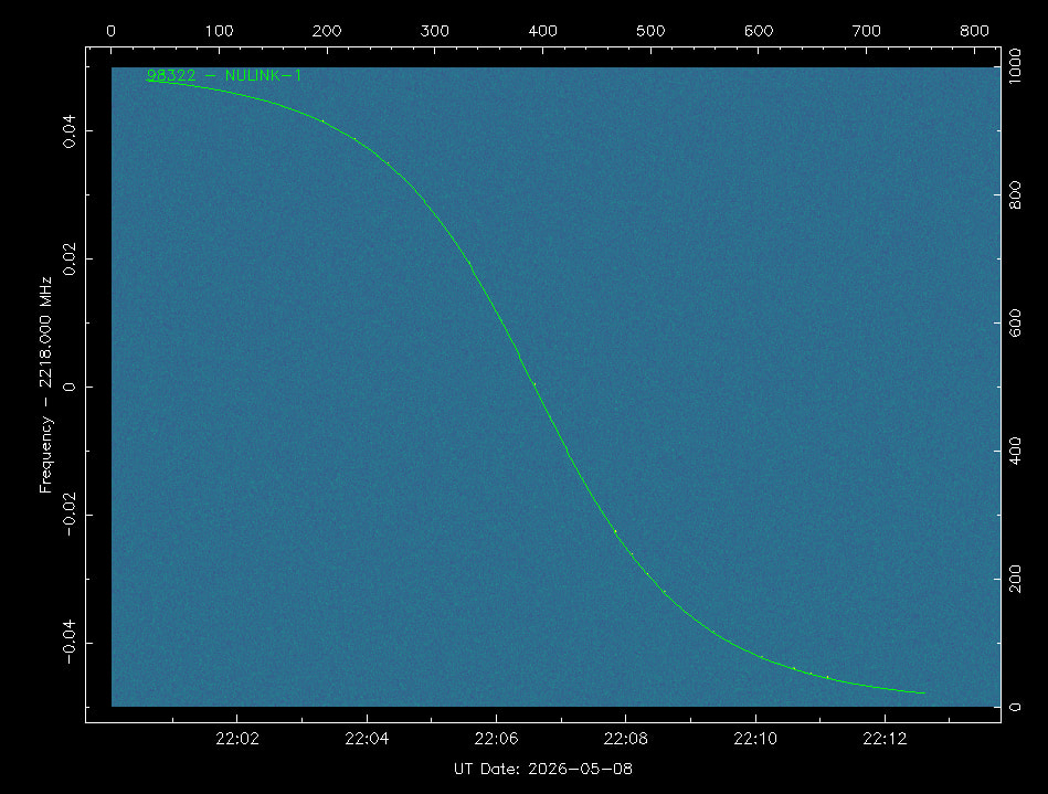

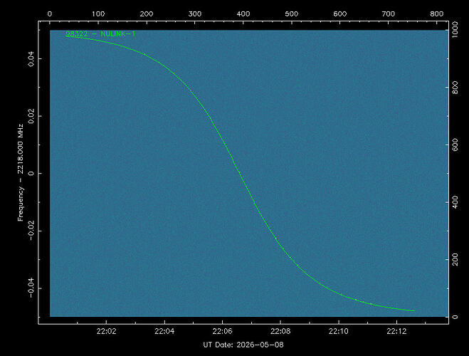

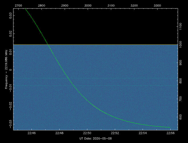

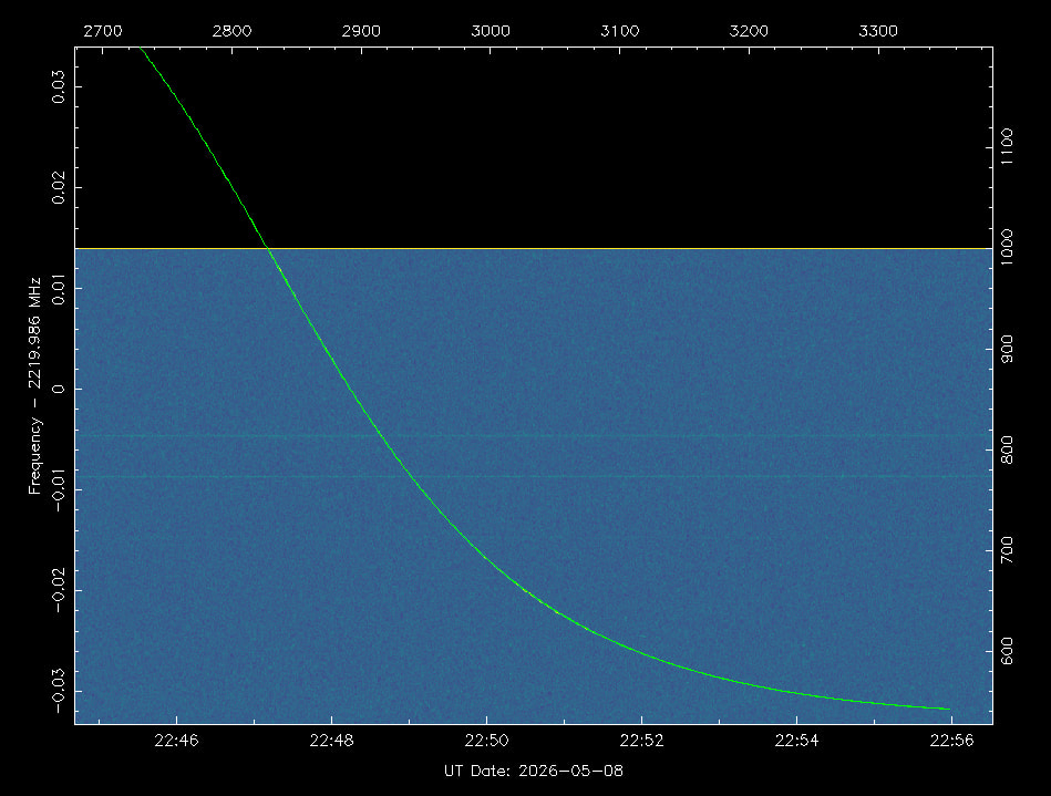

Because NULINK-2 2220 MHz is on the edge of my observation I can’t select the whole curve.

I can imagine the trill of being able to decode signals on S-band and was surprised that I could even receive the signals with my 5 turn RHCP Helix pointing at zenith.
