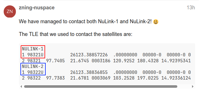

NULINK-1
1 98322U          26123.38857226  .00000000  00000-0  00000-0 0    02
2 98322  97.7405  21.6745 0003186 120.9252 180.4328 14.92395341    09
NULINK-2
1 98321U          26123.38836855  .00000000  00000-0  00000-0 0    06
2 98321  97.7383  21.6781 0003069 103.2528 197.0225 14.92336124    07
I’ve changed the TLE based on the first line, so I fixed the temporary NORAD ID in the TLE sets and fixed the checksum.

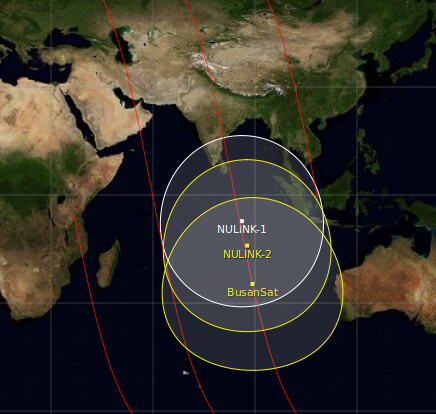

We just did a pass with NuLink-1 using the refined TLE from Fredy. This TLE is about 10s ahead of the NuLink-1 TLE. Could you attempt an observation using Fredy’s TLE for NuLink-1?
Will do - thanks.
So are you observing NuLink-2’s signals on 2220 MHz FIRST?
And then NuLink-1 after on 2218 MHz?
Sorry! I understand the misunderstanding now! My bad for assigning the wrong ID for the wrong satellites. I need to make a big mental note that:
NuLink-1 is 98322
NuLink-2 is 98321
:sweat_smile:
Right now we do one satellite per opportunity instead of one after another.
Thank you - yes, I found my problem as well.
The previous entry had them reversed, hence my tracking disaster.

Lest anyone be confused by my reference to this earlier post, please note the correct Object ID’s for these sats. Thank you!

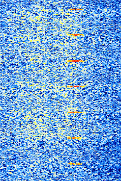

Here the Meteor LRPT IQ recording example.

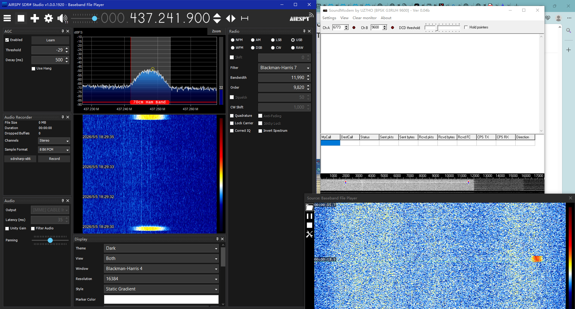

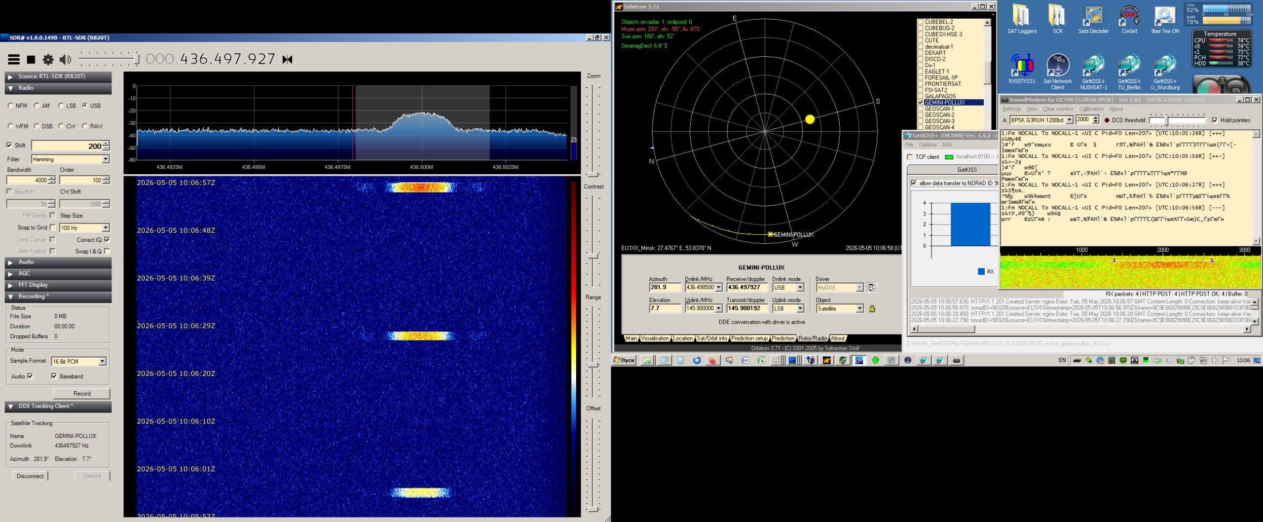

I Try decode me RX Gemini-Pollux
looks singal strong,but my soundmodem not decode,need help

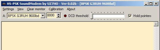

You need USB or LSB mode
and SoundModem for 1k2:
for 9k6:
Its not work…
