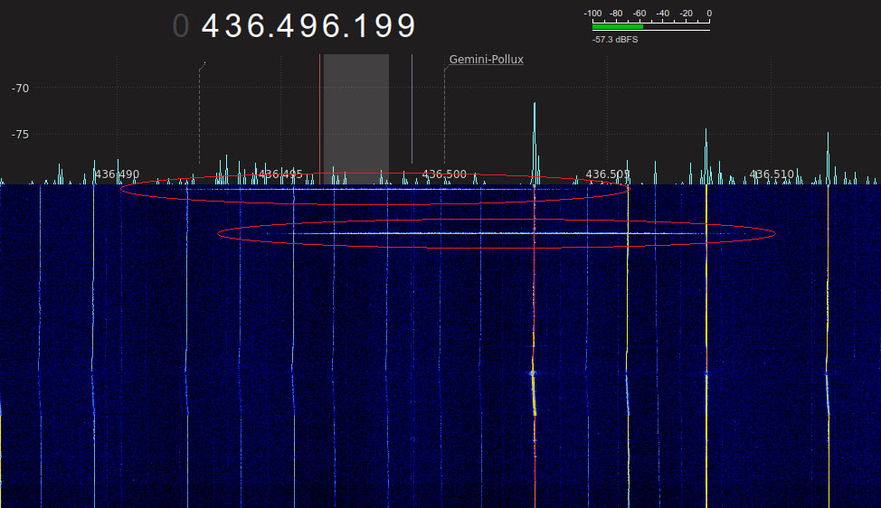

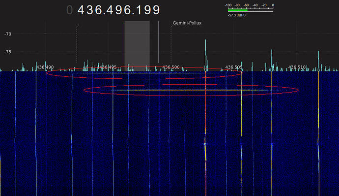

Since the last few SatNogs Observations for Gemini-Pollux clearly had 1k2 packets in the waterfall, that’s what I setup for on tonight’s pass.
So naturally when it did finally transmit, it was 9k6!

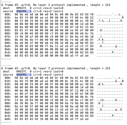

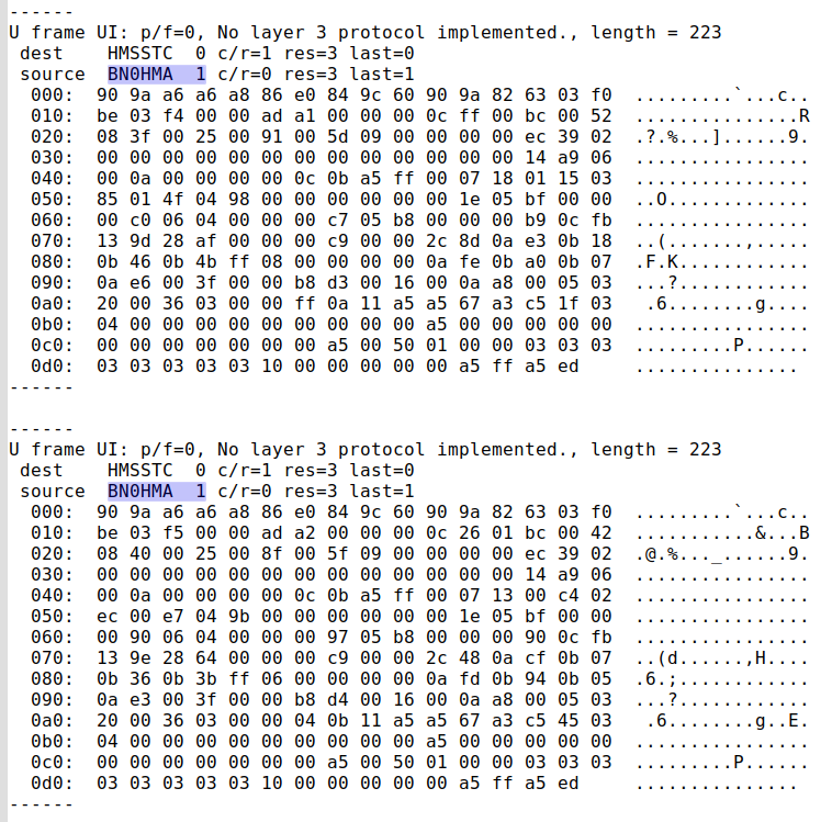

… but, that’s ok - that is what I/Q replay is for. Using GNU-Radio + gr-satellites for the 9k6 BPSK AX.25 decode -and- upload to SatNogs, each of the frames was uploaded w/ its correct timestamp.
