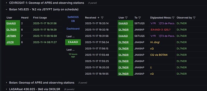

I’ve updated the NoradID of BOTAN in the Digipeater Dashboard.
BOTAN is acting as a digipeater and transmitting the received packets 3 times. See Observation #12713404 at 7J1AJH.
Thanks for pointing this out.
That’s a really strange behaviour.
Those additional packets are/were not displayed because the query of the dashboard’s panel says ‘show me packets where the source callsign is not JS1YPT’.
I’ve changed the query to also display those packets and the result is this:
The red marked text is not displayed because it was sent at the same second from and to the same callsigns. In this case Grafana only displays the last packet (here: ‘h’).
If it’s ok for you all, I’ll keep the usual query which is not displaying packets from JS1YPT to keep the panel clear.
Anyway, I don’t understand the sense of this behaviour and why ‘h’.

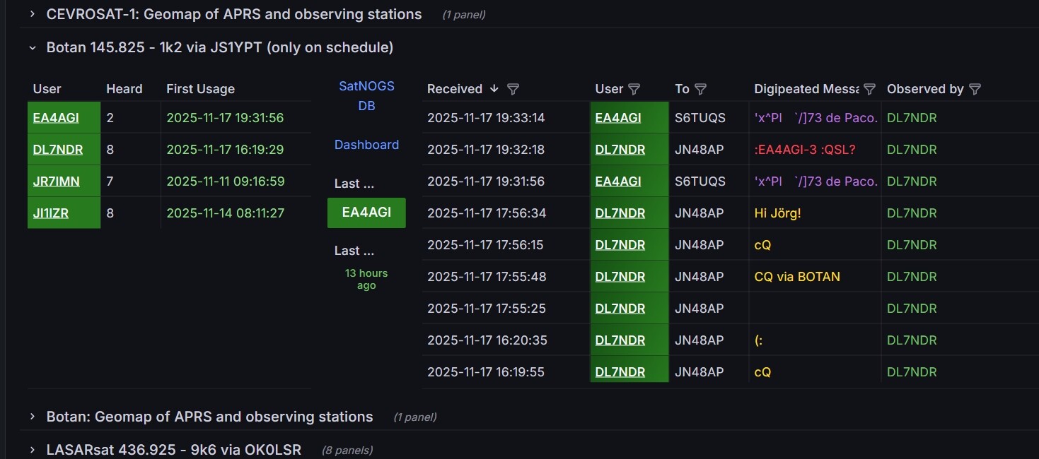

Thanks for update Daniel (@DL7NDR).
Looking at UISS log I received a couple more packets. The first from JS1YPT To APTT4 Via WIDE1-1,WIDE2-1 at 19:30:45. However I got a warning from my firewall and had to allow getkissplus access so maybe the first submission failed - good to know other uploads worked. Unfortunately I don’t see anything on the dashboard - am I looking at the right thing? I expect to see my callsign at least as an observer of a digipeated message. Where can I check my upload is received? Also I don’t appear on the geomap of receivers.

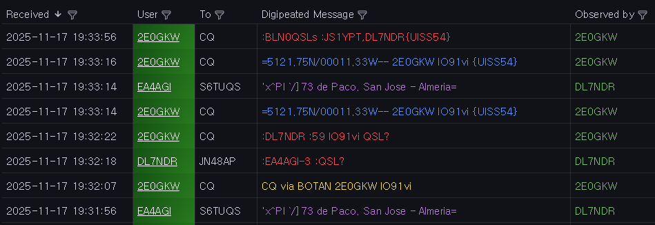

This is the explanation why your callsign doesn’t appear on the dashboard.
Your SoundModem decoded your own uploads and GetKISS+ uploaded it to SatNOGS.
However, as you figured out by yourself, you were never heard by BOTAN.
This is a disadvantage of GetKISS+. It uploads everything, even non AX.25 packets.
To only upload digipeated packets or those from BOTAN, try my gr_satellites uploader.
The dashboard checks for the so called h bit. If it is set (h bit = 1), then your packet was digipeated and will be displayed. All five of your packets has h bit = 0, so the dashboard won’t show them.
I’ve removed the h bit check to be able to take this screenshot.
Interestingly, you’ve uploaded only transmitted no received packets.
