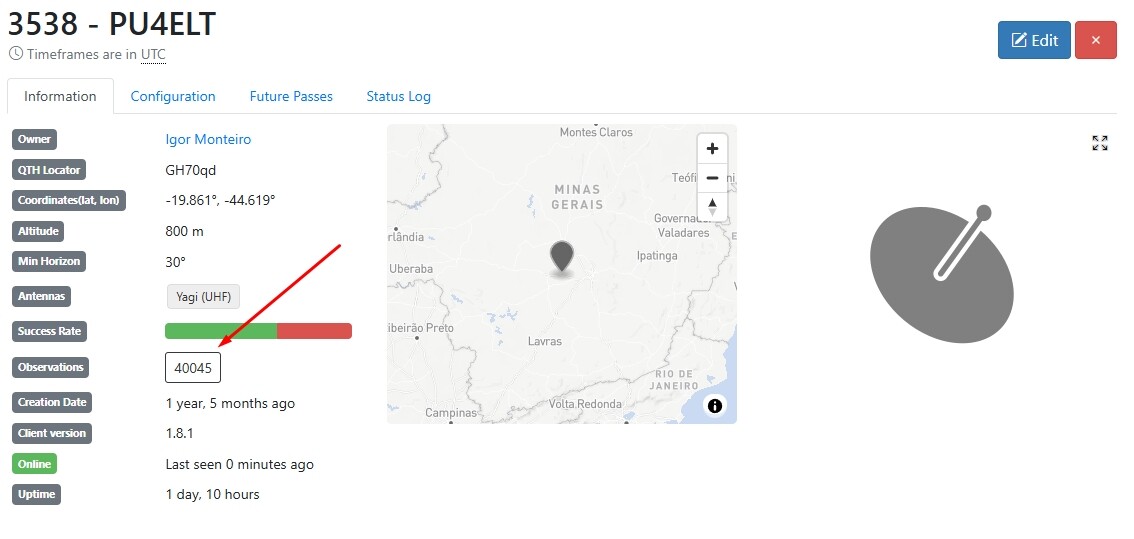

Well. Today I reached the milestone of over 40,000 observations made at my SatNOGS 3538 station
Not bad, despite the poor reception.
from dumb to hero
