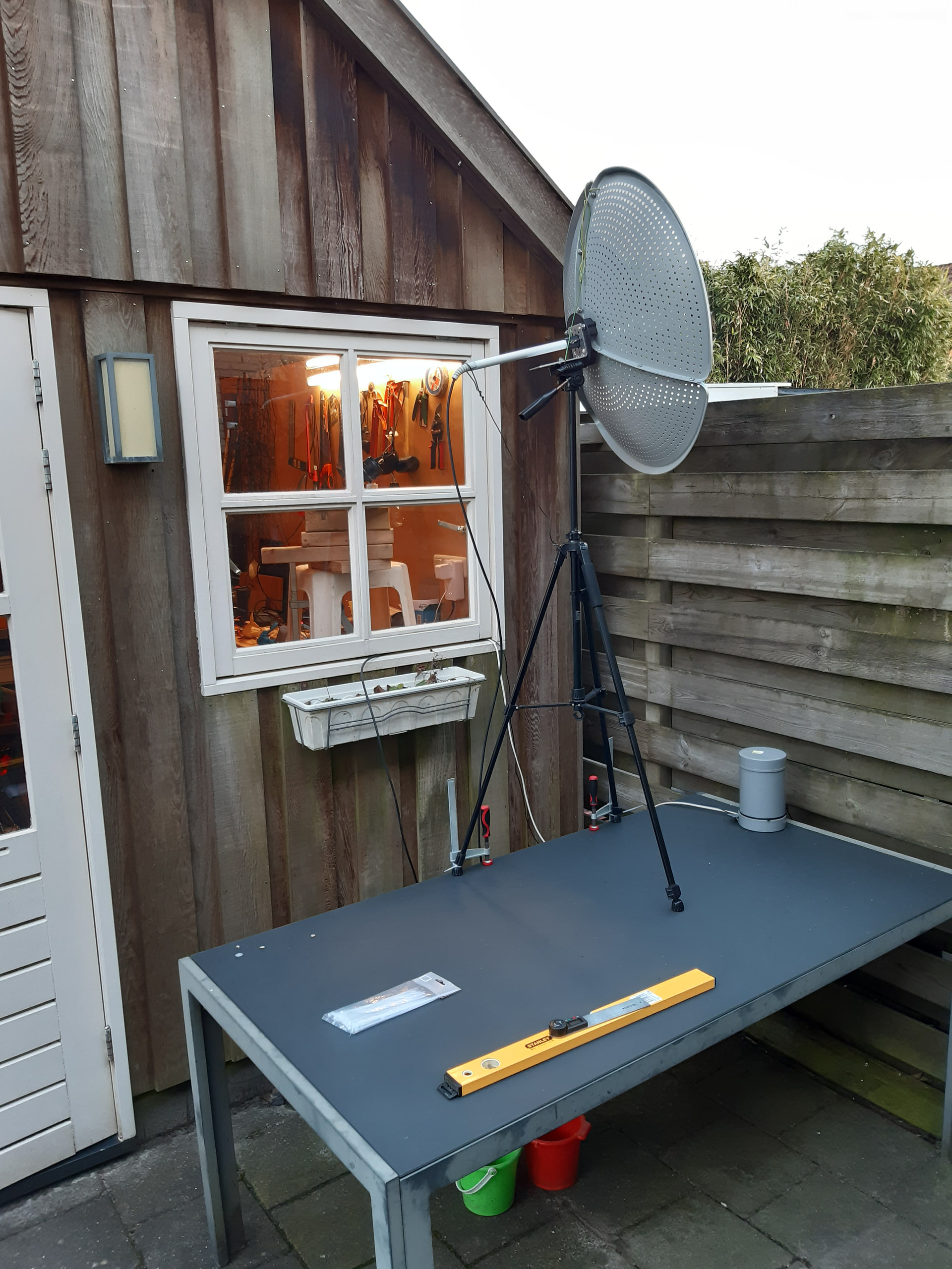

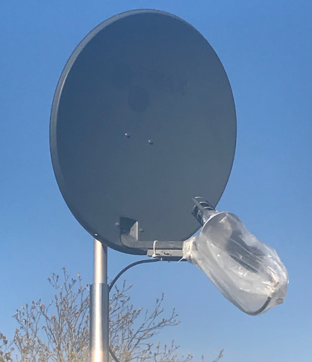

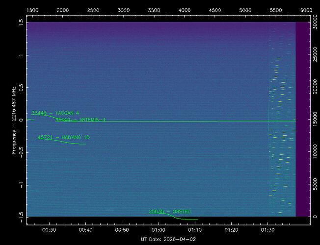

Thanks for all the information, this afternoon installed the 60cm offset dish.
Fixed position 195 Azimuth and 8 Elevation.
RF Chain:
5 turn LHCP Helix → Osmocom S-band bandpass → NooElec wideband LNA → 4 meter Aircell 7 → BiasT → USRP B200 mini.

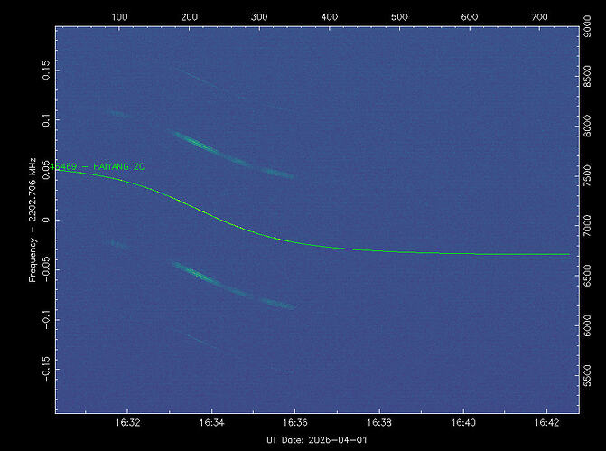

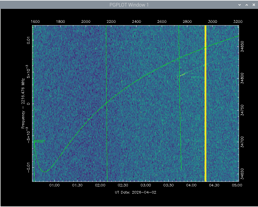

Running a STRF obs to see if we are receiving satellites around 2210 MHz at 16 msps, and as you can see all looking ok.
Now we only need to wait for the Artemis II launch and see if we can receive some signals.

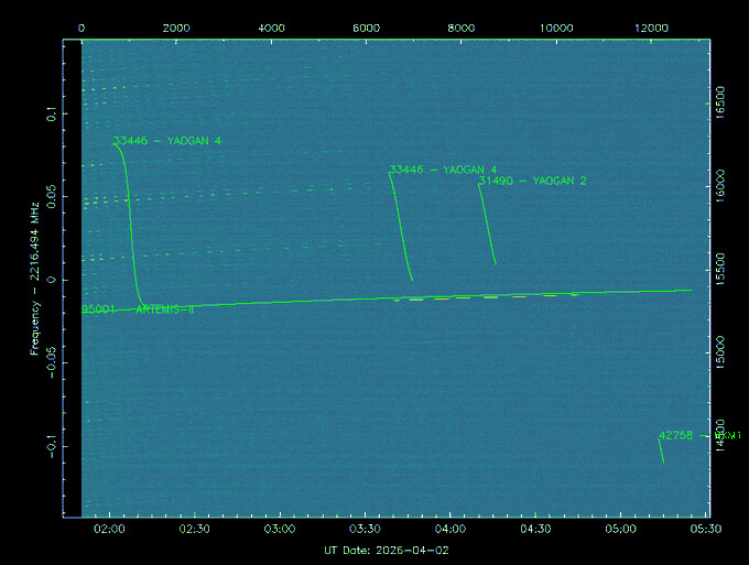

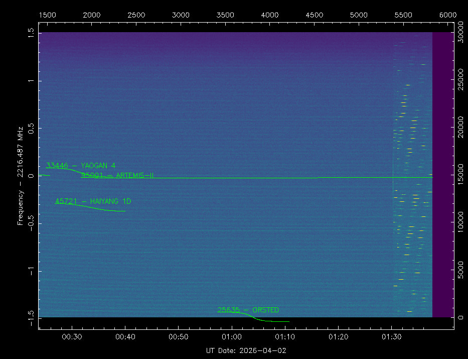

Spotted some signals, should be working.
Should be ready to track assume the TLE posted is somewhat accurate.
Big signal visible, that started around 01:30 on the 60cm

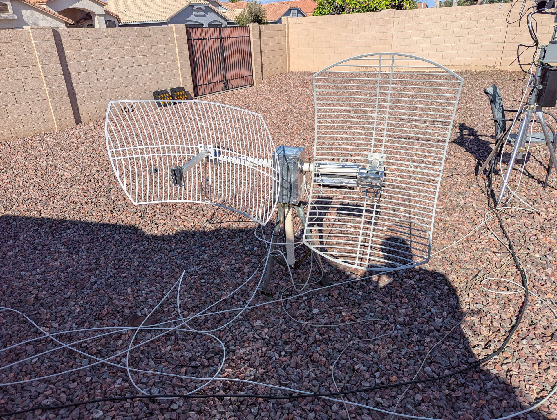

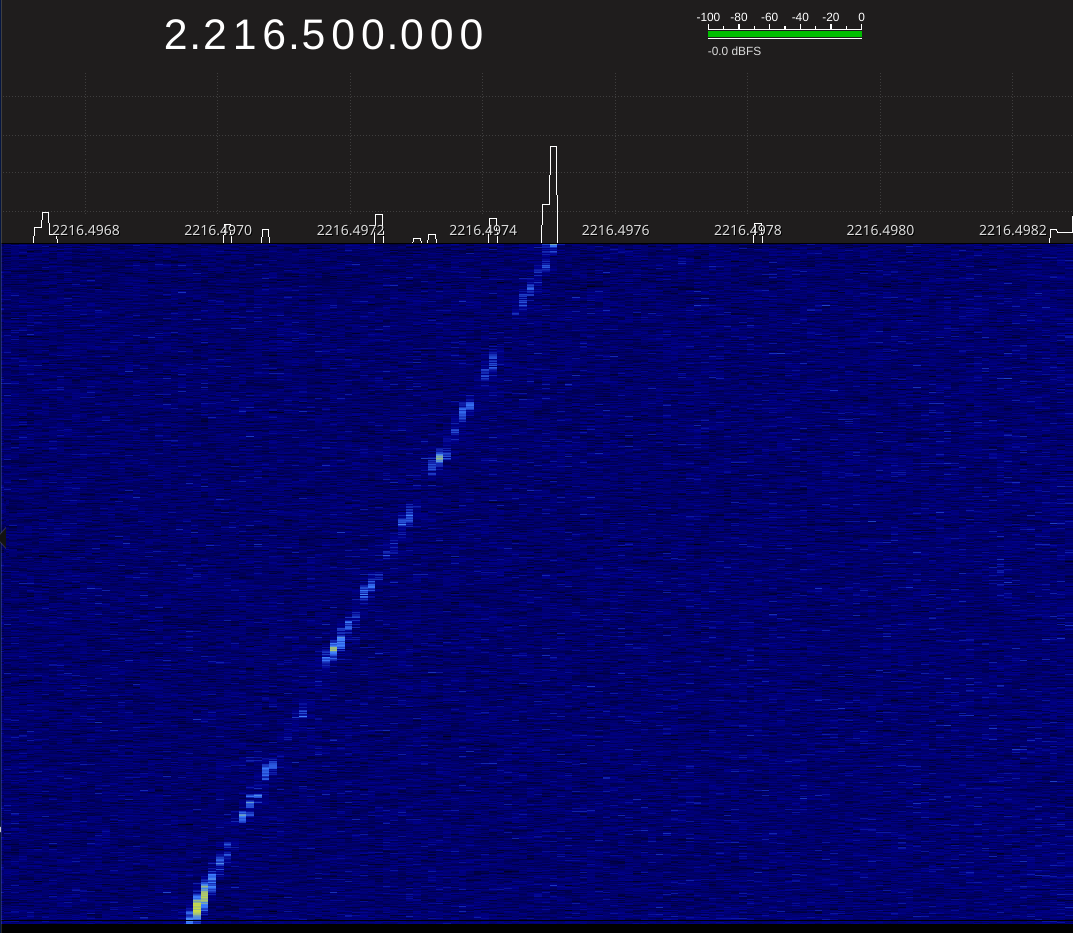

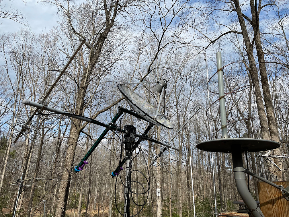

Really as a joke, thought I would look for the Artemis-II S-Band downlink while they were still this close to Earth. I certainly didn’t expect to see anything here surrounded by trees with an elevation under 20°.
But, just like Artemis-I… there it was! I do get a kick out of watching the doppler prove that you’re not just looking at noise!
https://x.com/scott23192/status/2039651622289014795
(1-meter RF HamDesign mesh dish kit)
Well done Scott, I was already wondering if you would give it a try with your far better setup then mine.

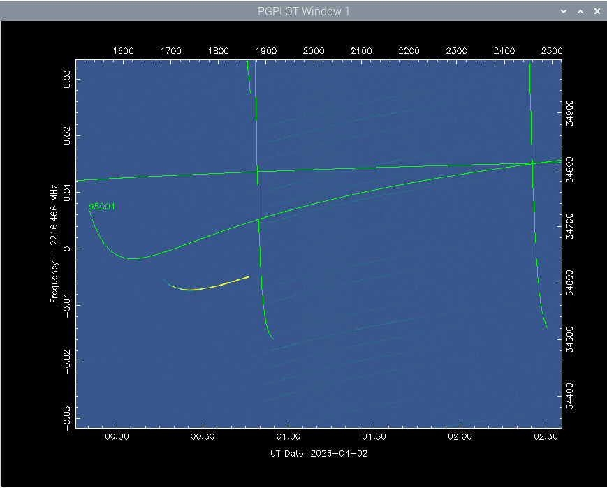

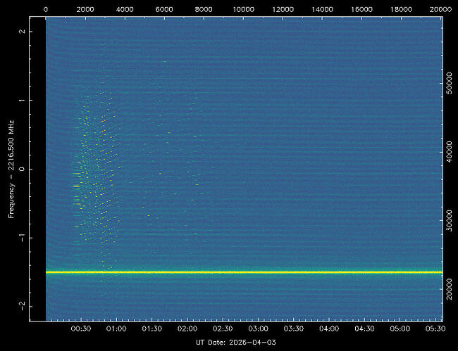

My final result from last night.

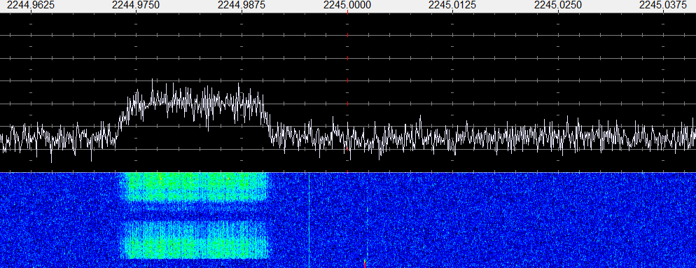

I found this, probably TACHELES, received by Nils from Von Storch Engineering.
Different data rates

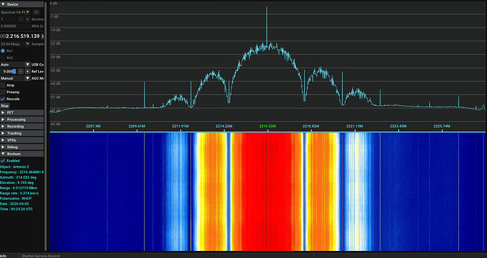

We had strong signals in Bochum over the whole night and nice Doppler Measurements.
I have sligtly less signal then Bochum @db2os using the 0.7m Discovery Dish, but the carrier is visible!

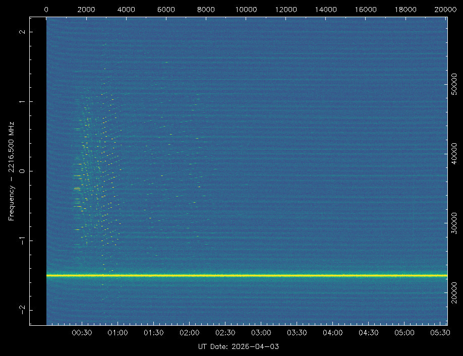

Nice signals of Artemis II last night.

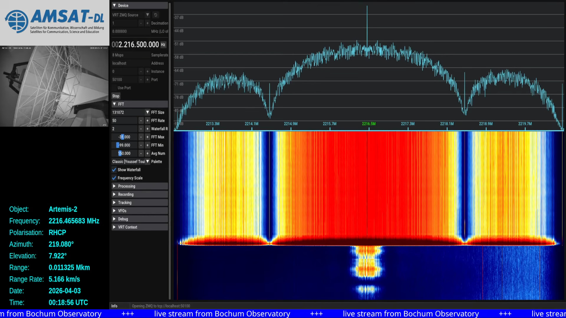

Again we had perfect signals, tracking and measurements with the 20m Bochum dish last night.

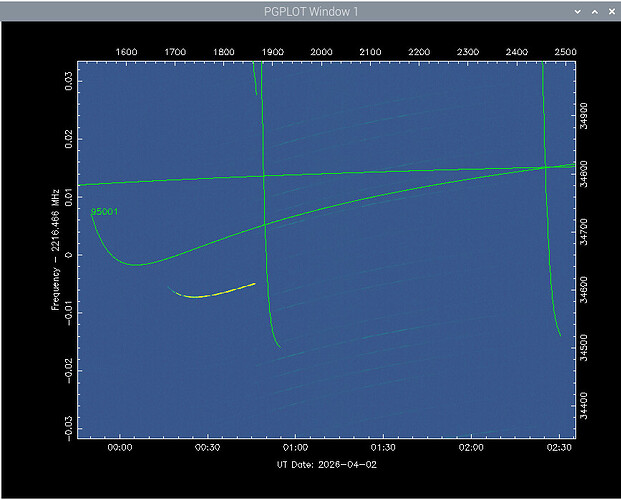

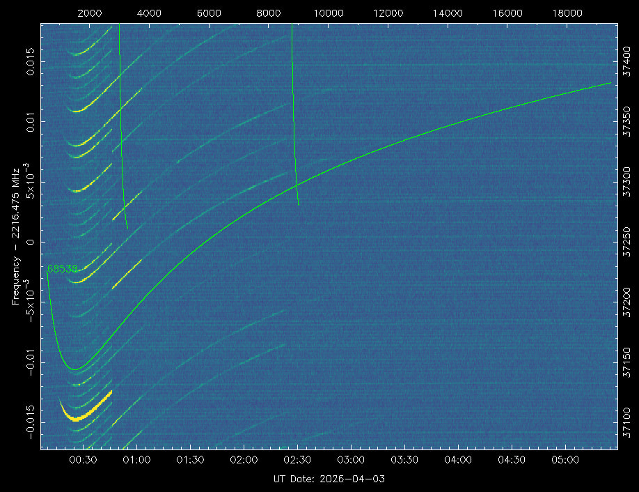

Artemis-II / Orion: Doppler measured versus predicted from last nights pass. The noise on the left side is at AOS. Everything going very well obviously..

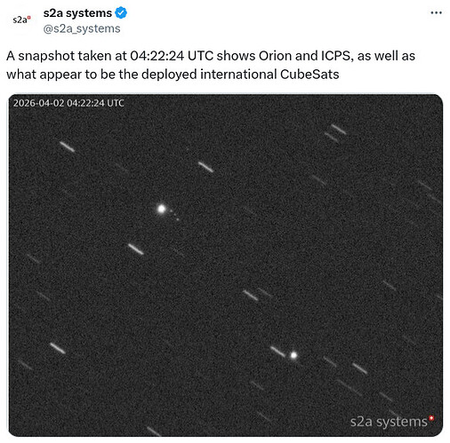

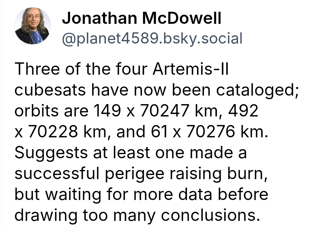

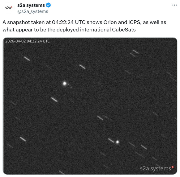

There seems to be no info around; Does anyone have information about the fate of those CubeSat’s launched with ARTEMIS-2? Did they made it to escape from burning-up in the perigee? At least some of them have propulsion and cold gas thrusters for attitude control. But time to do all the required maneuvers may have been very short.
Someone supposedly got optical confirmation of release.

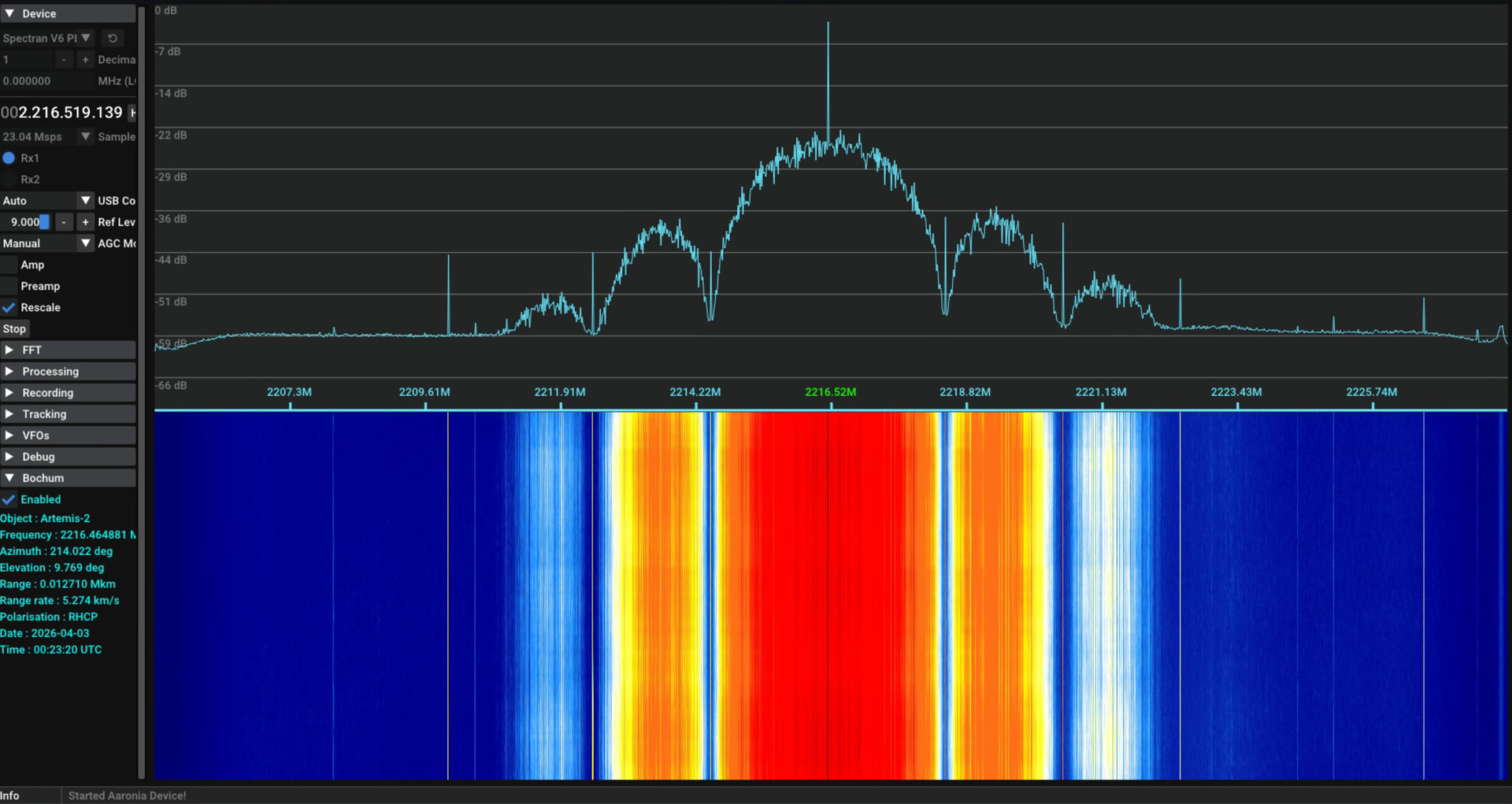

Last nights Artemis II reception.
The full wide band signal:
Zoomed in:
Pretty amazing with this small setup.
The coming night will be be more of a challenge with this fixed setup, the Azimuth will change from 139 to 220.
