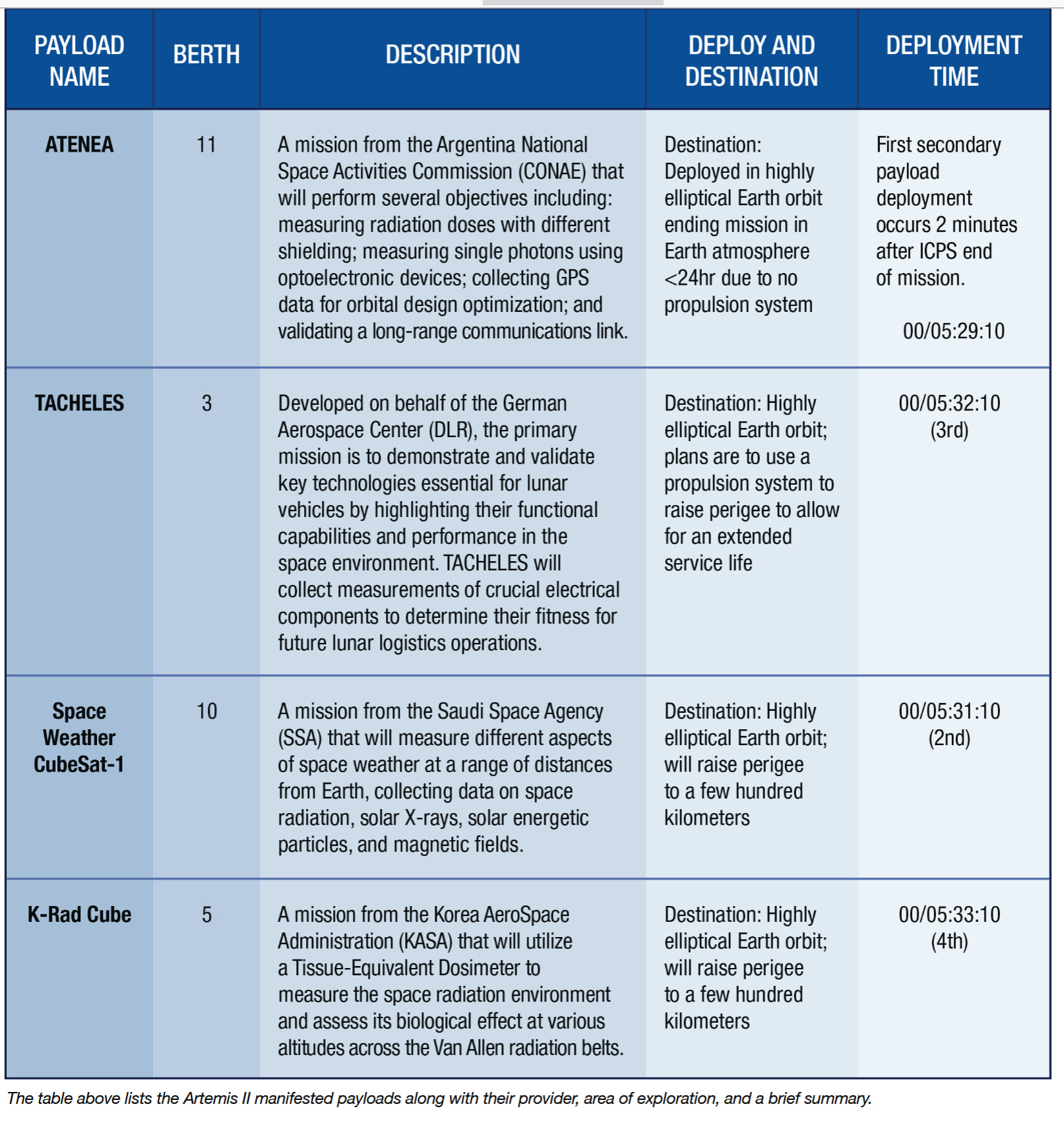

There will be 4 CubeSat’s on the upcoming Artemis II launch:
They will be injected into an 185 x 74.080 km HEO orbit and need to raise perigee with an propulsion system, otherwise they will re-enter and burn-up.
All of the CubeSat’s on Artemis II will only operate in S-Band:
TECHELES:
ATENEA:
SWC-1
K-RADCUBE

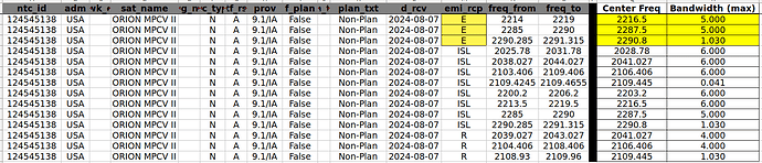

Thanks for the link @elly
It shows among others a frequency band of 2214 to 2219 Mhz. The centre is 2216.5 Mhz, just as Artemis 1 used.
Yes - thanks for the reminder to check ITU. Only -3- freqs listed in the ‘emitter’ category:

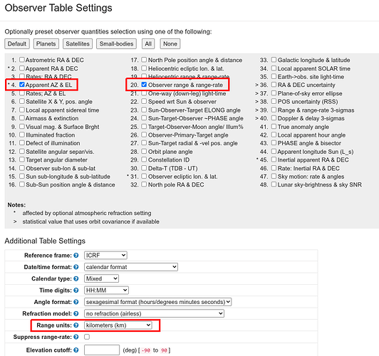

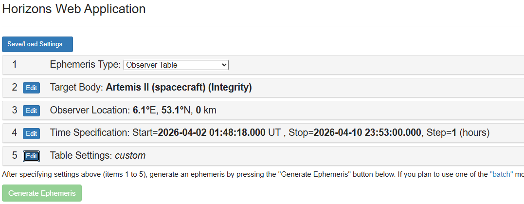

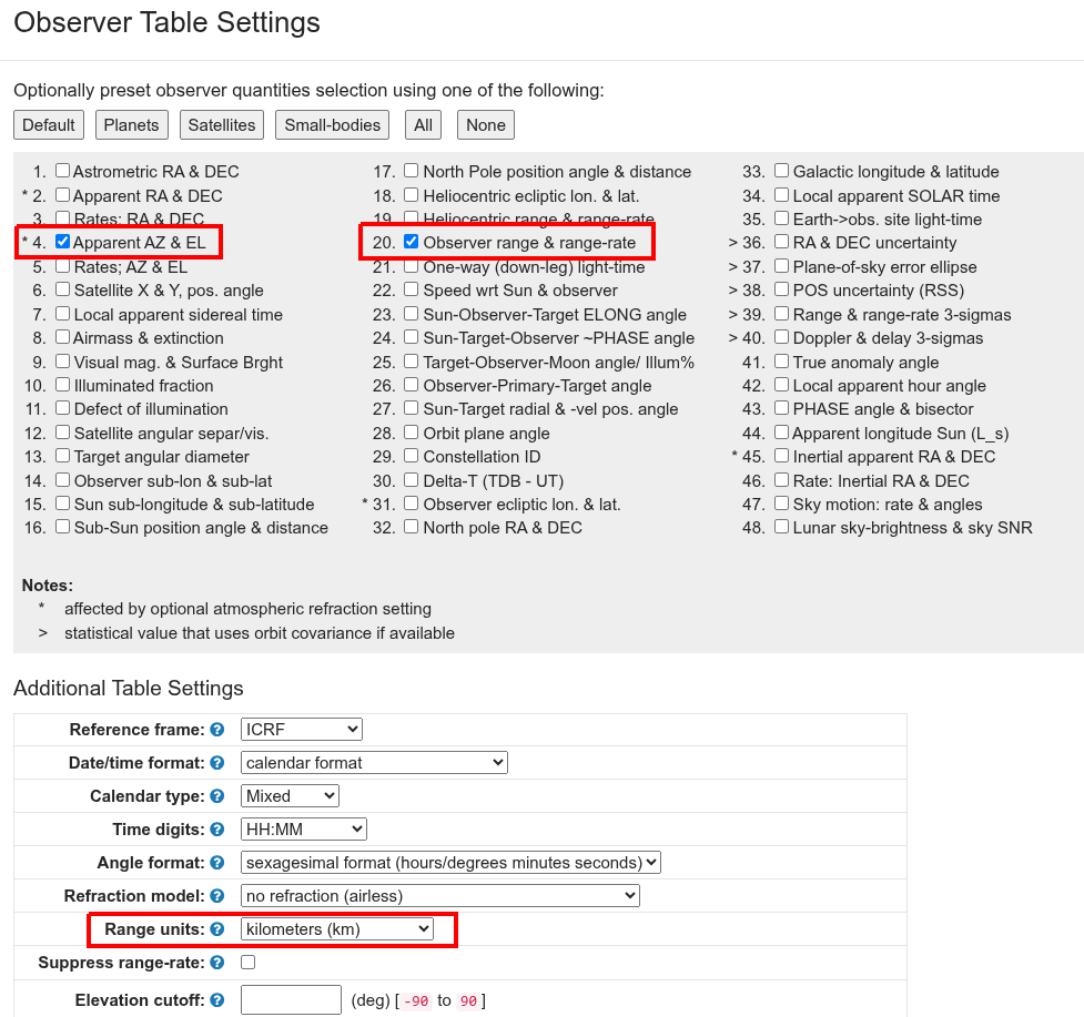

The mission is listed on JPL. This NASA website allows you to calulate azimuth and elevation and a lot of other stuff for your own location. See:
https://ssd.jpl.nasa.gov/horizons/app.html#/
Fill in the details:
Make sure to inlcude option 4 Apparent AZ & EL for the Table settings:

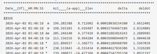

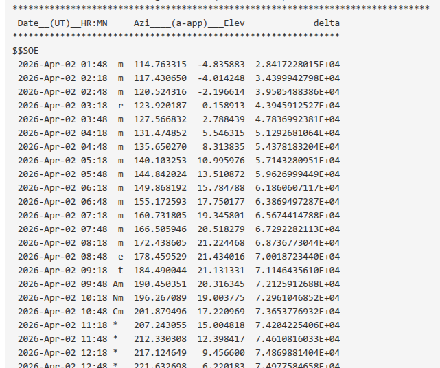

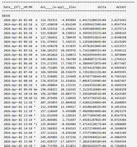

And you will get this table:
So it starts in the South at azimuth 196 at only 8 degrees elevation for my location.

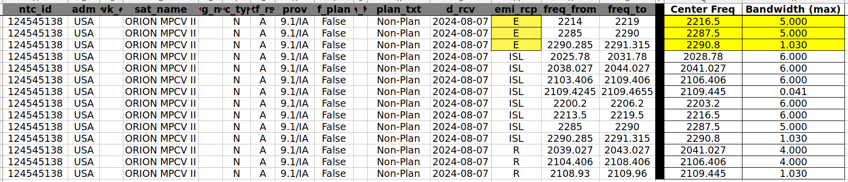

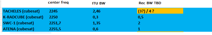

The ITU entries have already been shared, but I found this nice table in the Artemis II elements channel showing the S Band frequencies:
They have not yet been added to DB I guess.

I find it handy to include Option-20 (Observer range & range-rate) so that you get a “delta” column which shows the distance from your location to the spacecraft. That way you always know whether it’s coming towards you or moving farther away - therefore what type of doppler movement you can expect.
Sorry, forgot to mention that I also check the box to “Suppress range-rate” to leave you with just the columns you really want.
Screenshot from 2026-04-01 04-48-48
On a related note, please be aware the the PSTRotator software is already setup with a direct interface to Horizons. Extremely handy for using an AZ/EL rotator to track objects beyond Earth orbit.
thank you for the advice. got it.
