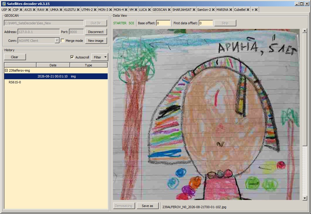

Vlad,
Admiring the great success you and others are having decoding these beautiful pictures. Please tell us how you are doing this and provide some test files.
As has been the case with others, I’m getting mostly poor results, if any.
Thanks,
Bob
N6RFM
I use the programs:
SoundModem
http://uz7.ho.ua/geoscan27.zip
SatsDecoder
You can download the test ogg audio file from here:
Result:
Thanks Vlad!
Very much appreciated. I have made some progress as well. This might be of interest to those using a linux OS. GitHub - N6RFM/239alferov-pipeline · GitHub
