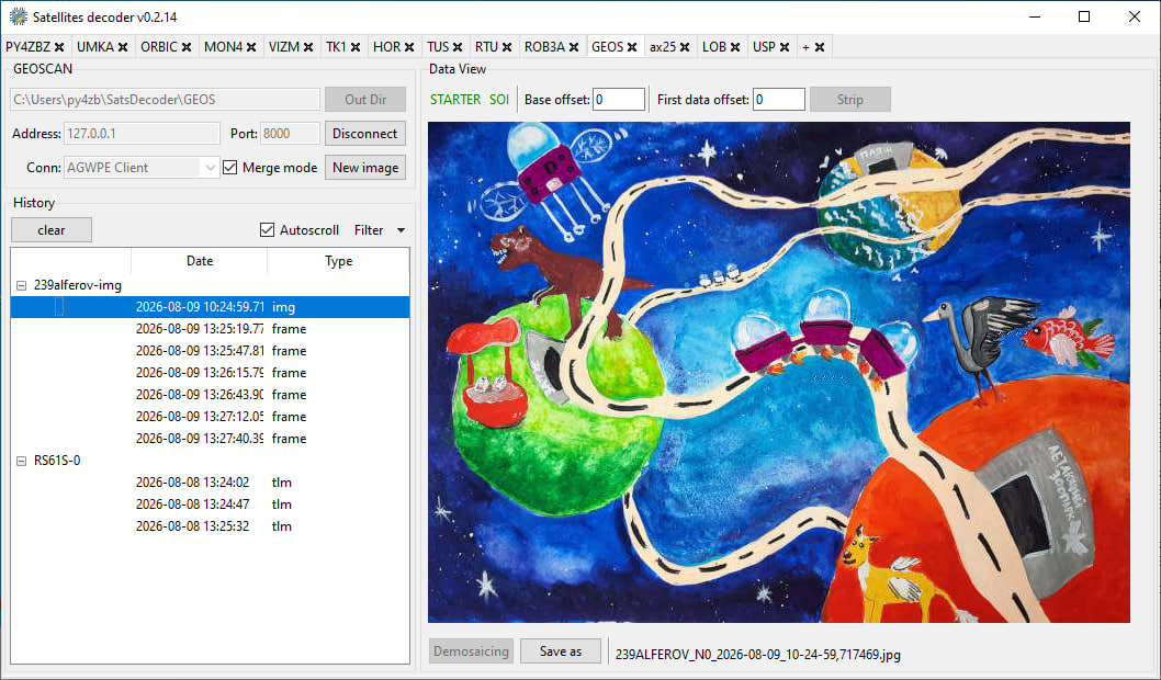

i trying use this tools:
soundmodem geoscan 27
and latest nightly build of SatsDecoder
but never success decode the image. the image always broken jpg. TLM and frames are okay. i try with/out merge mode too but no result. i also try variant DCD threshold of soundmodem and uncheck non-ax25 filter. but same result. the jpeg image is broken, cannot open. trying using older version of satsdecoder but same result.
any suggestions?
thank you!
