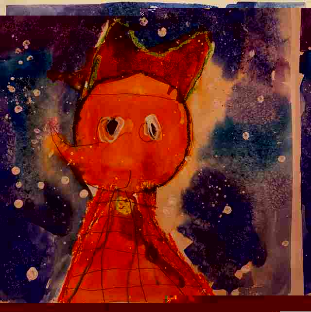

Works fine. Need better SNR I suppose. I do the manual tracking. Another option is to use skyroof.
i try playing audio ogg from satnogs observations. is possible?
Yes that works too. But I have found that at low SNRs the decoding is poor. Try this from the recent recording.
Alfrev SSDV 16th Aug 26.zip (8.5 MB)

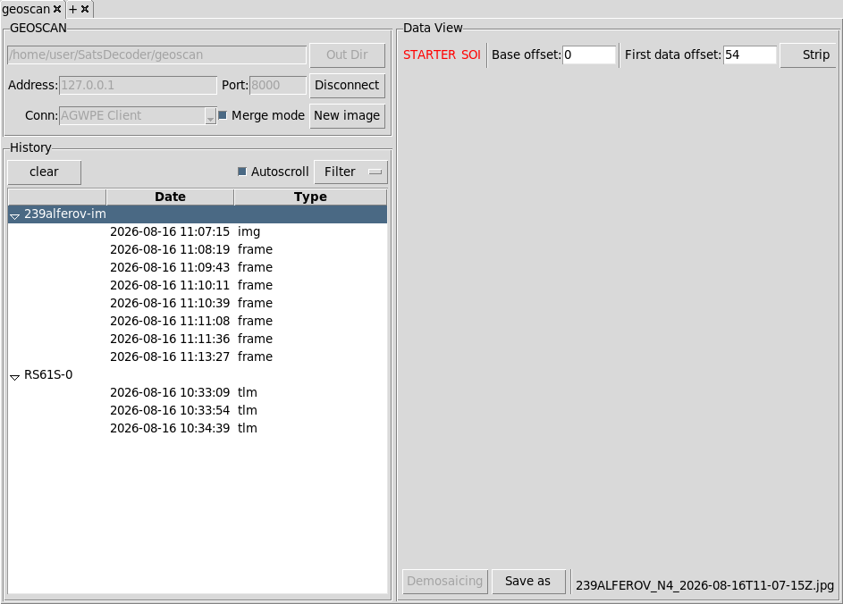

im trying decode from this obs. but only result broken jpeg
Try the zip I have shared. This is from the pass few minutes ago.
same result. the jpg output still broken.
wondering..

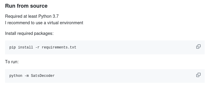

i’m trying also running from source

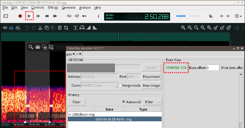

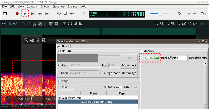

Play PE0SAT’s observation again but only the very first packet. This holds the SOI (Start Of Image hex sequence).
And check if STARTER SOI switches to green.

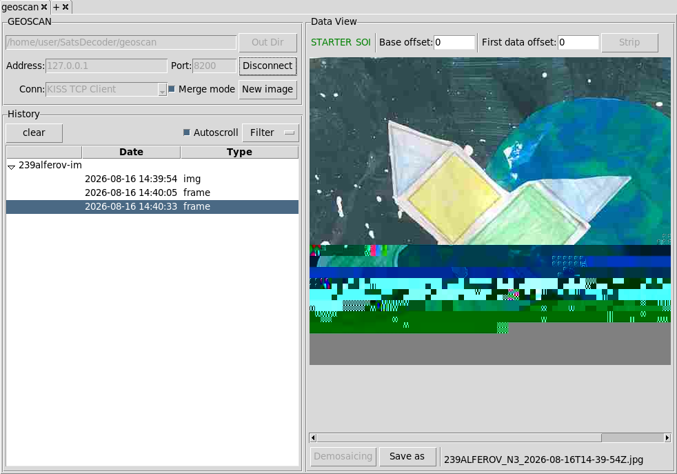

update:
i try change from AGWPE client, to KISS TCP Client on SatDecoder and enable kiss server on soundmodem. now its better, can decode the image. with same observation # 14795307 but still not perfect as @PE0SAT video. @dl7ndr , the SOI is green.
but i’m download first the ogg audio file, than play using ocenaudio. because if i directly play the audio from satno website, the picture is worst.
maybe the problem is from soundmodem self or wine…

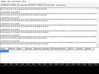

i run the soundmodem with this command, with no error or warning on console:
env WINARCH="win32" env WINEPREFIX="$HOME/wine" wine hs_soundmodem.exe
Sounds like SoundModem cannot decode all packets.
Check the volume level on the record tab on pavucontrol for ALSA plug-in [wine].
Lost Few Packets
My guess audio routing towards hs_soundmodem.
I used pulseaudio in the past and now pipewire because Debian has switched.

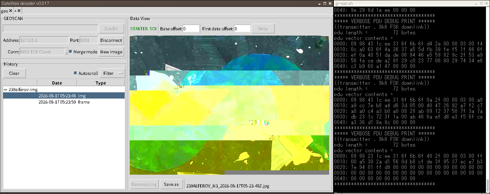

Do you know if gr-satellites supports the 2.7 version of GEOSCAN?
gr-satellites v5.9.0 supports 239Alferov.
I was not sure because the .yml file just says framing: GEOSCAN for both the old GEOSCAN satellites and for RS61S (239Alferov).
But you are right,
gr_satellites 239Alferov --audio --samp_rate 48e3 --kiss_server 8001
reads also the image data.
@bali, wanna give it a try with that?
Don’t forget to switch to submit_tlm = no in gr_satellites’s config.ini, so nothing will be submitted to SatNOGS.
However, I realized a long time ago that gr_satellites’s decoding is quite poor.
hi thank you. yes i had try gr_satellites before, but with --kiss_out option, then input the kiss file into satdecoders.
