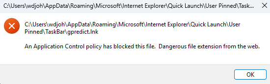

I recently installed GPredict on Win11 - initially it worked fine, but I now get the following error:
Any suggestions?
Any suggestions?
Hi, my guess Windows 11 see that GPredict as harmful and had blocked its access.
Probably you can run the program as administrator or get to the Windows Defender > Virus and protection and get GPredict on Exclusions.
Hopefully that helps.
Adhito
migration to gnu/linux is better option imho..
Try to run the gpredict.exe directly.
Could be in C:\Program Files (x86)\Gpredict or wherever you’ve installed it.
seen like broken link shortcut
