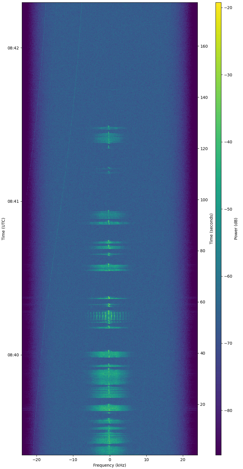

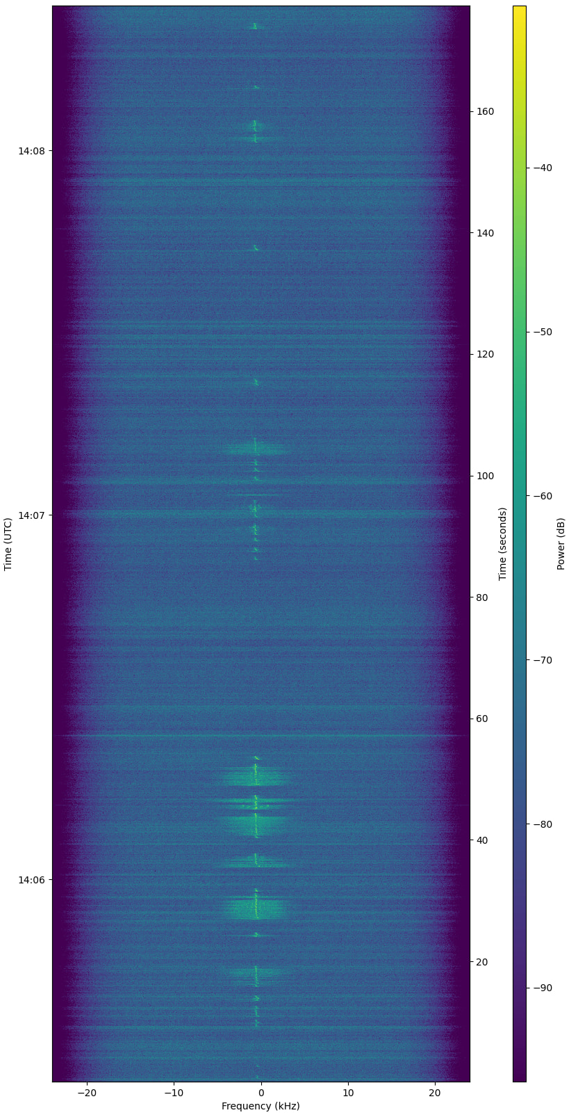

I’ve been double-dipping into this SSTV mania this weekend… I FINALLY got my improved coax for my SatNOGS station, and I wanted to compare against my portable Yagi setup. This morning, I get a WEIRD interference on both collection systems. Below are a series of Observations, the first one is the “normal” environment before the mess, then the messy ones, and then the first obs after the mess.
Listening on my FT818, it was mostly a background irritation on FM… clicking. But on any AM mode, it was a couple tones… like morse, but just Dit’s. And regardless of where I spun the dial (from 420 to 437MHz), the tone never changed… tone. You know how morse is a lower or higher tone, depending on where your dial is? This tone was constant, making me initially think it was inside the receiver, until I pulled the antenna off and it went away. And then noticed the obs at the same collection time frame had this interference.

(And before you ask, the Yagi system was on battery, so not a house-ground issue. I pointed the yagi in all directions and I didn’t detect a strong/weak pattern… and being on the back deck, I was kinda expecting SOMETHING. And it went for three hours… that’s quite a while.)

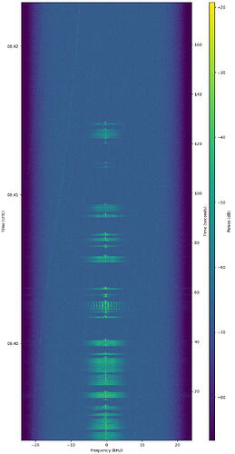

I once experienced something similar. At first I thought the problem was with the cable, antenna or connector and the signal noise floor on the waterfall went up and down, especially when the RTL-SDR gain was increased above > 25. I accidentally found the solution. I tried moving the antenna just a few meters (maybe around 1 metre) and lowering its height (around 2 metre), and the noise disappeared completely. Even when the SDR gain was set to 48, the noise floor stayed stable. I suspect this was caused by EMF from the power line from the grid to the house that runs near the antenna. If you want to test it, try moving/lowering the antenna and try inside the house, away from the power line. If the noise disappears, you can be sure the source.
before = left = gain: “22.9” | after = right = gain: “48”
