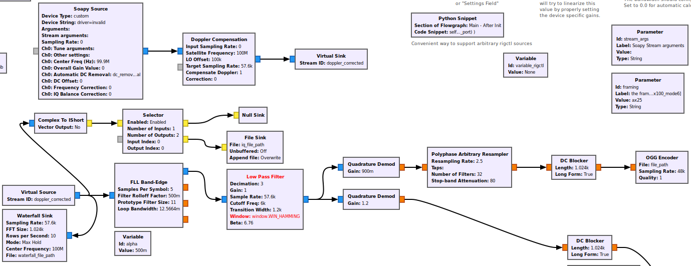

Welcome,
The ogg file is the signal demodulated audio out and not the IQ.
Below a part of the used flow-graph
IQ files are only created on the SatNOGS-client when the option is configured.
Nice to meet you and thanks for your quick response. This flowgraph helped me understand it.
