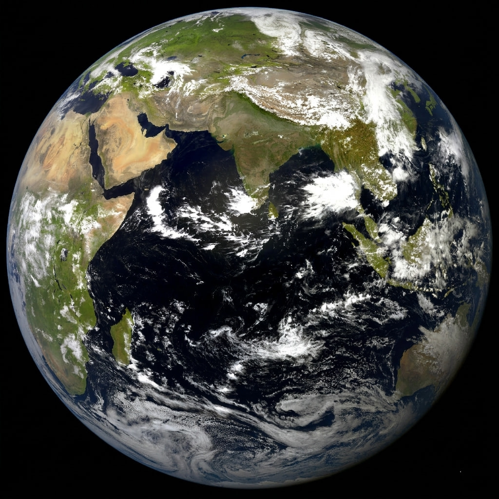

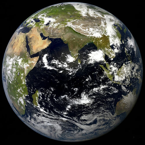

Yes you can use the 2.4 m dish to a linear feed to get geostationary data in L band. It depends on the region you live. Some examples are Fengyun 2H and 2G / Elektro L2/ L3/ L4 (L5 has issues, L2 only X band), GK-2A, GOES, Meteosat etc…
This is from Elektro L3 from my station.
