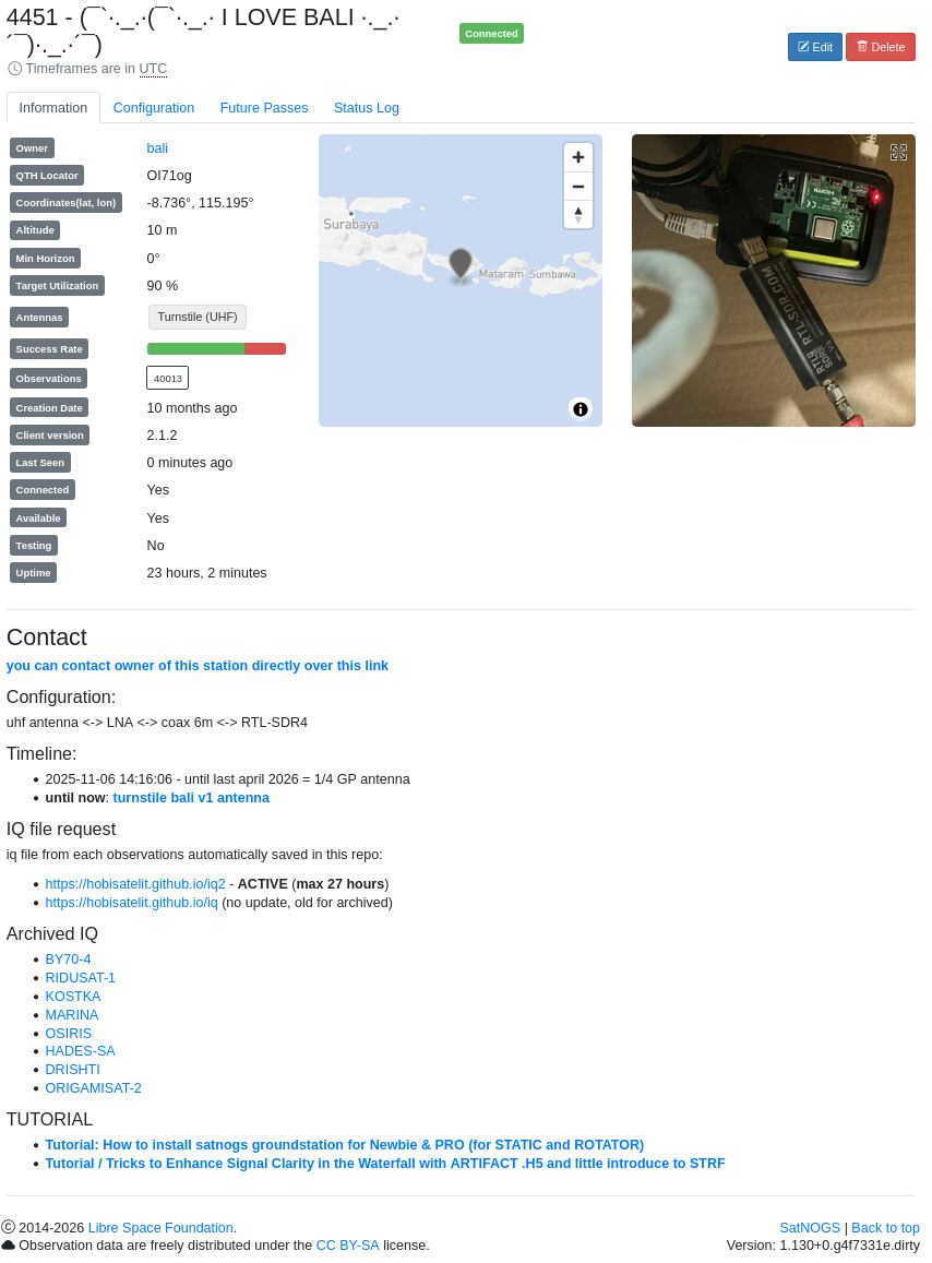

One addition of a minor feature is also, that stations support markdown in the description page now. The amount of text that can be posted there was also increased.
@bali @PE0SAT @SA2KNG I had explicitly in mind, that linking the Upload-folder of IQ-samples in the station description might be very handy.

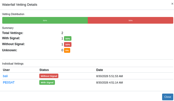

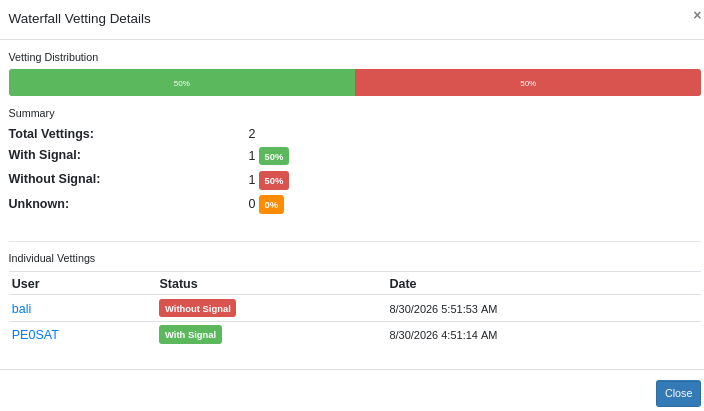

wow. cool. seen like facebook
thank you for notice me about this!
trying this new feature button
now we can vote battle
and result:
1 vs 1
example taken from this observation
please other try vote there.. i want see who win.. lol
