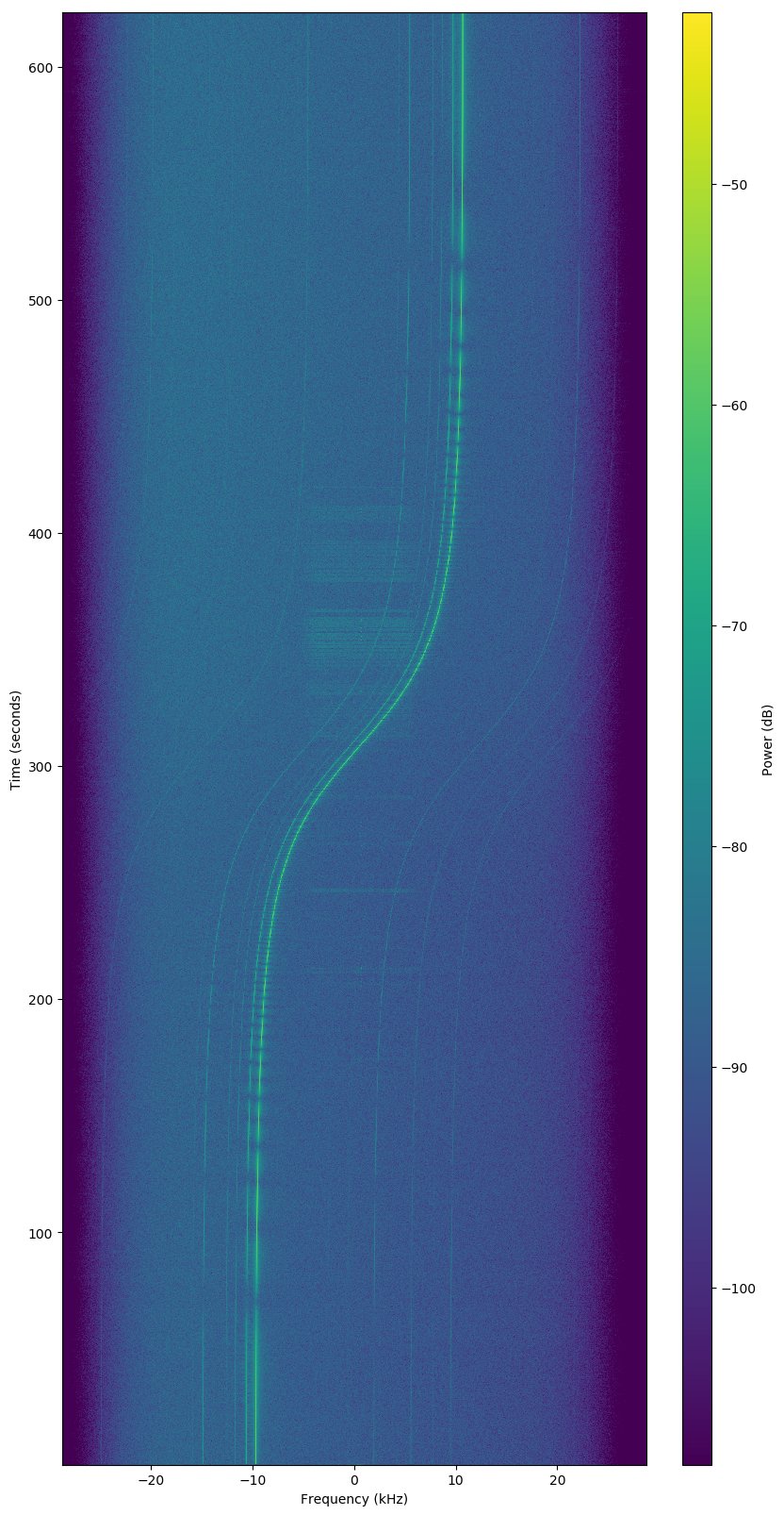

Today I did some tests with my “large” UHF LFA-Yagi (13 element vert pol) at fixed 30 degree elevation. I got several passes with decodes, for exemple this one:
https://network.satnogs.org/observations/2674654/
So I think I will go forward with this solution. Stay tuned for more updates later!
