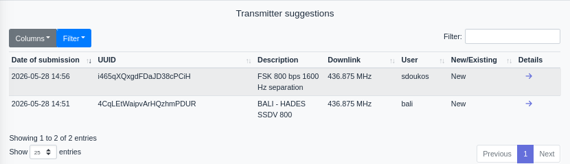

In order to start using these two new flowgraphs we have defined two new modes in SatNOGS DB, GENESIS FSK and UNKNOWN. In the next days/weeks we aim to create and review suggestions for satellites transmitters to replace old modes with the new ones where is applied. Any help on this process is more than welcome!

  1. GENESIS FSK currently is only paired with baudrate values at 200 or 800, if this doesn’t apply to a satellite transmitter then please open an issue/work item in Work items · librespacefoundation / SatNOGS / satnogs-flowgraphs · GitLab to support other baudrates

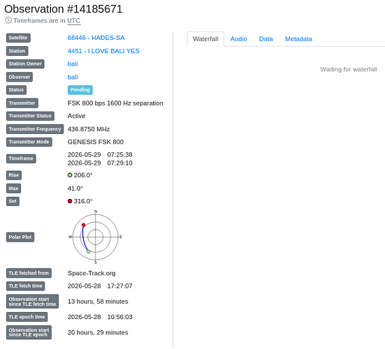

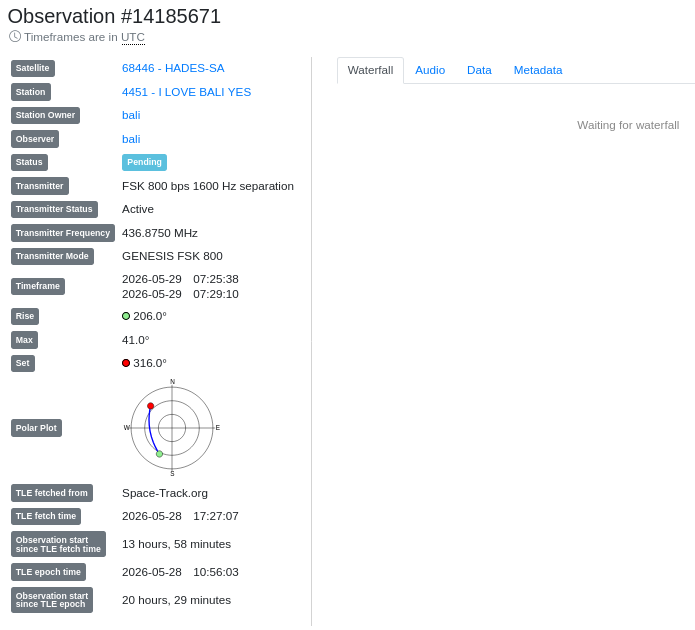

Thanks for this update, I have created some obs to see how they are working.
not work.. sorry to say, bad audio ahhh.. the gs client still use old version of satno…
scheduling for next two hours (latest version of satnogs client docker = image: librespace/satnogs-client:master-unstable). hope the audio is work
still same. not work. in log:
grsat - INFO - Observation: 14185671, Norad: 68446, Name: 0 HADES-SA (SPINNYONE), Script: satnogs_fm.py, Baud: 800.0, Freq: 436.875 MHz
audio not work. bad audio.
