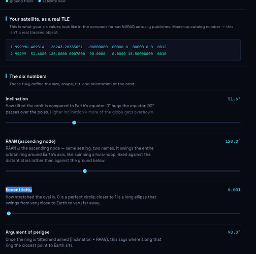

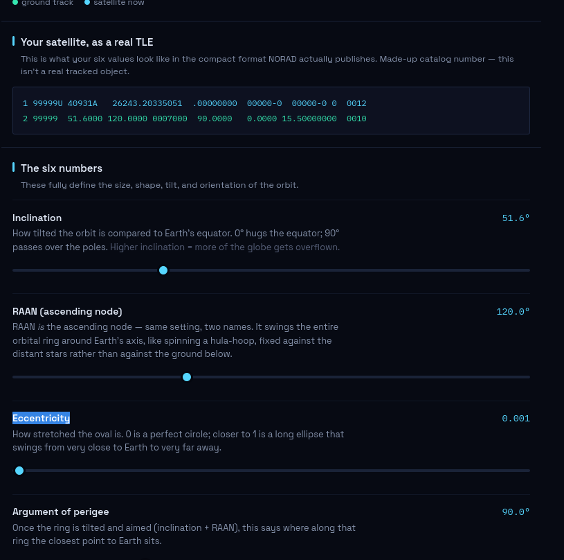

After trying to create this TLE simulator, I finally came to understand very clearly what RAAN/ascending node, mean anomaly, mean motion, eccentricity, argument of perigee, and so on actually mean. After running the simulator, I also learned why, when observing a satellite’s trajectory—such as that of the Meteor-M2-3 satellite—it sometimes travels from the north, but at other times from the south.

  1. now in: english, bahasa indonesia, german, netherland, chinese, japan, russia, spain, greek.
  2. no need much scroll up and down
  3. can directly input value without slider

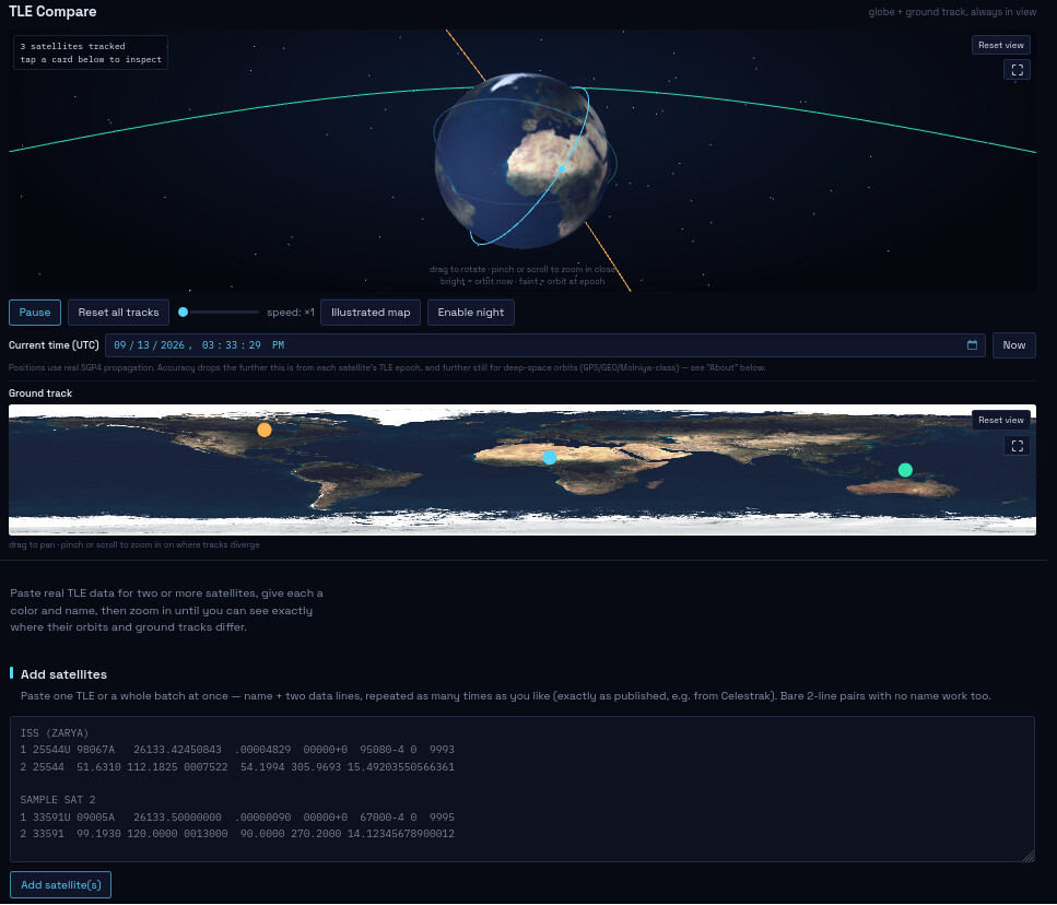

second version, now with actual pertubation, and realtime track
try here - tle compare
