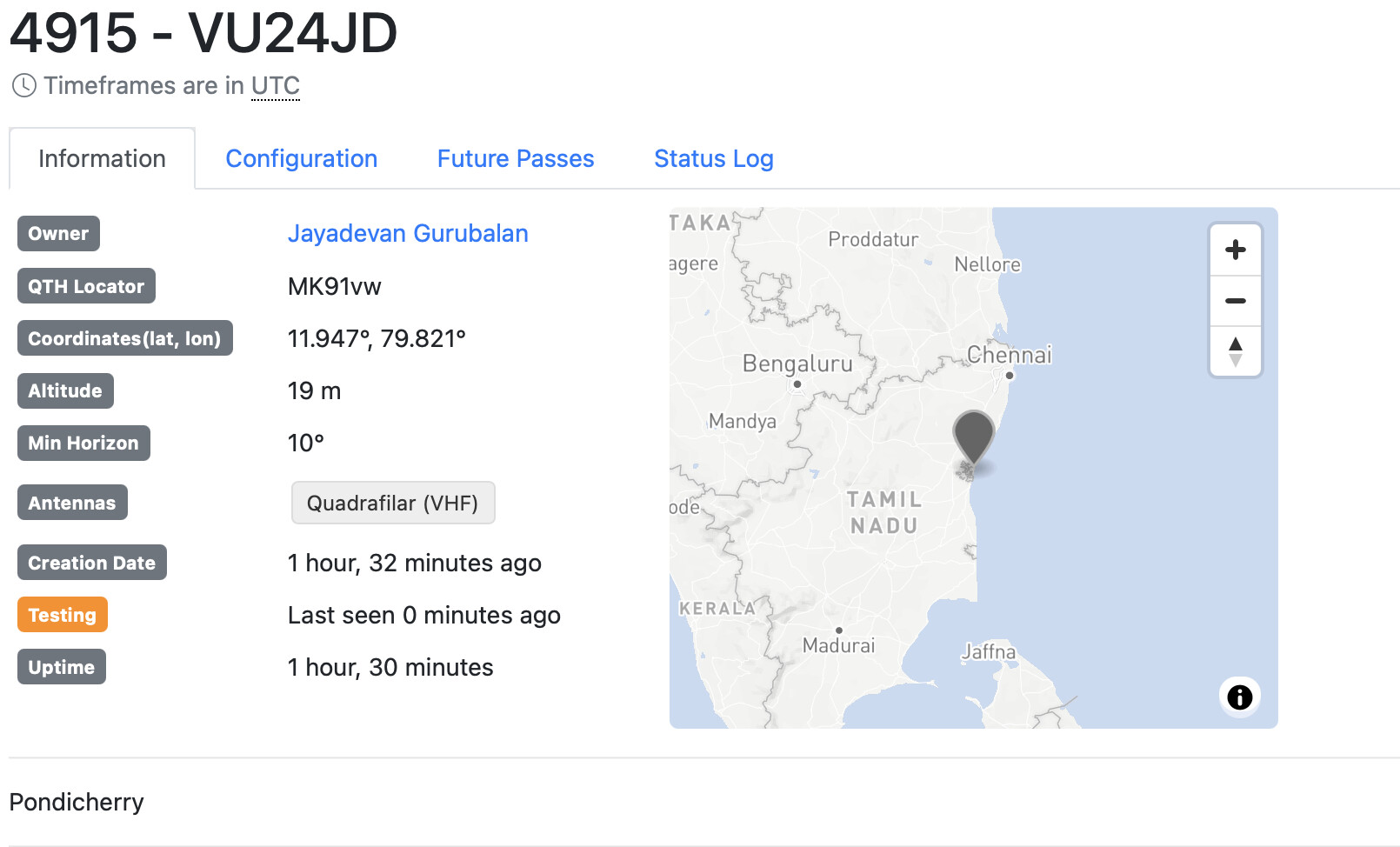

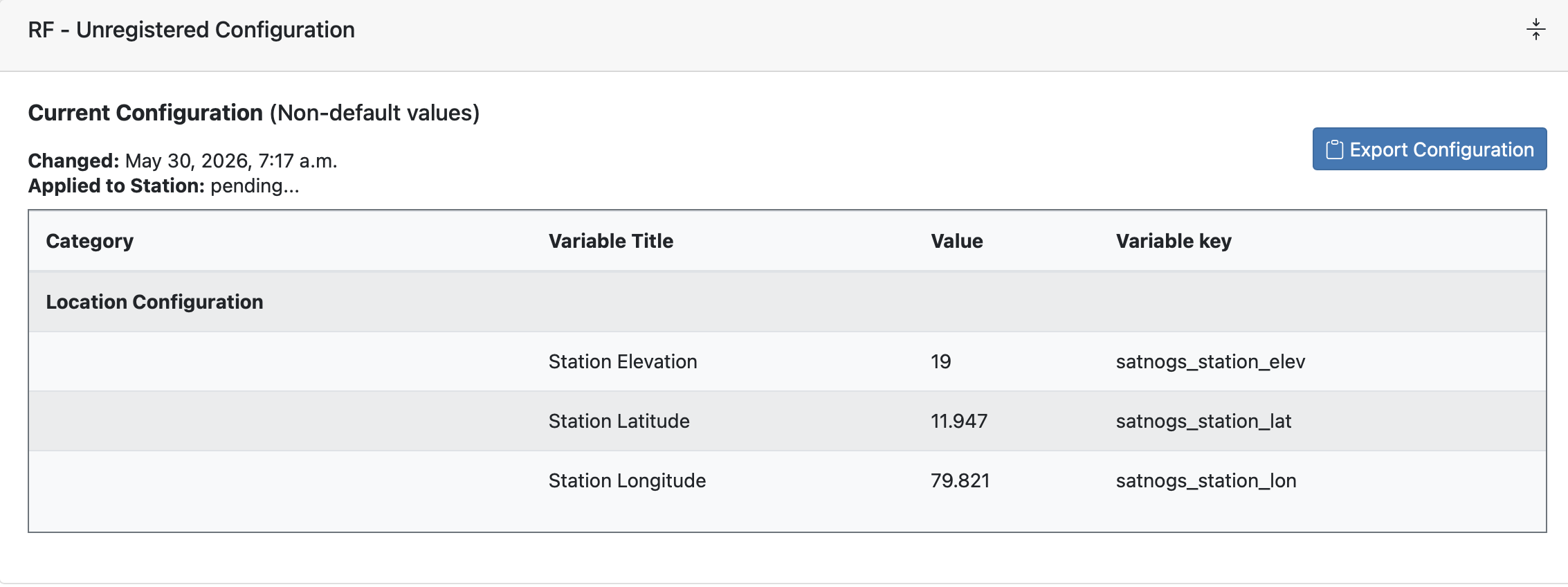

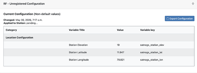

Just a quick question. The installation part works fine. But the station configuration are not registered and not applied to the station. Its pending for hours .. any suggestions?

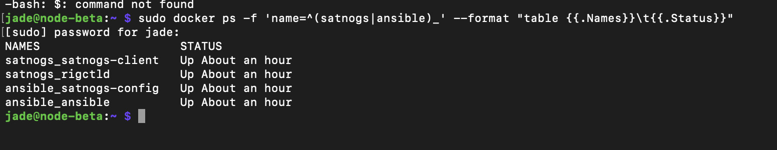

can you inform your station id, or any screenshot of logs
station ID 4915. its uptime more than 1 hour but configuration are still pending.

Can you select future passes and add an observation, it is currently in testing to see all works correct?
I have no idea what you are trying to tell with this screenshot …
Sorry about that. Satnog client is installed in the Raspberry Pi and connects. The ground station becomes live in the satnogs network dashboard (green). But the configuration always says “Applied to station pending” and my Satnog client in my pi is not pulling jobs from the network.
Thanks for clarifying.
At the moment the station is Offline so it won’t interact with the network.
Previous it was in testing and that is a very good start, but that also implies that no obs will be created on the system in that mode.
You need to create observations yourself and that is why I suggested in an earlier reply to go to SatNOGS Network - Ground Station VU24JD select Future Passes and add some obs manually.
Then after some obs have run you can check if all is working correct or needs some adjustments before removing the testing setting.
