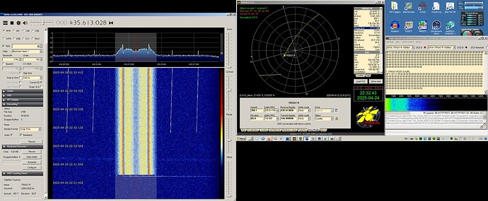

TRISAT-R is still active!

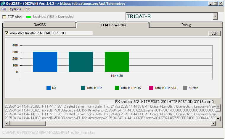

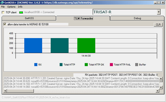

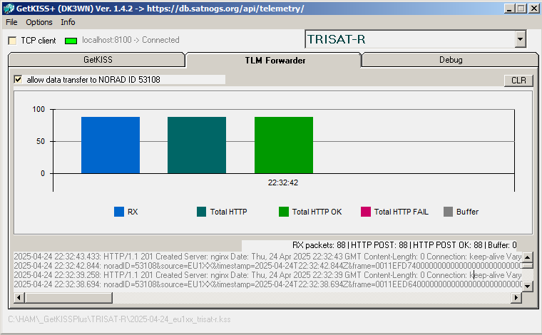

TRISAT-R RAW Telemetry
302 Frames uploaded.

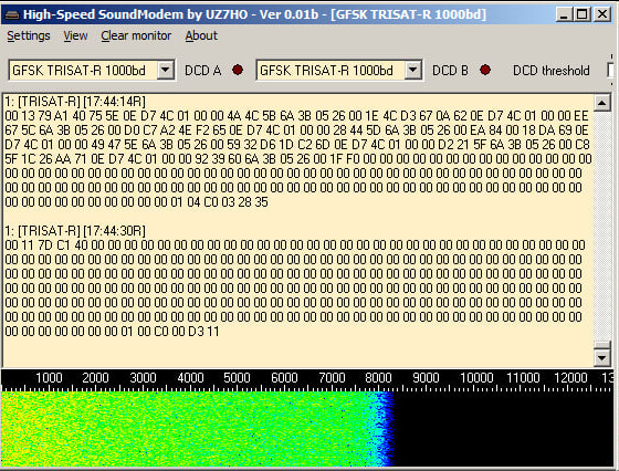

Huge thanks UZ7HO for new SoundModem!!! :
http://uz7.ho.ua/trisatr.zip

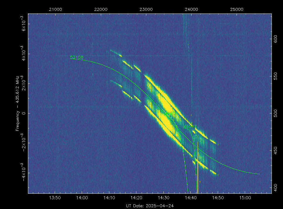

Thanks Vlad, yes it is, the last one of the satellites in MEO.
I need to give it some attention because it has a TLE lost status and need to correct them with some observations.
It flies about 5 minutes earlier than predicts old TLE.
Observation #11473184
Cristian - YO4DFT
Using three passes with signals to get the following TLE set.

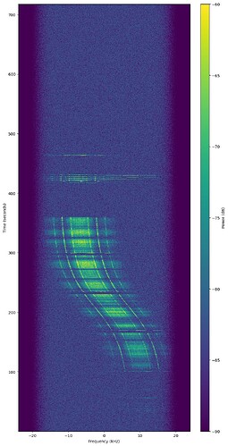

This satellite also seems to suffer some issue’s, the LO keeps jumping making the data point selection a bit difficult.
TRISAT-R
1 53108U          25114.60467797  .00000000  00000-0  00000-0 0    09
2 53108  70.1728  85.8053 0013113  84.6879 326.3229  6.42348779    01
I need more obs to get a better match and also correct possible errors.
New TLE very good now!
We have some frequency drift
obs: https://network.satnogs.org/observations/10830902/ 2024-12-28 12:19:14
obs: https://network.satnogs.org/observations/11474475/ 2025-04-24 22:29:44
Good TLE

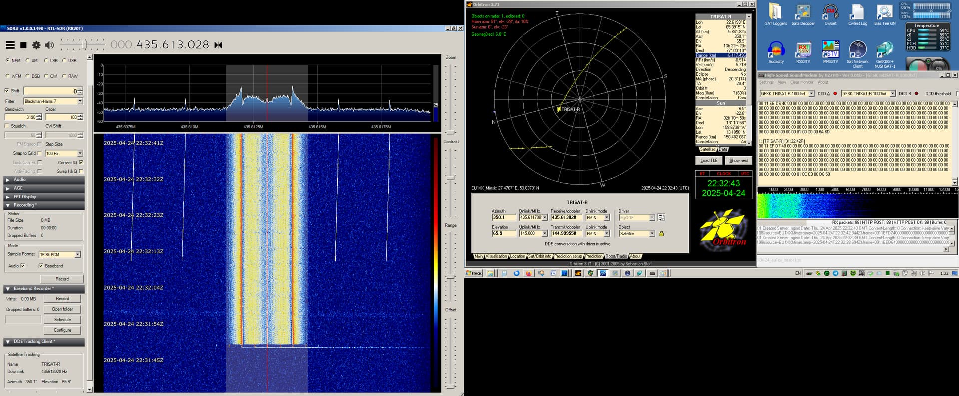

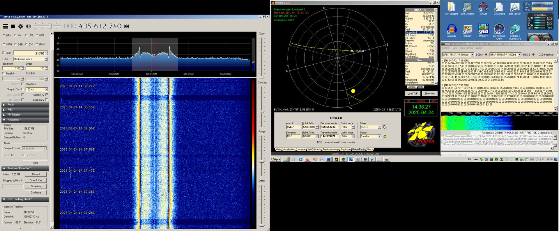

TRISAT-R Now
Checking this morning pass with these TLE and they are looking pretty good.
