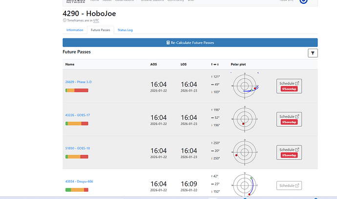

Hi,
from your link I went to “Future passes” and was able to schedule 2 passes if I respected the “to be at least 5 minutes in the future” time setting.
So now I choose 2 satellites with a lot of green observations , random , which should be ran in about half an hour from now. 19:46 UTC over here :wink:

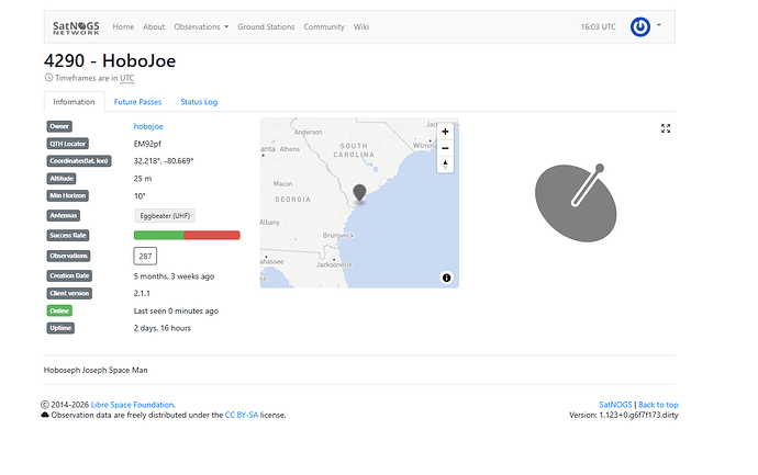

I have moved my ground station to (what I think is) a prime location on Hilton Head Island. I set the gain to 32.8 as a first attempt/baseline.

Hi

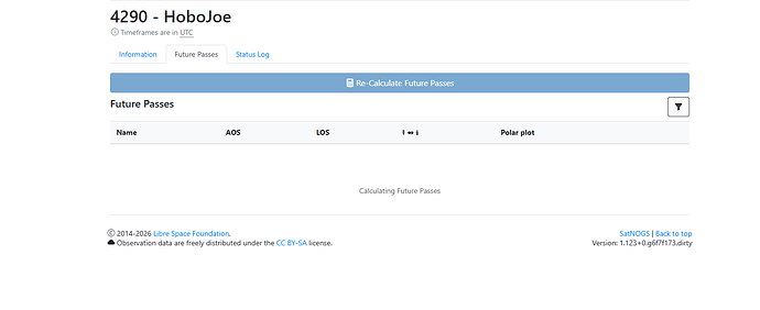

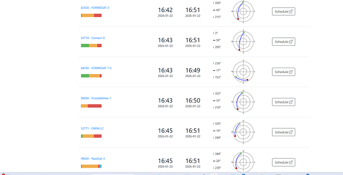

I go to this page:
I select “Future Passes”
I wait a bit for the calculations :slight_smile:

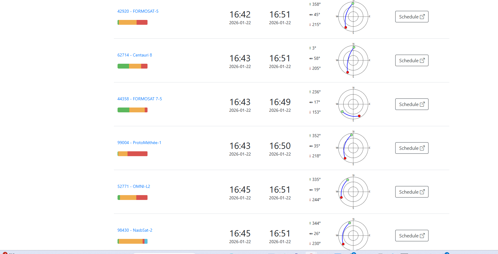

I scroll down to find something in the future, anything from 15 minutes from now should work, and I select some satellites with lot of green in the bar, that shows they have been received a lot
scrolling down shows me there is free time from 16:42 UTC

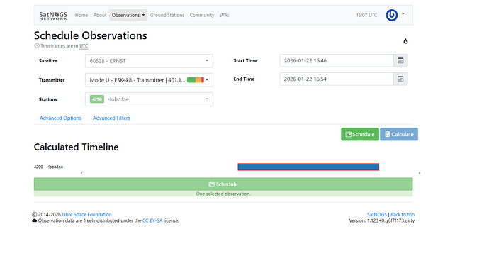

So I decide to pich Formosat and Ernst
which scheduled succesfully.
Does that make things clear ?
