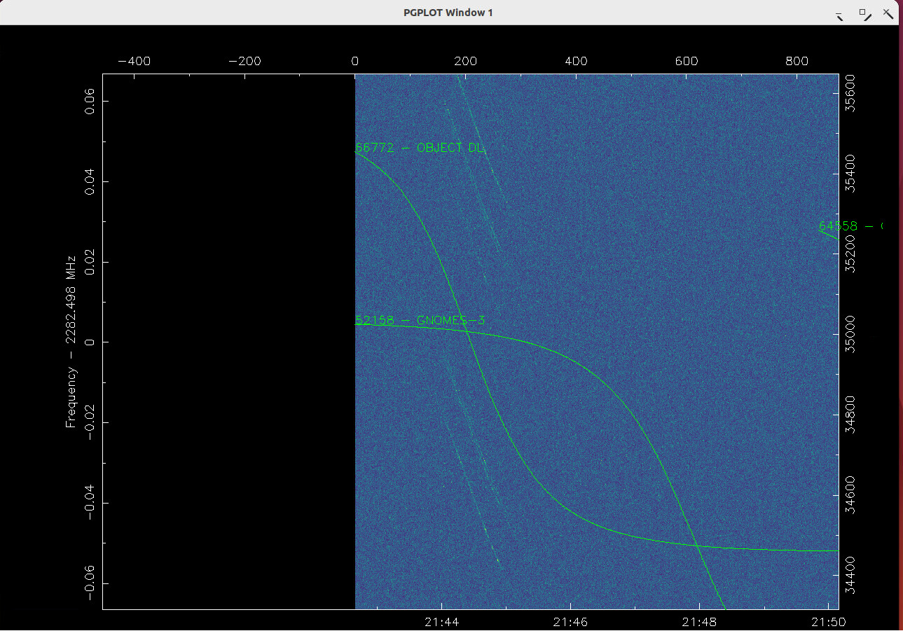

66772 IHI-SAT2 at 2282.500 MHz
2 valid observations so suggested to the DB

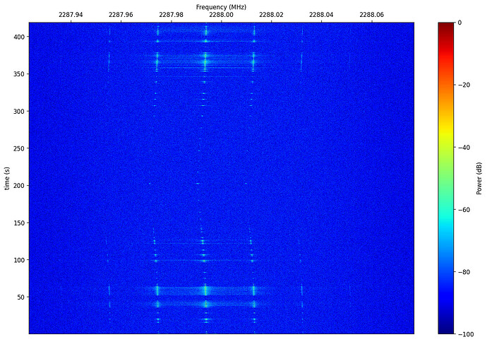

Hi Fredy,
About 4 hours ago we managed to maintain and establish communication with the satellite BlackKite-1 using 66670 26004 TLE. Here are the details:
Pass 1
AOS: 2026/1/8 06:27:00 GMT+8
LOS: 2026/1/8 06:34:36 GMT+8
LatLong: (65.647366, -20.223862)
1 66670U 25276E   26004.16749400 -.00091397  00000-0 -45543-2 0  9994
2 66670  97.4293  80.4830 0006698 194.6780 165.4260 15.17958752  5524
And about 7 hours ago:
Pass 2
AOS: 2026/1/8 03:10:11 GMT+8
LOS: 2026/1/8 03:17:10 GMT+8
LatLong: (40.466293, 49.486751)

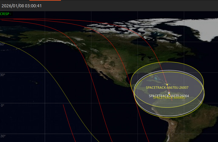

Unfortunately, 66670 in the new set of 26007 Spacetrack TLEs is certainly not our satellite. Using ikhnos on observations 13144893 and 13144970, we found 66688 to be the only candidate. While it is close, it is still not a good fit yet. We are inclined to stick to 66670 26004 TLE, though we understand that the TLE is getting older.
Currently the satnogs observations for BlackKite-1 have 66670’s TLE 26007 loaded. Considering the continuous changing of TLE that must be difficult to maintain, we have setup a website link with a txt file to the TLE we would like to use for future observations here: https://nuspace.sg/black_kite-1.txt
Hopefully this should make TLE changes easier!

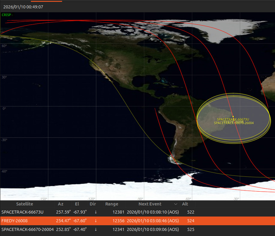

Hi all,
Using observation 13165917 and 13165868, the only SpaceTrack TLE that might be worth a shot for BlackKite-1 would be 66673. It’s close but not a good fit either.
Gpredict
Ikhnos 13165917
This text will be hidden
Ikhnos 13165832
This is admittedly a pretty bad fit.
At this stage moving forward, I agree with fredy might be better to generate our own TLE based on the observations till the satellites spread out far enough for SpaceTrack to correctly distinguish or assign them.

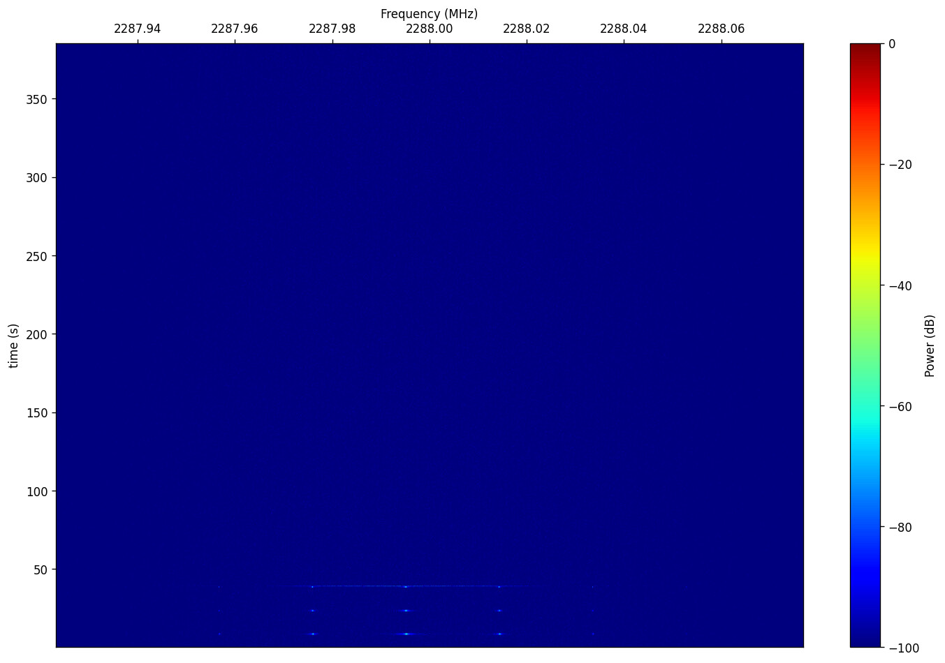

Hi Fredy,
This is awesome! We can see a pretty straight line quite clearly now on three observations:
Good Observations
SatNOGS Network - Observation 13178224
https://network.satnogs.org/observations/13178238/
SatNOGS Network - Observation 13178192
Unfortunately running ikhnos on the full suite of existing spacetrack TLE from 66666 to 66778 shows no noradID coming close to it. There might a possibility we were mistaken to be another object part of another ‘cluster’/’launch’ perhaps.
On another note, so far our own attempts at generating our own TLE in the past few days were pretty off (bad doppler shift in the middle.)
Our process is waterfall_tabulation_helper → dat file → rffit → ikhnos to check.
When using rffit we only fit ascending node, mean anomaly and mean motion (and the default ‘frequency’) where possible. We noticed that the new TLE also has changes in inclination, eccentricity and argument of perigee. Is this a result of an SGP4 propagation step after rffit or a sequence to which parameter should be fit in order during the rffit process?

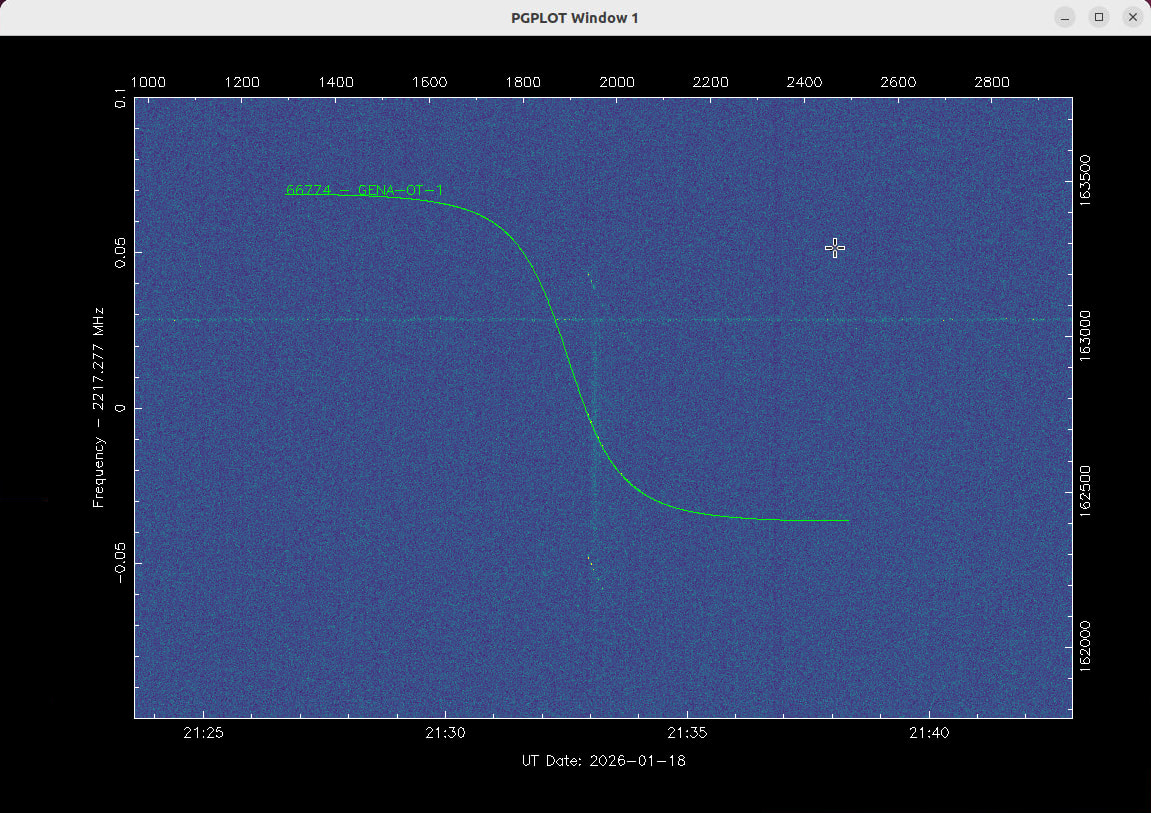

66774 GENA-OT-1 2217.293 MHz
It looks like that we still missing object for Black Kite 1 in space-track.org catalog.
