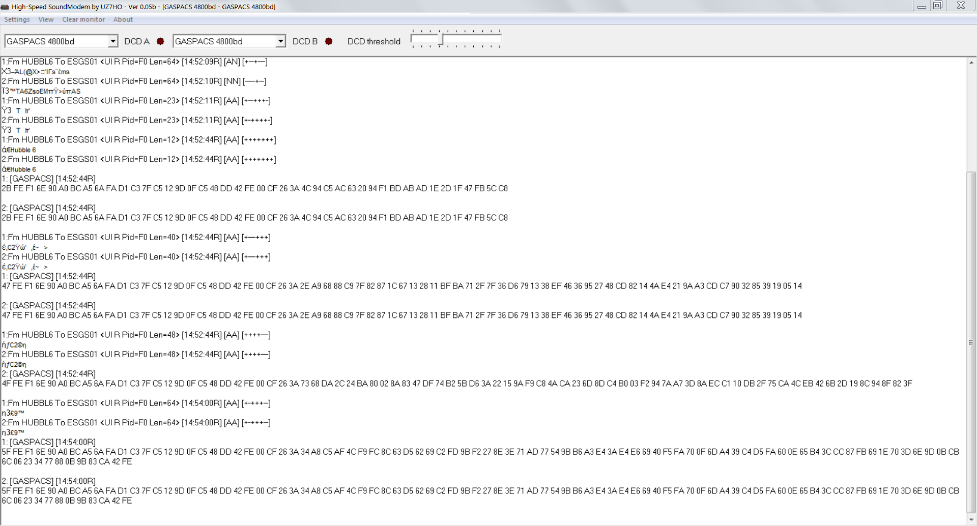

The presence of music hints at Endurosat, try SoundModem for gaspacs.

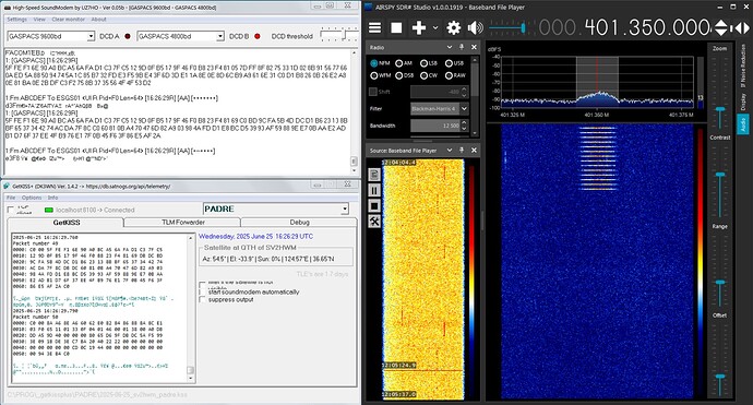

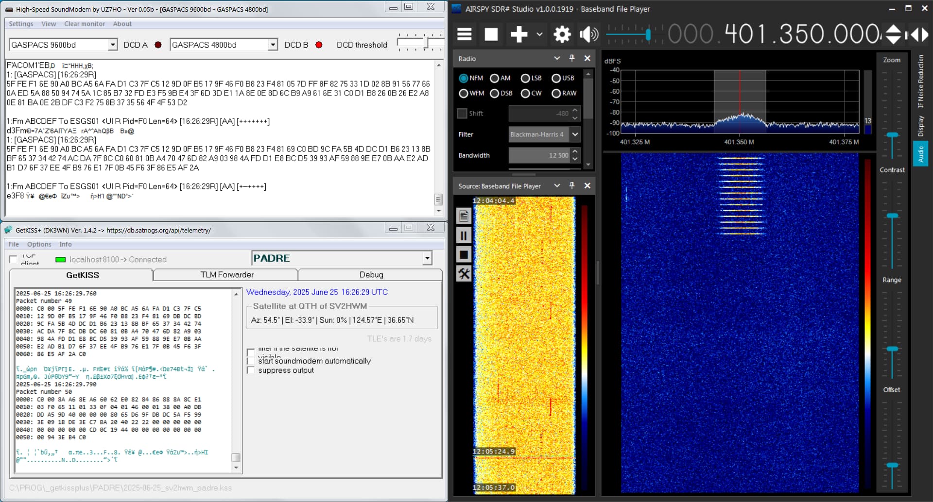

Also PADRE can be demodulated with the Gaspacs SoundModem. No music this time, but the word Endurosat showed up while decoding in FSK G3RUH mode

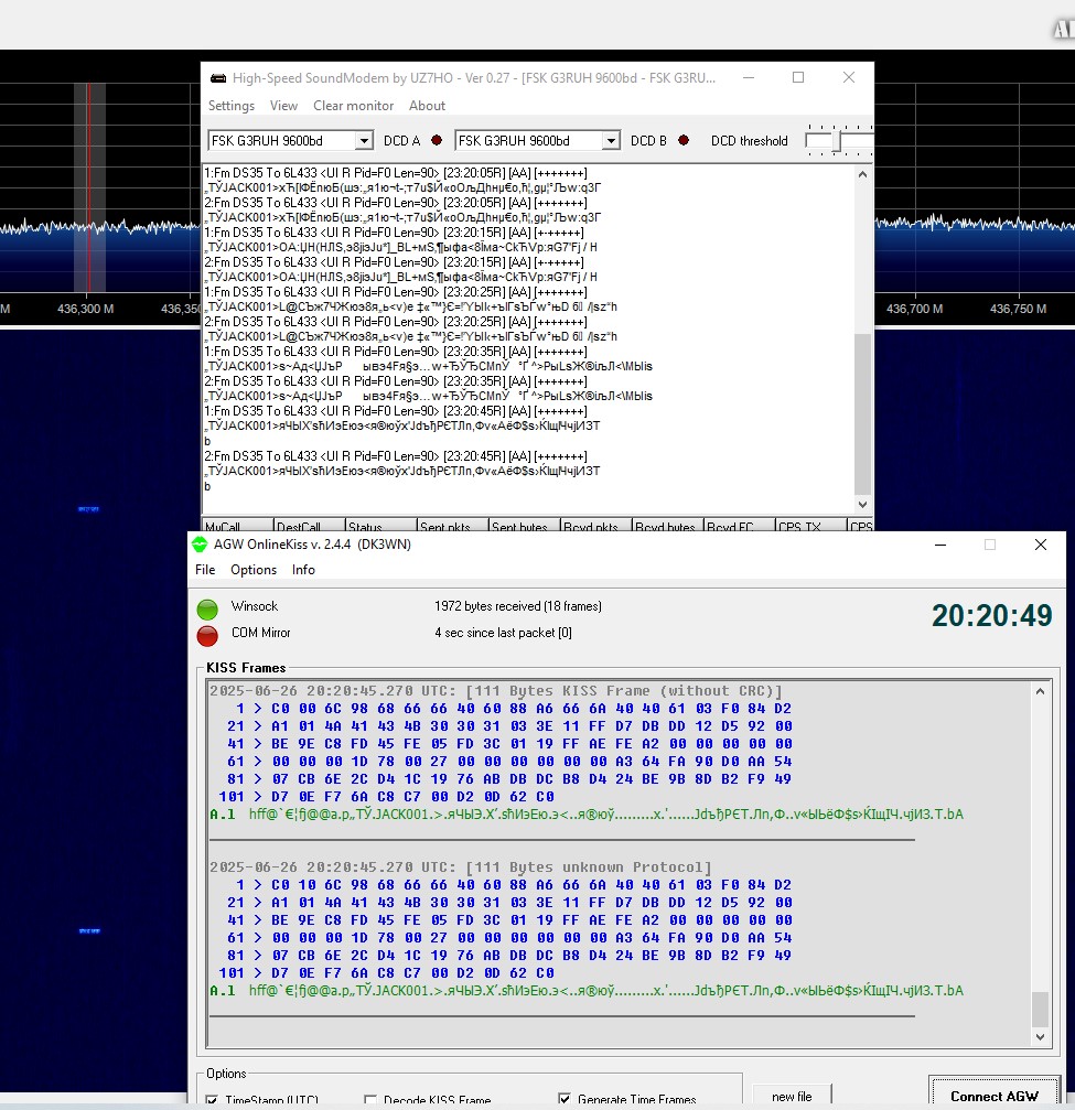

TPA-1 mission team here - can confirm the details and decode look correct. Happy to receive any packets the community might have to hand fill in our trending.
PE0SAT
June 26, 2025, 8:30pm
115
Welcome and nice to hear,
Can you share some information on the frame data?

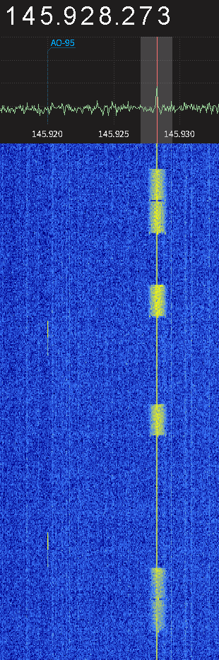

Pass on 2025-06-27 at around 12:1x UTC
PARUS-2 : no signals on UHF
RIDU-Sat 1 : signals, also strong ones, but not able to get it decoded.
K4KDR
June 27, 2025, 3:48pm
118
I looked at a SatNogs observation (SatNOGS Network - Observation 11834734 ) and checked the strongest packets - also w/ no luck demodulating. But, you can’t do but so much w/ audio.
If anyone has an I/Q file from a strong RIDUSat-1 pass, it may be helpful to try USB demod against the various deframers.
Inspectrum may be helpful also to confirm if it’s even 1200 baud.

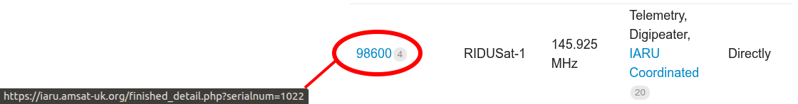

While the 145.825 listing for RIDUSat-1 has a good hyperlink to the SatNogs DB page for this object, the link down at the 145.925 listing needs adjustment, I believe.
PE0SAT
June 27, 2025, 6:13pm
120
Thanks Scott,
Changed the link so it points to the SatNOGS db
