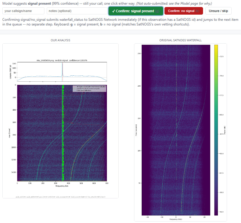

Quick screenshot during model training; currently sitting at 88% accuracy.
My station (#4950) is mostly drowning in a sea of yellow, so this is extremely interesting to me!
This is running, it will vet and submit those where there is a high probability of a signal, or there is no signal, leaving you to vet and submit the observations where the model is uncertain.

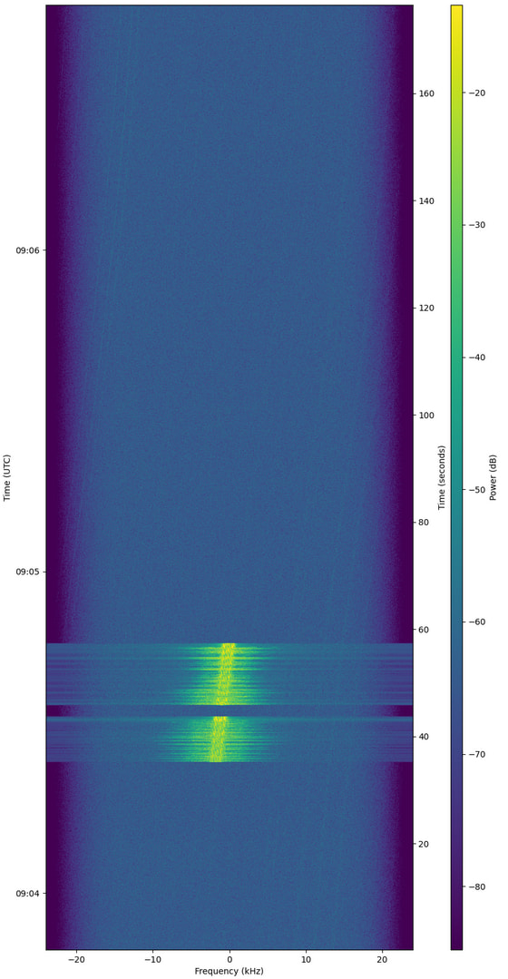

for strong signal from terestrial like this should be red

Thanks again for including my station! While the yellow labels are still piling up, I caught this interesting one today.
Cheers, Yukio (jp7dvx)

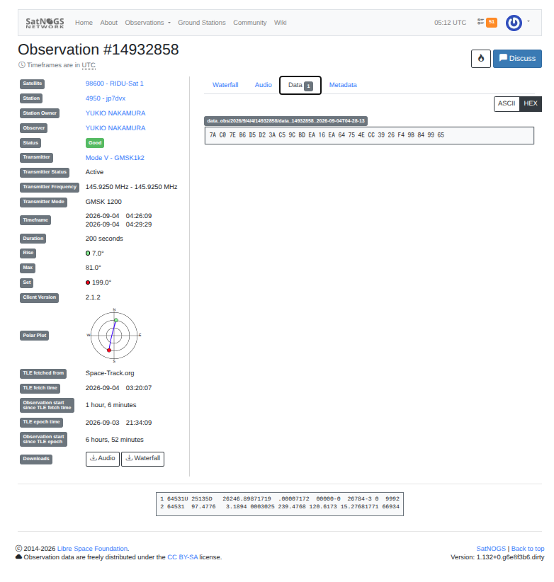

this not signal from ridusat
