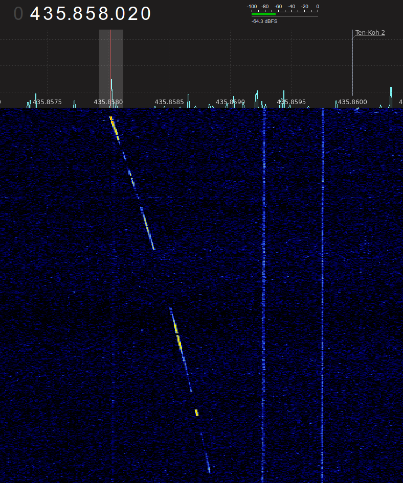

With the help of @tammojan and @cgbsat we managed to get our first CW signals from the Dwingeloo telescoop station:
The TLE is very good, so as soon as the object gets assigned we can move forward with identification.
It is clear that the satellite has some transmission issues, maybe due to not deployed antennas or something else.
Also note the fading of the signal in the 5th transmission, which is hard to see in station 384 which has the horizontal polarization, but easier to see in station 2338, which is vertical

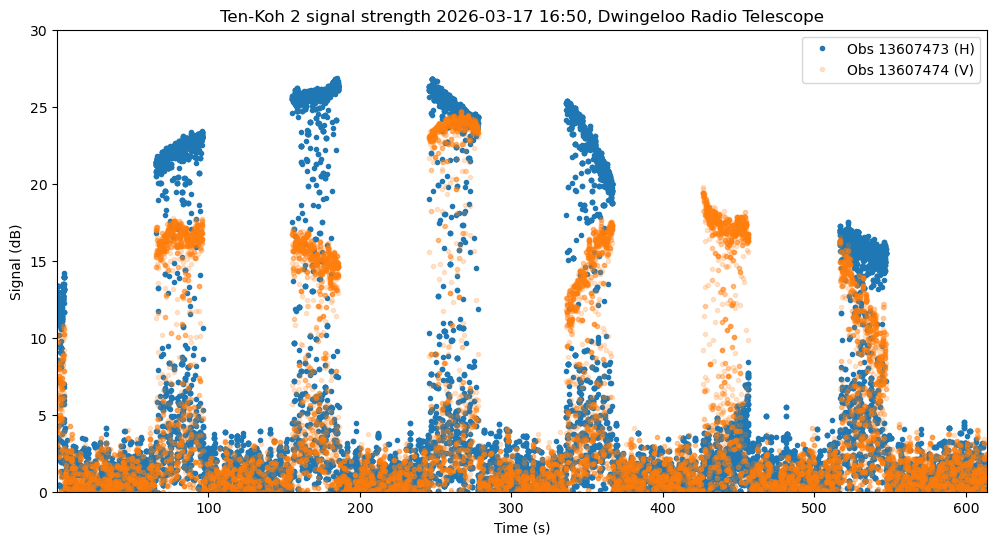

… it’s because I could not see anything on my high-gain antenna during the last 23:23z pass. Do you think the signal is the same strength RSP-03 was? On your observation for me it seems to be weaker.

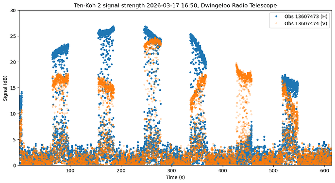

This is a plot of the signal strength in the Dwingeloo observations 13607473 and 13607474. The signal strengths 20-25dB are comparable to those of RSP-03.
There is a nice pattern in the signal strength, but I don’t see an obvious tumbling pattern.

Interesting diagram indeed! This doesn’t match the scheme of a rotating linear pol antenna, as we could see with the RSP-03 showing 2 sine-waves for h and v, but according to my experience with measuring spin with satellites with known attitude and spin, the sudden deep drops in signal strength come from obstruction of (parts) of the antenna by the spacecraft. This usually happens, when the antenna is not facing toward earth. This leads me to the speculation, that the antenna might be in a vertical plane, rotating mainly around the vector of orbital movement of the spacecraft.

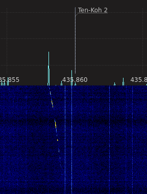

Here it is during 16:30z-pass in JN77pa. Very weak, not even as strong as the sun@435MHz,
3-4dB above cold sky on the 42-ele LHCP. Starting at 16:31z in https://network.satnogs.org/observations/13609701/

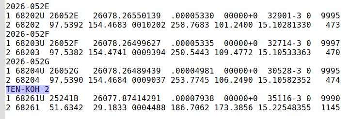

We have a TLE outside the analyst list from space-track.org, still not assigned but now we can set DB to follow it:
0 TBA - TO BE ASSIGNED
1 68261U 25241B   26077.87414291  .00007938  00000-0  35116-3 0  9991
2 68261  51.6342  29.1833 0004488 186.7062 173.3856 15.22548355  1145
And it’s official!

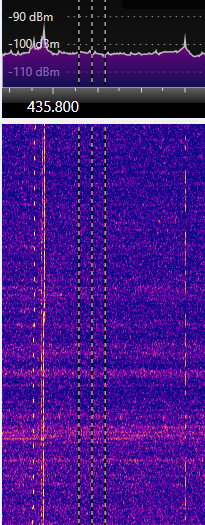

Since it takes a 20m dish to receive Ten-Koh 2, there’s no way that I saw this much of a CW signal from it on a 2.5-turn helical omni tonight, right?
Could not make out any real CW patterns either visually or on replay over the speaker.
Looks like it is the CW telemetry indeed, which is possible even with this antenna and the bird in favourable position. The problem is, that you need at least 6db above noise for 30 seconds without qrm and qsb to decode the whole dataset. This is of course easier with the 25m dish. I was only lucky once so far with the eme-tower to get the complete data, even though I can see a signal with cw-fragments during many passes. Stefan/oe6isp

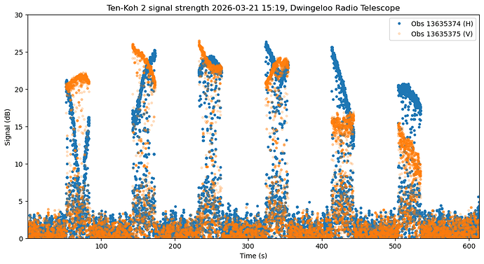

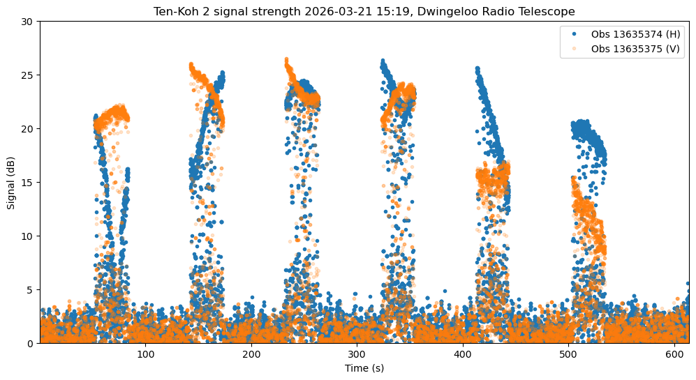

Another Dwingeloo observation of Ten-Koh 2: 13635374 / 13635375. Signal strength is comparable to the previous observation. In fading, we now saw a null in the first and second CW beacon on horizontal polarization.
