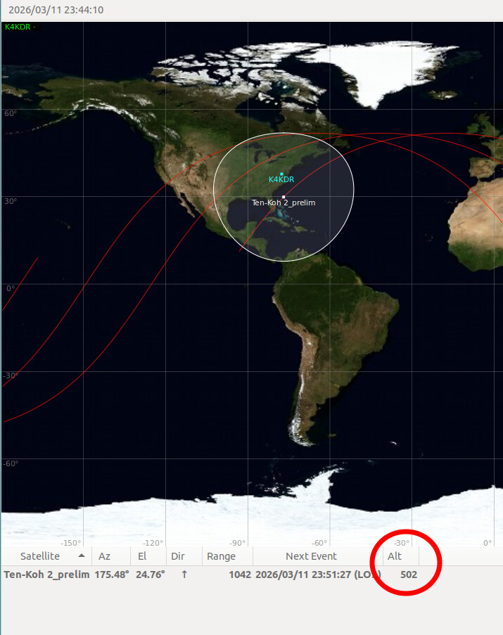

Great to see a TLE with the expected altitude for Ten-Koh 2. It’ll be later this evening before we get a chance from the U.S. East Coast

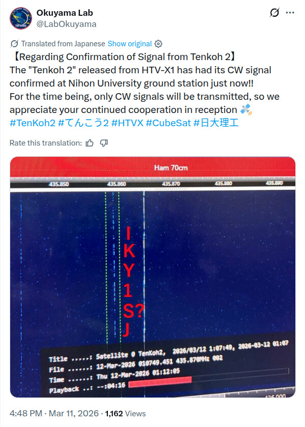

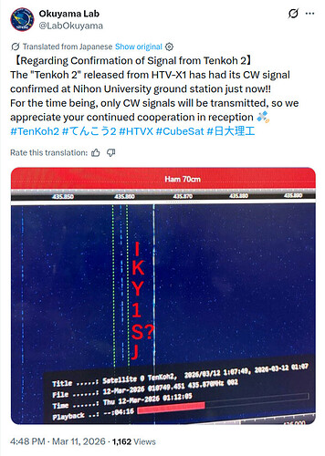

From twitter/X:
The signal from Ten-Koh2 is weaker than expected.
At our ground station, we are monitoring telemetry(voltage, temperature etc.) via the CW beacon. Reception reports via SatNOGS are very helpful. We would appreciate your continued support in receiving signals.
Again from Twitter/X:
Currently, only the CW signal on 435.860 MHz is active. It is transmitted every 90 or 180 seconds depending on the satellite status.
Thank you very much for your cooperation!!

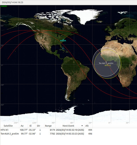

Here is an update to that Space-Track ‘88780/25241B’ object that is assumed to be Ten-Koh 2. Note that HTV-X1 has been assigned #66174 (25241A), so it stands to reason that 25241B will ultimately be declared to be Ten-Koh 2.
1 98542U 25241B   26071.31019830  .00010367  00000-0  45580-3 0  9995
2 98542  51.6301  60.3795 0004576 163.6979 196.4146 15.22421637   148
There is currently just over a minute of time between the two objects. Fingers crossed that Ten-Koh 2 can resolve whatever issue is restricting the downlink to such low SNR
