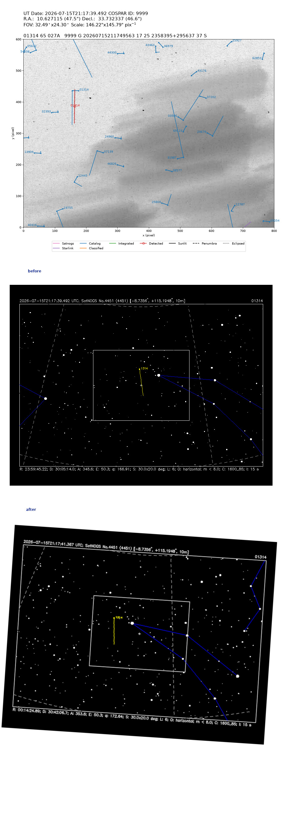

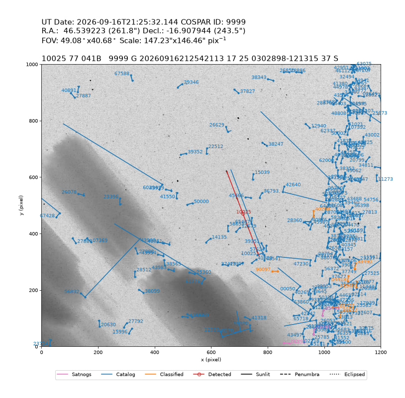

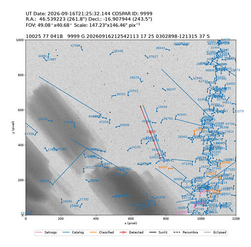

Stvid Setup, and optical observations for NOOBS

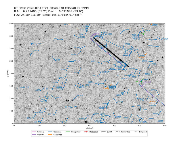

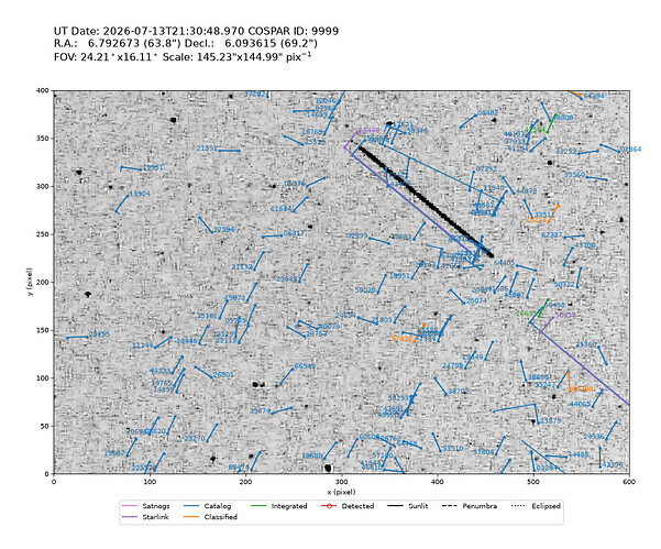

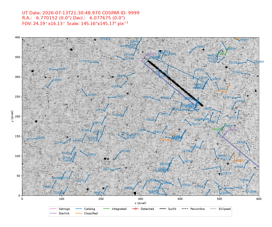

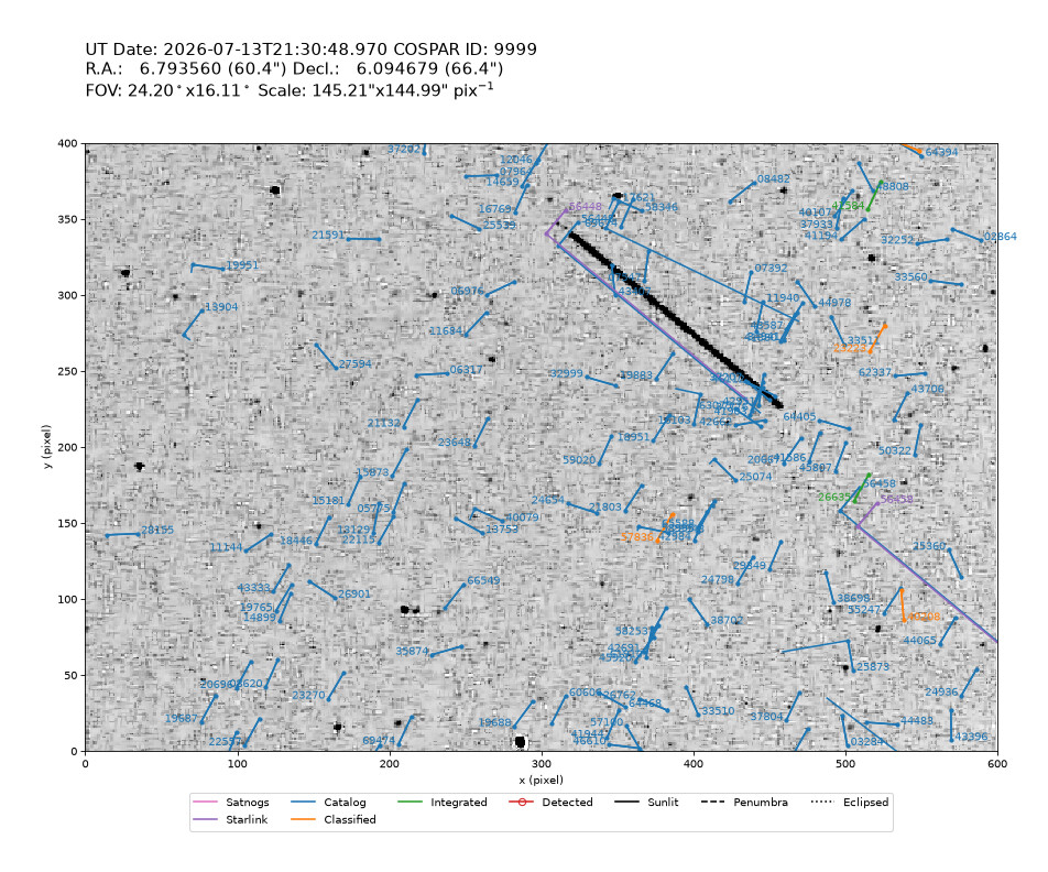

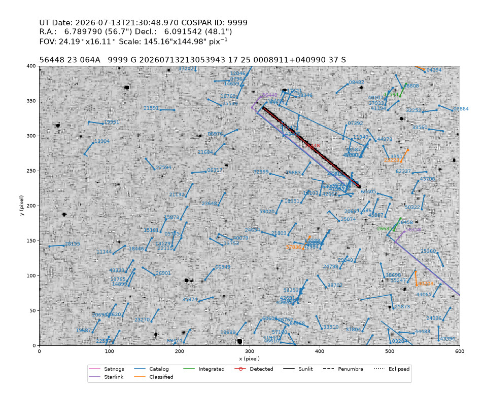

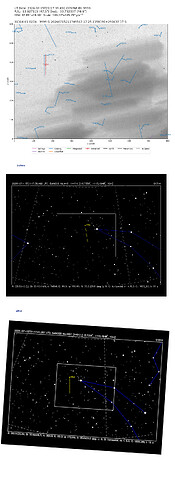

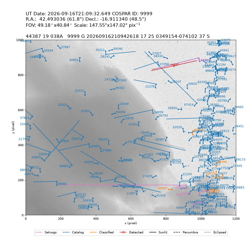

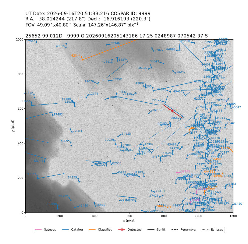

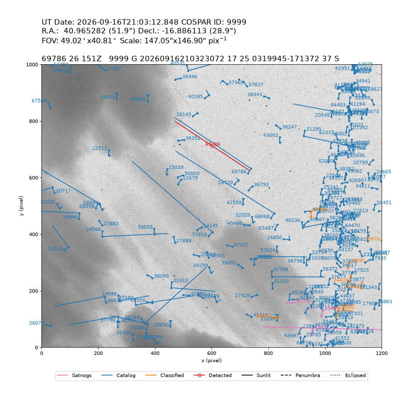

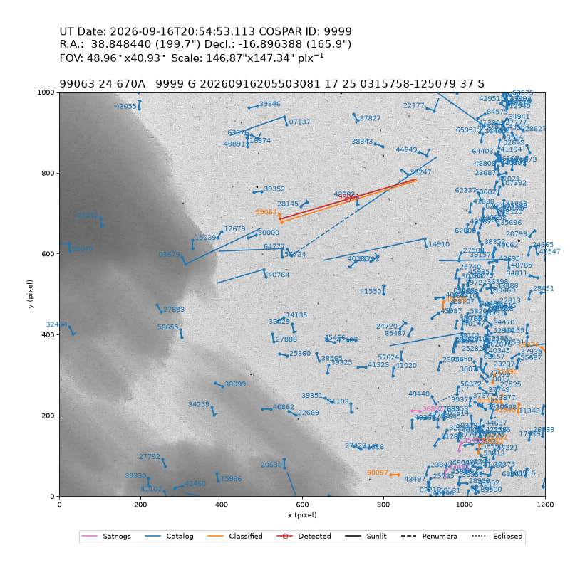

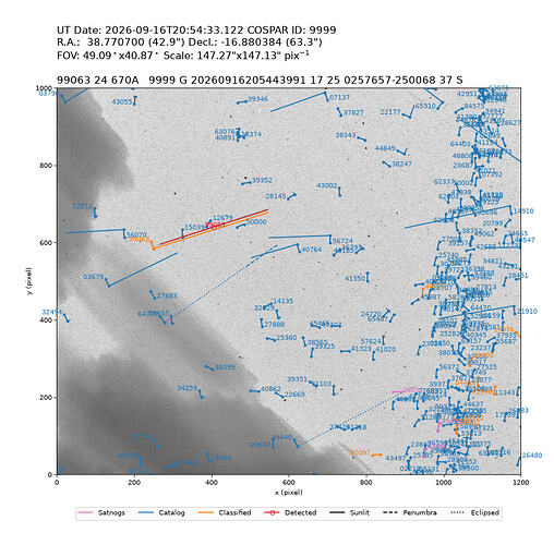

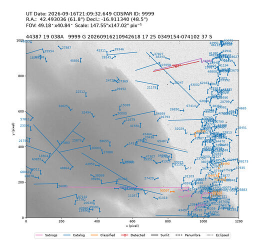

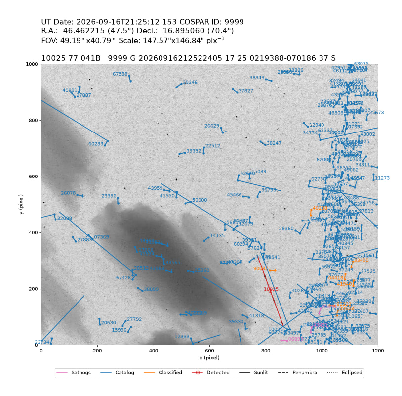

after increasing the max_magnitude, the obs is identified.
max_magnitude = 5
max_magnitude = 6
.fits data:
datafits.zip (4.0 MB)

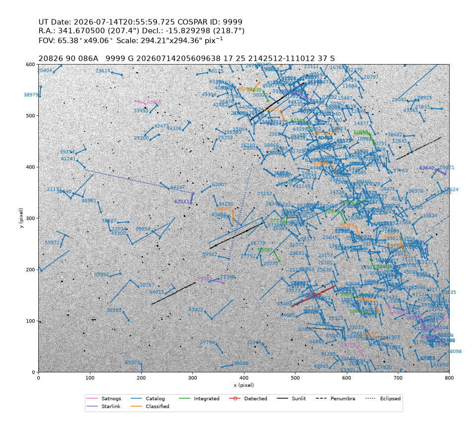

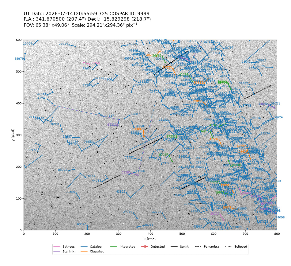

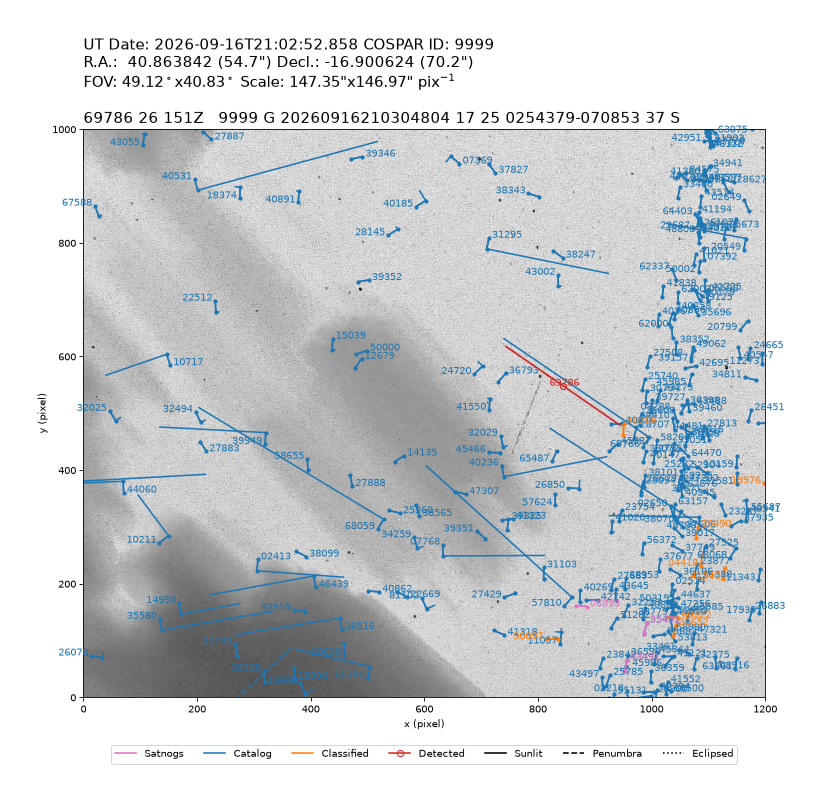

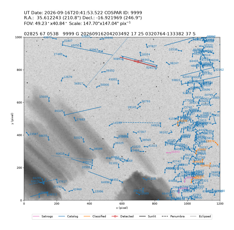

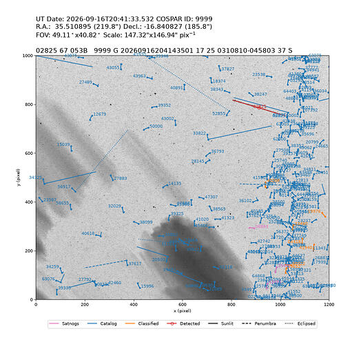

here i’m comparing max_magnitude from 5 to 15. between 6 to 15 with success (green) calibration, the image look identic, glitch only on magnitude 5 where no success (red) calibration
clear sky - 2026-07-14 (time in UTC)
my ip cam: TAPO C325WB (original firmware, default 20fps)
this my stvid configuration:
configuration.ini.share2satno.txt (4.3 KB)
configuration.ini

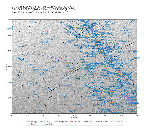

.fits example from obs and tle used:
tle.zip (2.3 MB)
2026-07-14T20-55-59.725.fits.zip (3.5 MB)

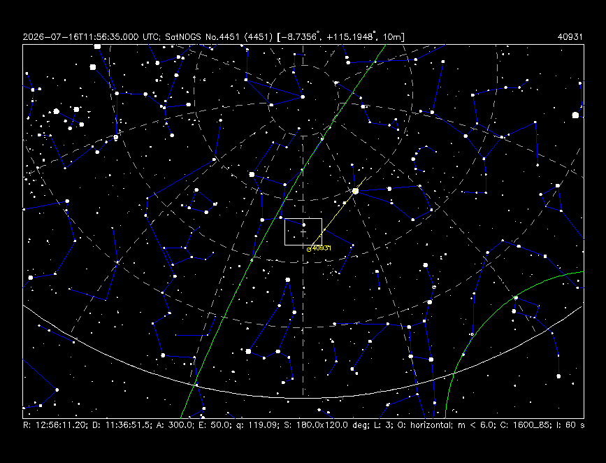

tips for targeting a specific satelit for optical obs:
first, you should know azimuth and elevation of your current camera setup.
the azimuth and elevation of your current cam, can you find when you open skymap with random sucess iod file (.dat) file from last observation, for example:
skymap -d 2026-07-15T12-36-20.282_66919_catalog.dat -c catalog.tle -i 66919
look at below image, you will find A for azimuth, and E for elevation
if you got the A and E, then
run this command:
skymap -c satno.tle -i 40931 -A 300 -E 50
satno.tle = tle catalog file
40931 = norad id targeted sat
300 = azimuth of your cam
50 = elevation of your cam
then use +/- for zoom
, and . for back/forward time
when the sat trail pass the square, its good. if the satelit not pass inside square, try change the azimuth or altitude. if you feel good with the azimuth and altitude, then set your camera position with this new setting.
make sure the trail color is yellow, that mean the sat exposed by sun light.
Thanks for this instructions Bali!

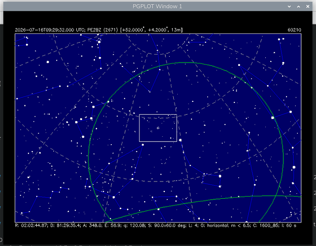

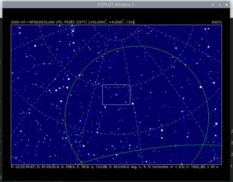

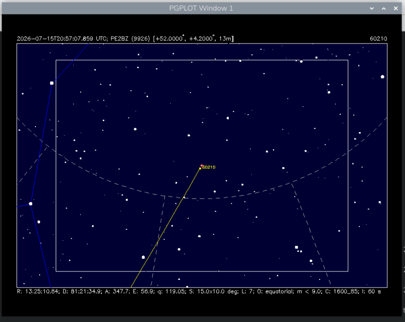

I tried to give this a go on a detected satellite from last night.
skymap -d 2026-07-15T20-57-06.713_60210_catalog.dat -c ~/software/tle/catalog.tle -i 60210
60210 24 125H 9926 G 20260715205707859 17 25 1325245+812984 37 S
2026-07-15T20:57:07 60210 4.9 0.7 d 427.97 km 111.67 deg
which shows
so, my Azimuth is 347.7 and my elevation is 56.9 , would you know if that’s the elevation in center of the image ?

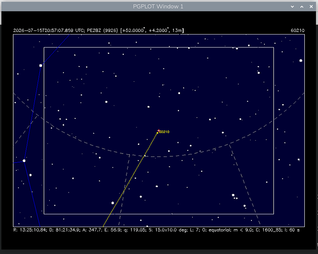

This image shows the yellow trail, I zoomed in a bit.
After that I ran
skymap -c ~/software/tle/catalog.tle -i 60210 -A 348 -E 56.9
showing no trace / yellow line. Any idea why not ? EDit:
I think I understand, the last plot shows the current time so you can browse for upcoming FOV passes.
Thanks,
Ben
look at the time. default without set the time, the skymap will show current time. you can set time with option -t
t date/time (yyyy-mm-ddThh:mm:ss.sss) [default: now]
or just use button , and . for back forward time
note: you can see the color of sky is different. darker mean night, lighter mean day
i compare the .png file output from processing.py. and skymap and i found it maybe different around 5 degree on azimuth on my wide view ip cam
also something the camera position in reality maybe there is a little tilt that make little different angle if see the result of png or skymap that flat
before:
skymap -d 2026-07-15T21-17-39.492_01314_catalog.dat -c ~/tle/catalog.tle -i 01314 -t 2026-07-15T21:17:39.492
after azimuth adjustment:
skymap -d 2026-07-15T21-17-39.492_01314_catalog.dat -c ~/tle/catalog.tle -i 01314 -t 2026-07-15T21:17:39.492 -A 353.6 -E 50.3
and here i adjust with gimp, little tilt to right

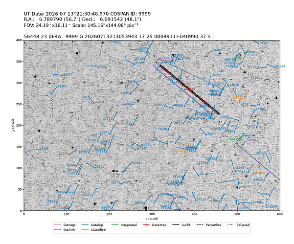

this morning in short window time, with the sky not to clear much, i got interesting satellite , some is classified sat. (all time in UTC)
this look like the orbit of above satellites / rocket body. mostly LEO satellite

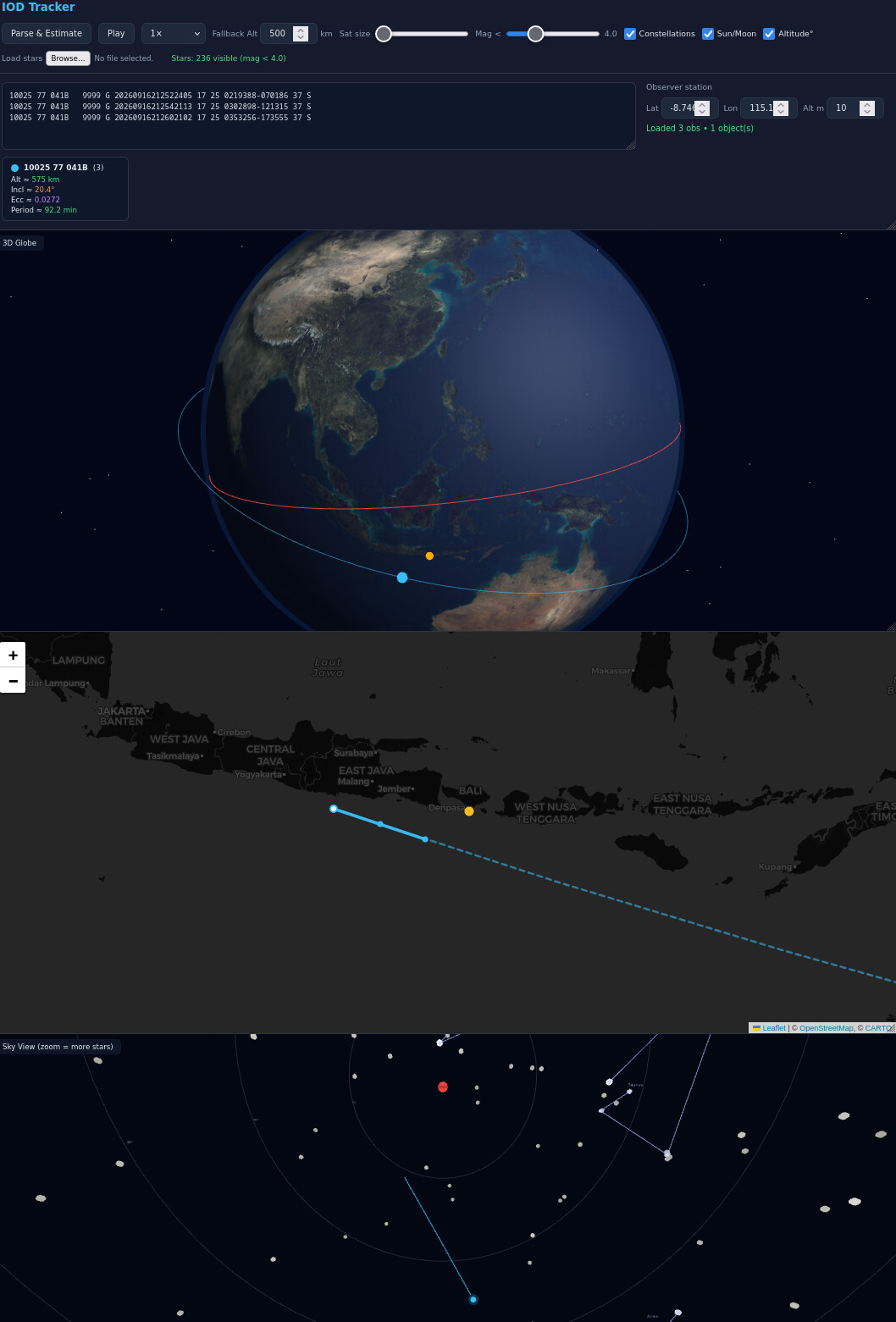

i trying create simulator to visualize the iod, and learning more about iod format .. you can try here:
https://hobisatelit.github.io/iod
this tool, make me better understand about iod format
