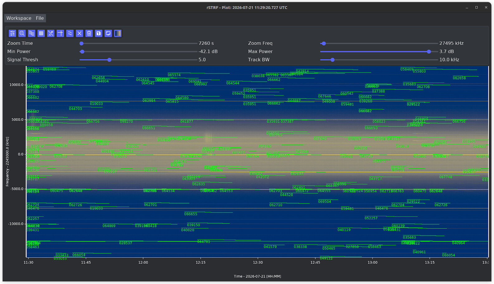

Tried a dry run at 30.72 MSPS with -B set for 5MHz
Output in rstrf shows nicely:
So now I am going to let this run for the night with 22 MHZ bandwidth and check tomorrow if I have less images from outside the band.

2245 center, 30.72 MSPS sample rate and 22MHz bandwidth. Looks like this is working. The lora signals at the bottom are much weaker as without the -B option enabled.
