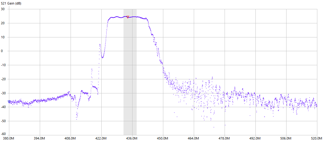

I have made a frequency change for my station 858 in Stockholm. The new frq is now 430 - 460 MHz. I will add a LNA and Band Pass Filter for the amateur radio 70 cm and the frequency respons is according to the image below.

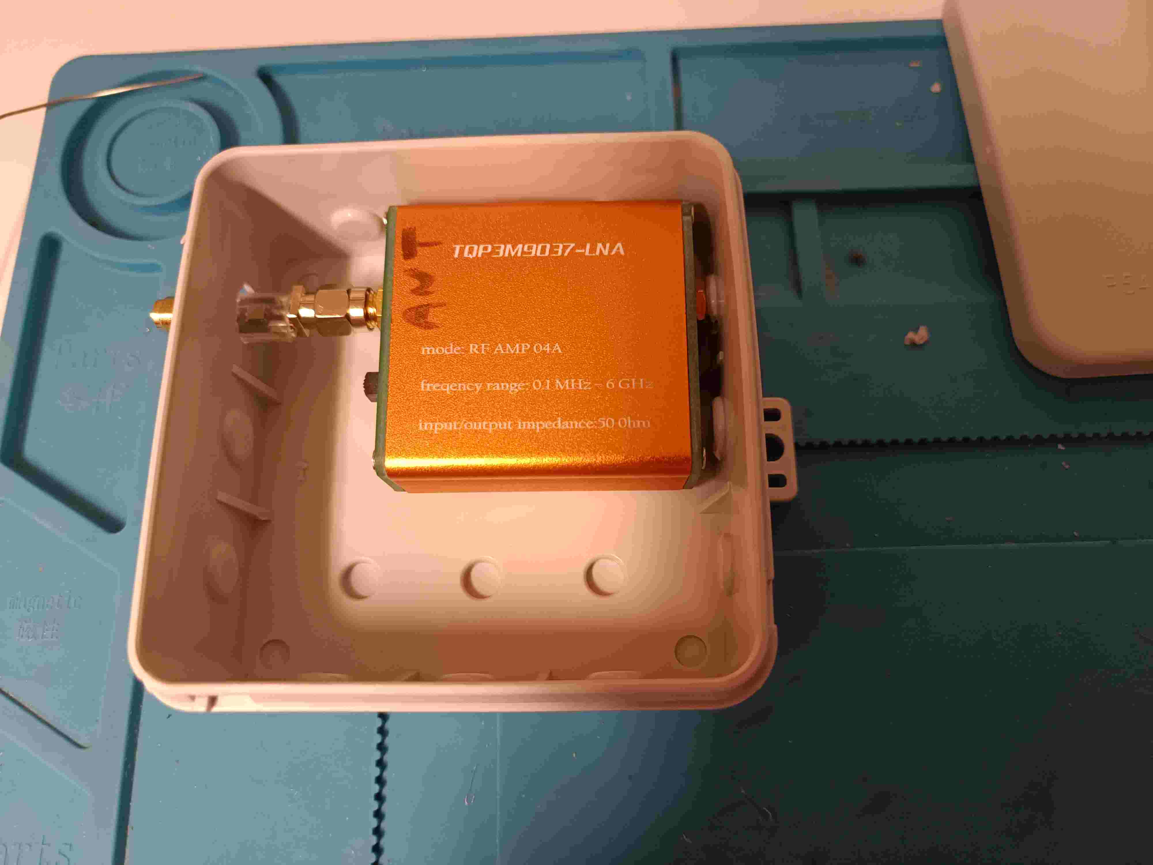

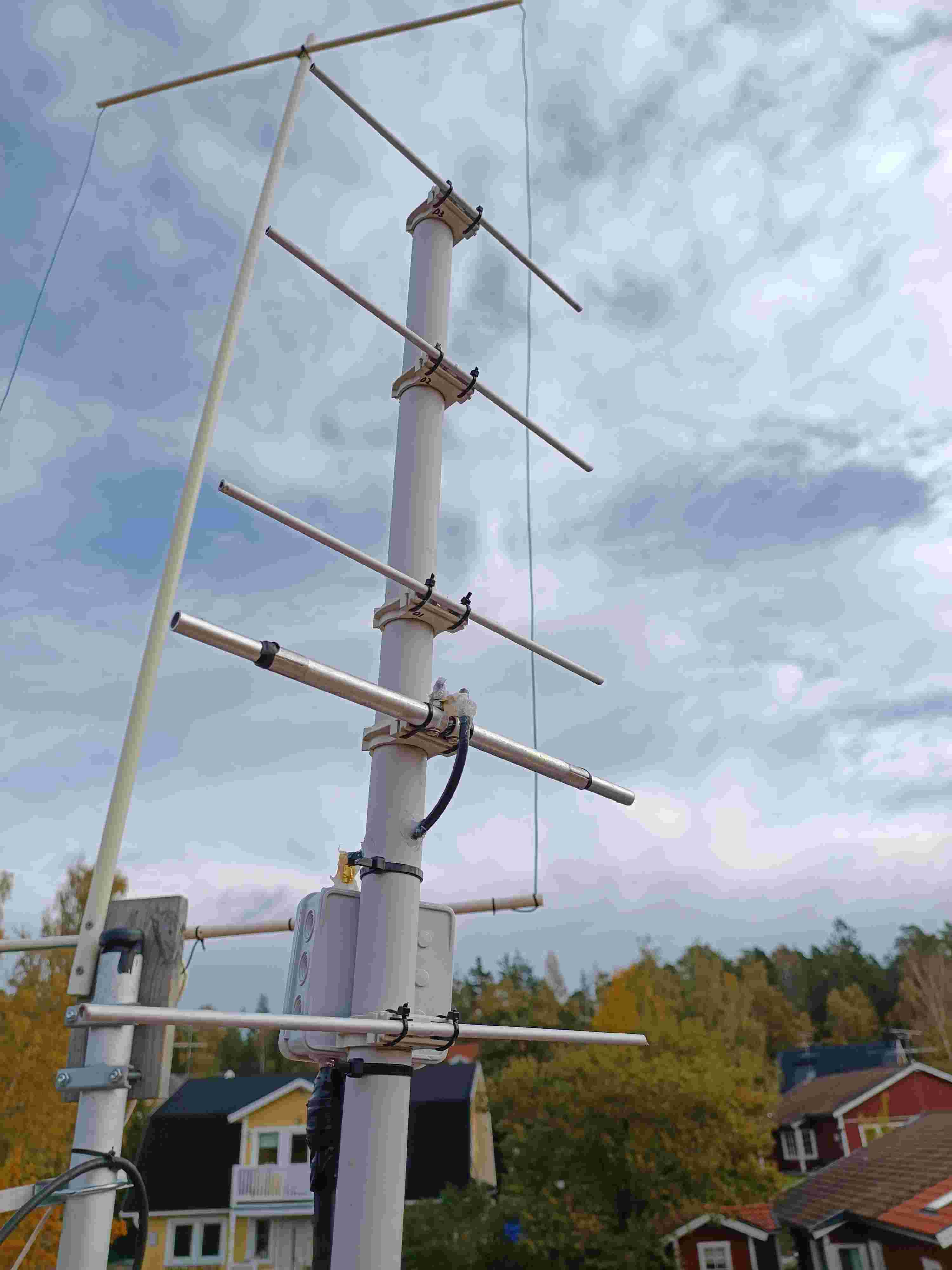

Hi Lars, can you share any info about the bandpass filter ?
Yes of course! It’s all inexpensive AliExpress items:
Bandpass filter: BPF 315M 403M 433M 868Mhz 915Mhz 1.2G 1.5G 2.4G 5.8G LC Band Pass Filter FOR Ham Radio RF POWER Amplifier Transmitter Receiver - AliExpress 1420
LNA: 100k-2GHz RF AMP 100k-6GHz full-band amplifier preamplifier high linearity ultra-low noise gain amplifier - AliExpress 44
Some more information about the LNA and BPF installation:
