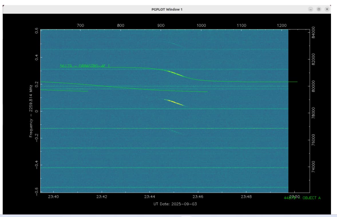

TAIFA-1 is constantly received by following the new object (56208)

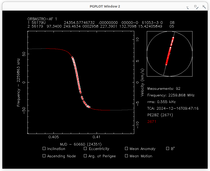

Appear to have caught ORBASTRO-AF-1
centered 2259.977 taken from the middle of top and bottom signal. Other modulation as Orbastro-PC-1 from Transporter 9 launch.

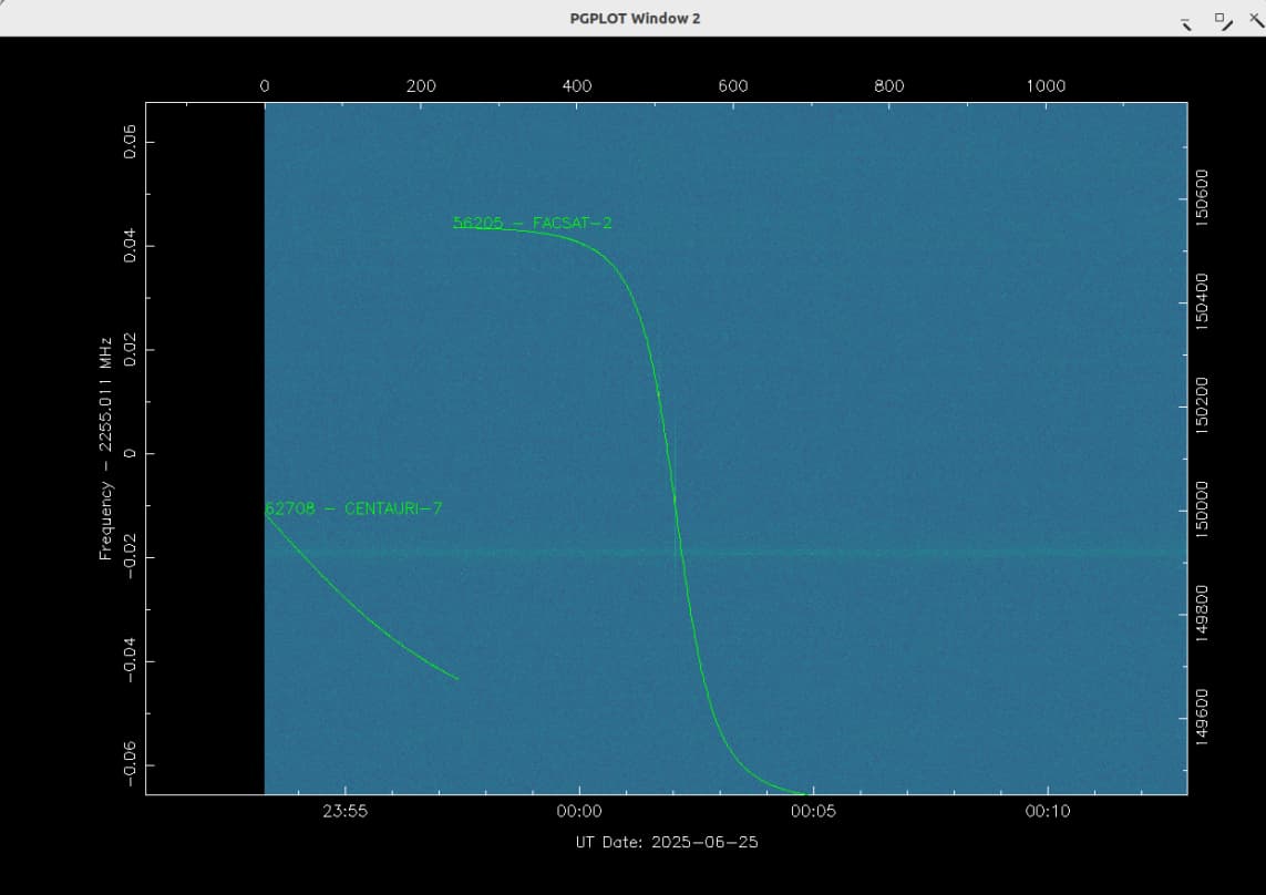

56205 FACSAT-2 on 2255 MHz ? added as unconfirmed
56179 ORBASTRO-AF 1 on 2255.979 center, but no center (FM) carrier. so suggested as bpsk 200000 baud unconfirmed
Center calculated from the two strongest center signals.
