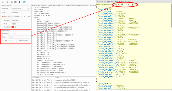

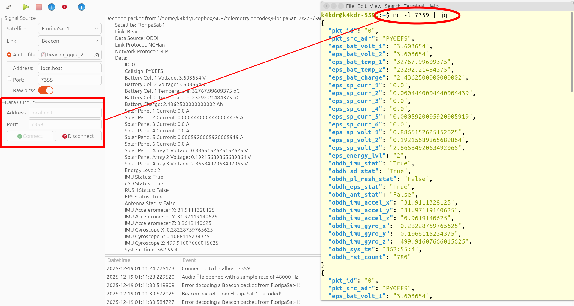

Thanks Bob - you certainly saved me a lot of time!
Note that the “Data Output” option sends JSON formatted decodes to whatever you have listening on the (default) port TCP-7359.
So, as one example, the command
nc -l 7359 | jq
will setup a listener for the SpaceLab Decoder to connect to. I’m sure there are other options as well. But here is that display:
… you could certainly pipe the JSON-formatted output to a file; another option is that Node-Red parses JSON input extremely well, too.
The sample file used here is from: grs/samples at master · floripasat/grs · GitHub
(note that this test was w/ the ‘beacon’ sample file… the ‘download’ sample file produced errors in the decoder)

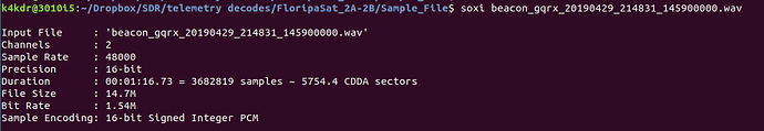

Hi Bob,
Thanks for this information, I was only wondering if these are IQ or demodulated audio files?
And of course the ssmple rate.
not answer, just inform that the wav file running well at sdr++ , it should be iq file
The sample files from
… are 48k audio!
