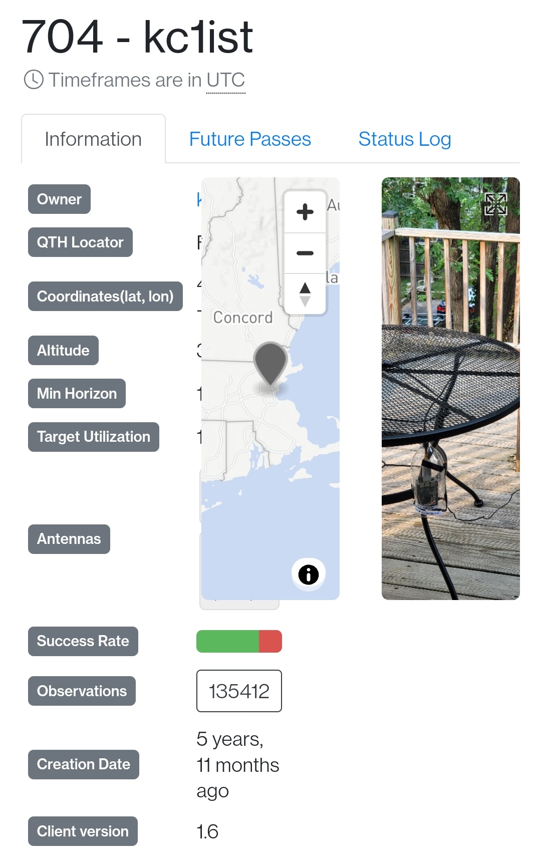

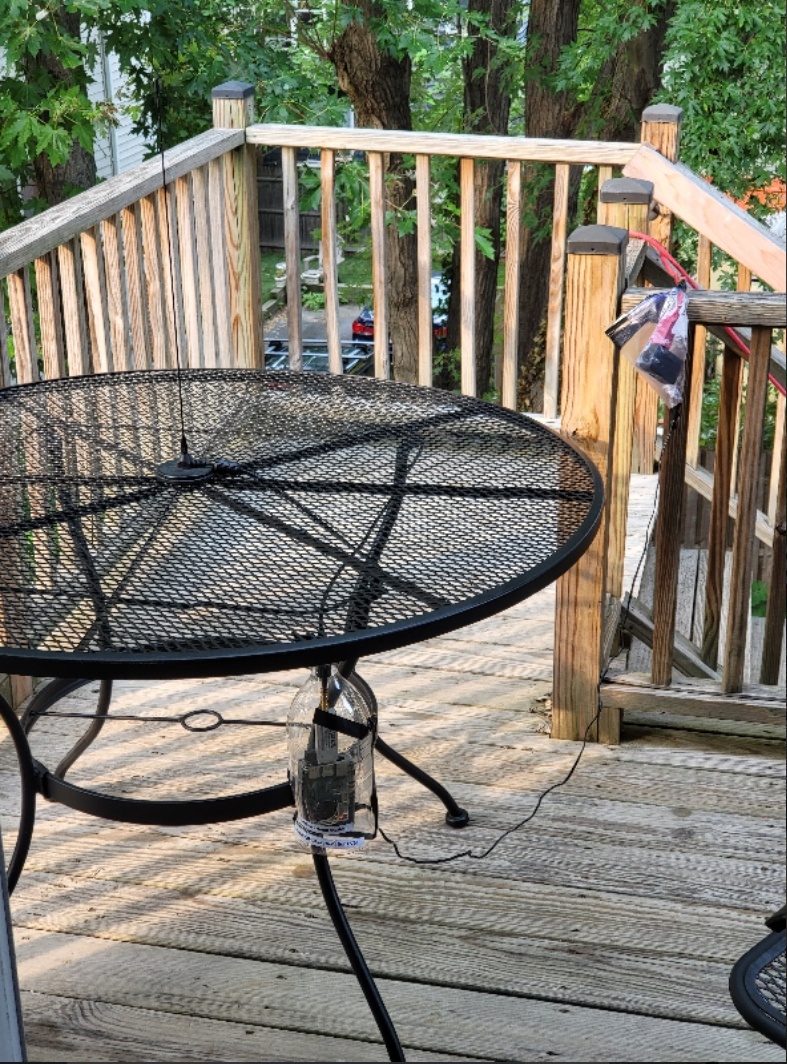

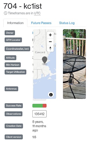

Hello, I’ve seen that there’s a station on here that was using one and was getting pretty good signals. I’m not sure of the station number so I can’t direct you to it but they put a small antenna like that on a patio table and it works. The station had its antennas in the picture on the bio of the station, only way I know about the antenna used. Worth trying
… Wait… Googled it and found it ![]()
https://network.satnogs.org/stations/704/
Great, it looks like they have alot of successful observations. It looks like his antenna is wide open whereas I was planning to keep the SDR+LNA atatched to antenna within the enclosure. I’m not sure whether it would block the signal or if it wouldn’t even be necessary.

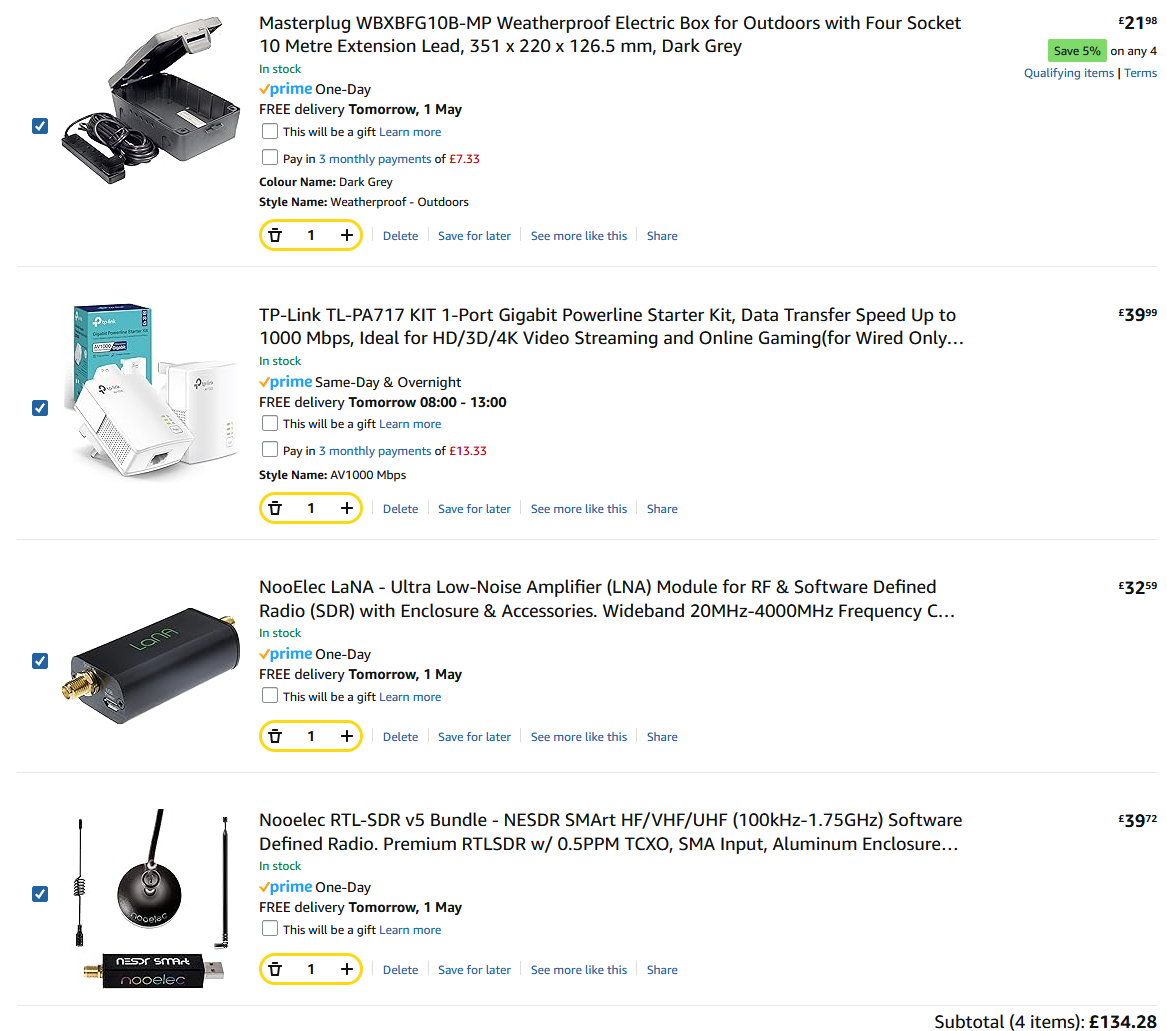

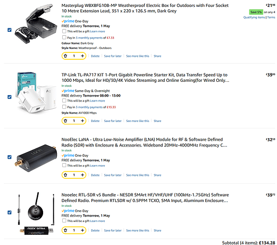

Here is the list of items i’m planning to get from Amazon. (I already have a Raspberry Pi and power supply)

use a proper ground plane connected to the end of the coax shield, or a metal table as in station 704 (:
