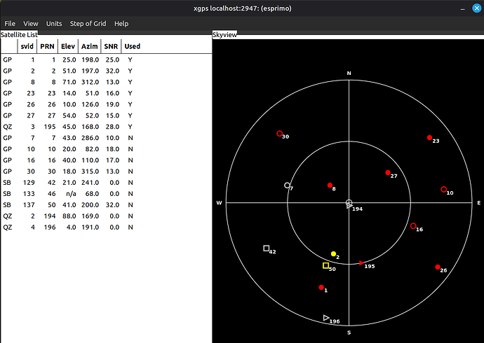

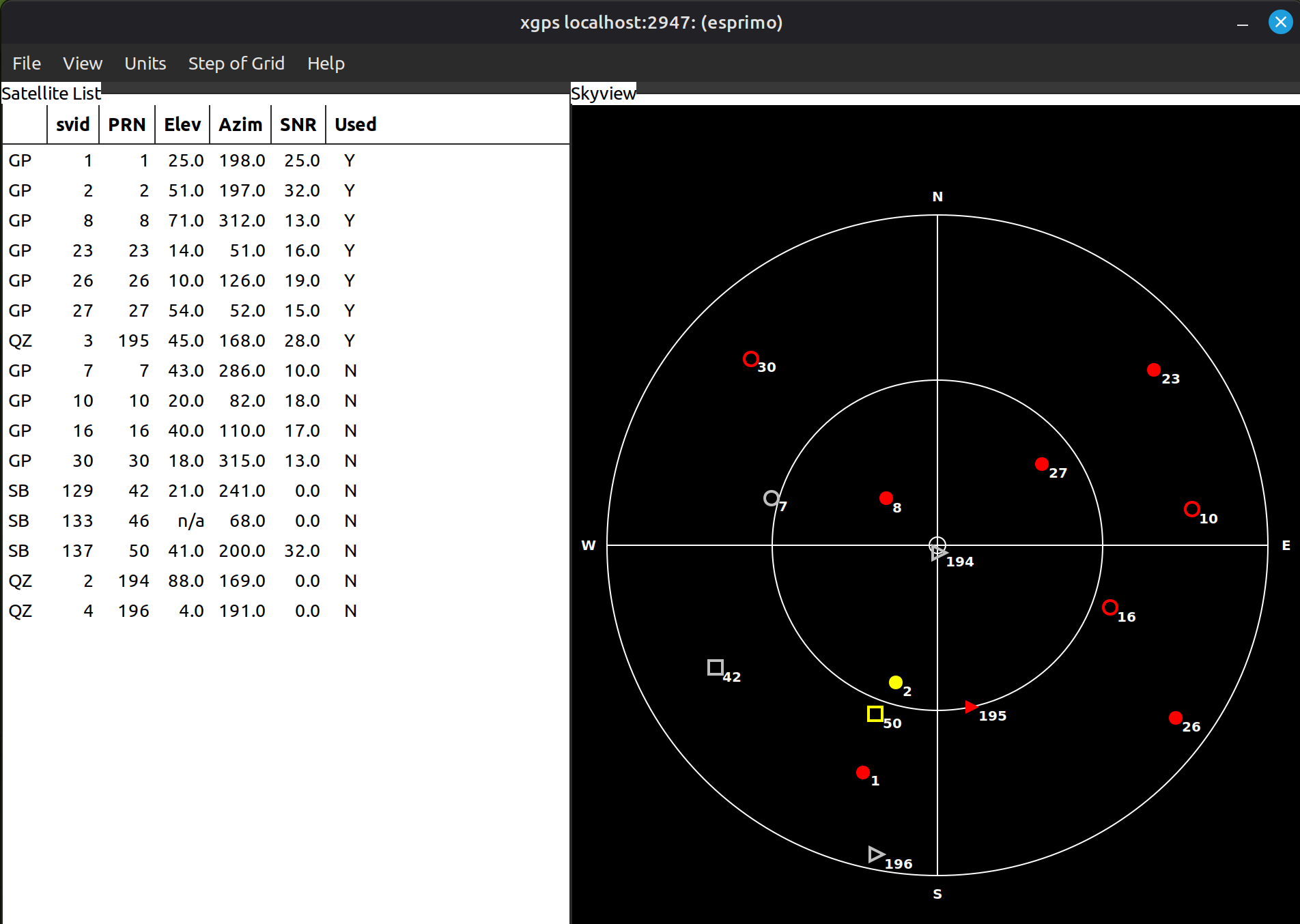

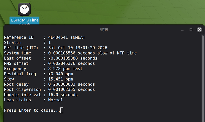

I wanted to share my recent setup of a Stratum 1 NTP server using GPS/QZSS as a reference source.
System Status & Performance:
  • Stratum: 1 (NMEA / PPS)
  • Offset: ~0.1 ms (System time is ~0.000105 s slow of NTP time)
  • Satellites: Tracking multiple GPS and QZSS (PRN 195, etc.) satellites via gpsd / xgps.
Attached are screenshots of chronyc tracking and xgps showing the signal reception and timing precision.
Hope this helps or inspires anyone looking to build a precise time reference for their ground station!

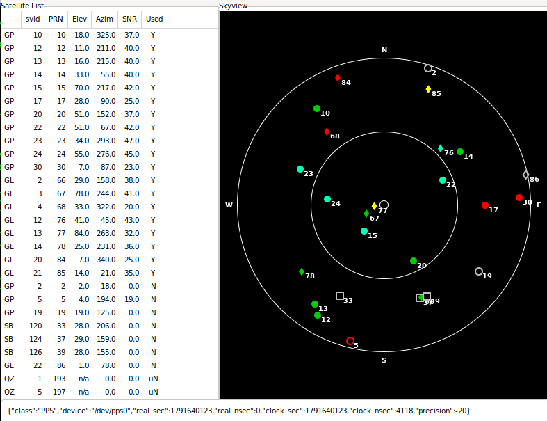

Thanks for sharing, does you GPS receiver also provide PPS?
This will give you an even better time accuracy.
Reference ID    : 50505300 (PPS)
Stratum         : 1
Ref time (UTC)  : Sat Oct 10 13:45:25 2026
System time     : 0.000000104 seconds slow of NTP time
Last offset     : -0.000000155 seconds
RMS offset      : 0.000000661 seconds
Frequency       : 12.186 ppm fast
Residual freq   : -0.002 ppm
Skew            : 0.041 ppm
Root delay      : 0.000000001 seconds
Root dispersion : 0.000015167 seconds
Update interval : 8.0 seconds
Leap status     : Normal
Thanks! Since this is a USB dongle, I’m only using NMEA right now. PPS sounds great for even better accuracy—might look into it if I upgrade the hardware later.
sudo chronyc tracking
Stratum         : 1
Ref time (UTC)  : Fri Oct 16 10:42:15 2026
System time     : 0.000000052 seconds slow of NTP time
Last offset     : -0.000000052 seconds
RMS offset      : 0.000000948 seconds
Frequency       : 17.424 ppm fast
Residual freq   : +0.001 ppm
Skew            : 0.098 ppm
Root dispersion : 0.000011520 seconds
Update interval : 16.0 seconds
indicator: smaller RMS offset and Skew, better
