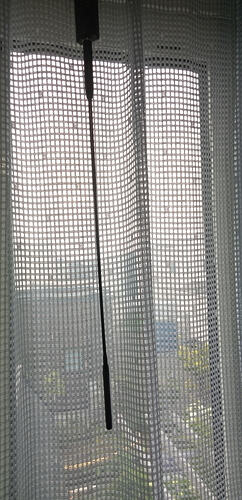

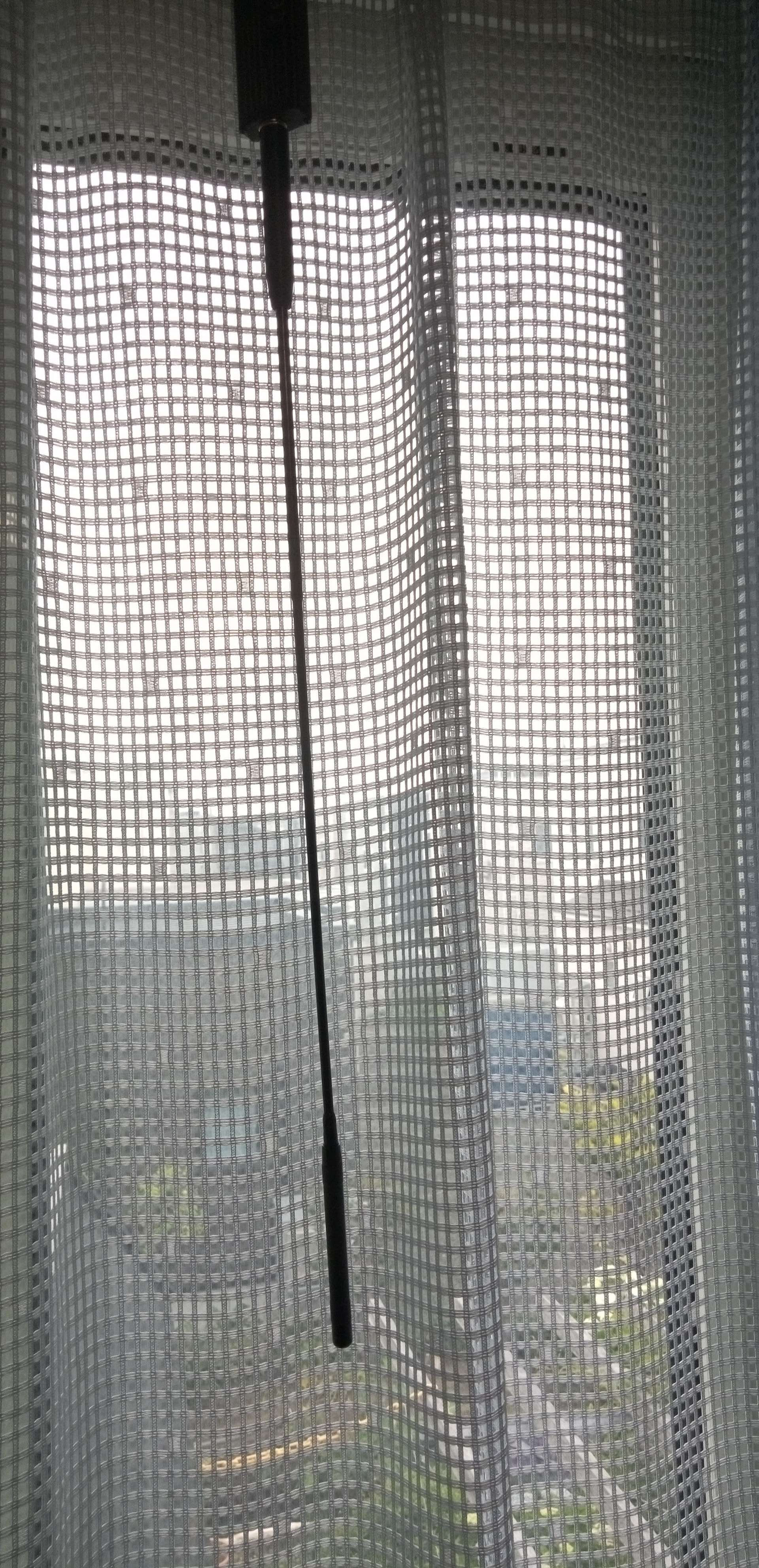

I live in a snowy region in northern Japan, so it is difficult to install an outdoor antenna. Currently, I am using a mobile whip antenna hanging from my second-floor window, connected directly to an SDR dongle (as shown in the attached file “unnamed (18).jpg”).
I am concerned that this setup might not be sufficient to contribute effectively to the SatNOGS network.
  • Is it possible to contribute with this kind of indoor/window-mounted setup?
  • Do you have any recommendations for small improvements I could make, considering the harsh weather conditions here?
I would love to hear any advice or suggestions from the community. Thank you so much for your time and help!
Best regards, yukio

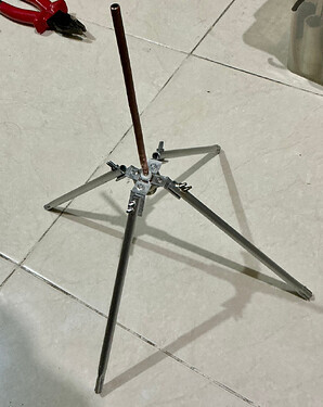

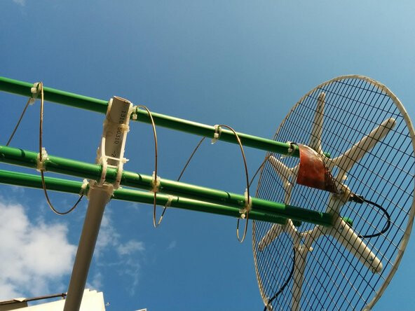

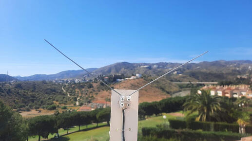

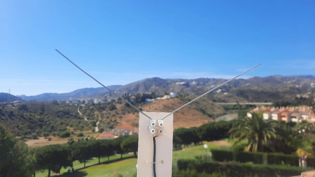

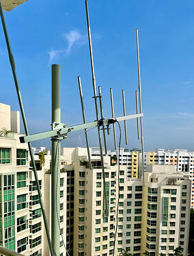

if you put antenna indoor, and on one side direction (behind window), maybe you can try change your antenna to directional antenna (high gain), like yagi or helical uhf antenna. or maybe simple omni: v-dipole (pretty good for high elev sat, and easy to make), 1/4 GP (good for low elevation, but maybe more noisy in city environment)
for example this station:
Hi bali,
Thank you so much for your kind advice and for sharing these photos!
The examples you provided are very helpful. Since I am in a snowy region in northern Japan, I have been hesitant to install anything outdoors, but seeing these setups motivates me to think about how I could build something similar that can withstand the winter.
I will definitely look into the V-dipole and Yagi options as my next step. Thanks again for your encouragement!
Best regards, yukio
If you have a bigger window i would recommend you move your antenna or station to it so you have a better field of view for your antenna but your current setup should work good enough. Also if you choose to use a directional antenna and you want something relatively easy to build I would suggest this 3D printed moxon antenna here: https://makerworld.com/en/models/1379081-433-mhz-moxon-antenna-1-1-swr#profileId-2964615 assuming you have a 3D printer.
