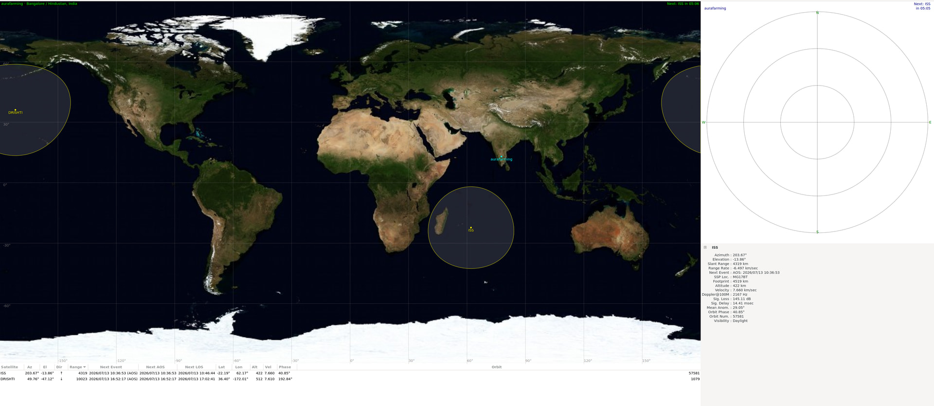

SECRET tools on GPREDICT since 2017 (SEE IT BEFORE DELETED)

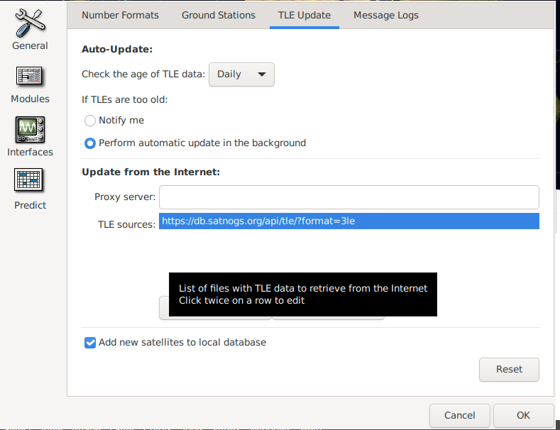

maybe update your tle. or add satnogs db tle as your source:
got it , it was due to my firewall i was not able to fetch the celstrack but now its working, but still after adding the db.satnogs in TLE network i’m not able to get ground track. all the settings i have checked but didnt able to hunt. any suggestions?
do you mean this, right click on dot satellite at map , then check ground track
gotch!!! thank you.
