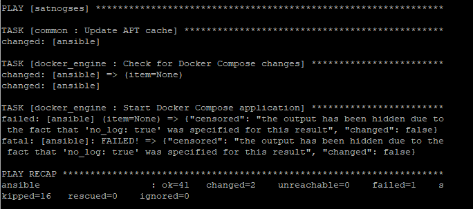

Hi,
I installed satnogs on my Raspberry Pi4 but after running satnogs-setup I get an error (see image). Can’t find a solution for this.

Hi @ct1ete,
Is this during the first installation or after the installation when you went to satnogs-setup?
Which image have you used with the RPi4?
Did you follow the installation process in the wiki or something else?
Hi
This was during first installation. I followed wiki instructions and distro is bookworm 64 bits lite. I have the same distro working fine on a Pi3.

Tried to install a second time from the beginning and I have the exact same error.
Hello,
I tried reproducing the error but I can’t. Can you provide some more information? Is there anything special on your setup? What is the size of your SD card?
Hi,
Nothing special about my setup.
My SD card is 8GB. I will buy a 32GB and see if that’s the problem.

try this
And make sure you have >= 16Gb, even 16Gb is on the small size the moment you are confronted with docker image updates.
Thanks to all of you. No problem with a 32GB SD card. 8GB won’t work.
