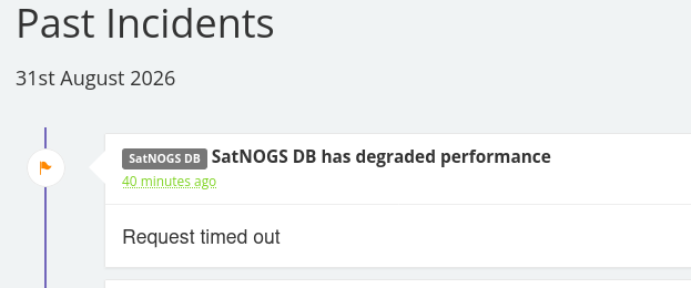

I am sure that you are aware but the network is down (error 500 in browser and docker log). Can go back and find when it died if you like.
you are right. same here..

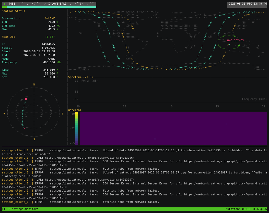

live stream from here :
zoom, an notice 500 server error
finally i found real use case for this live streaming over asciinema.. poke @mhuebner
Glad you find it useful. When we started at www.dk0tu.de with streaming the station roughly one year ago, we did it mainly for publicity. The stream is embedded in our website too:
