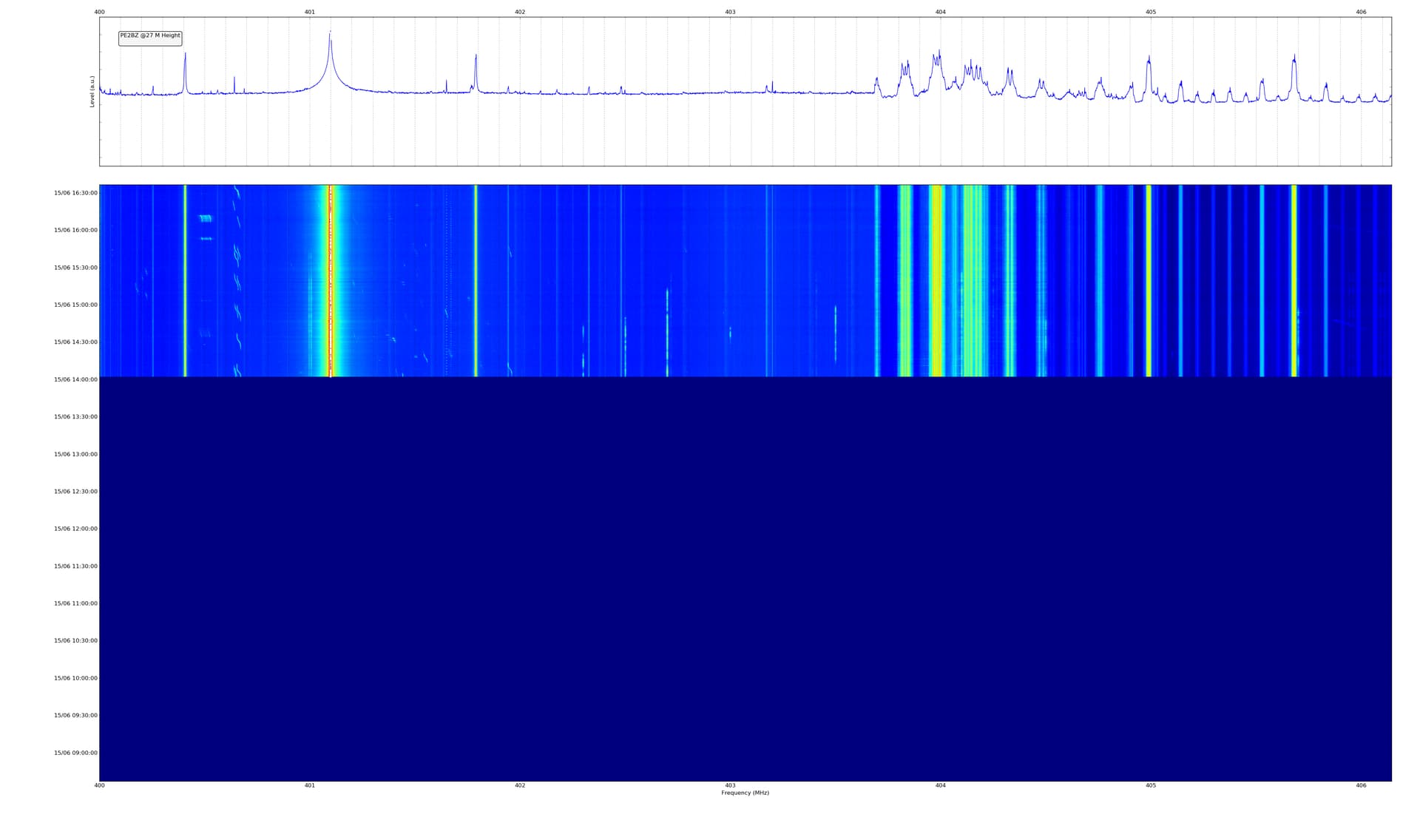

Hi, for years I am running a Python script to create waterfall screens for the radiosonde band (400 - 406 Mhz) and sometimes also for L band satellites or the P-band ( 430 - 440 MHz).
Problem is, running rtl-power with a frequency range ( like 400M:406M ) sets the “number of hops” to 5 and the rtl dongle switches to 2.8 or 2.5 MSPS giving ghost images in my waterfall. Tried several alternatives to find one where I can set the rtl to a fixed (2.048 ) sample rate but no luck. Last try was to set the end frequency of the range to a multiple of 2.048 to make it understand the sample rate could be just 2.048 msps but also no luck, looks a bit random which samplerate is choosen. An example of the output is shown.
Close to my receiver station they have arranged an Tetra transmitter at 408 MHz which gives a lot of harmonics showing in the waterfall. On the same antenna I have an rsp running with 7 MHz and those signals are not in the rx window between 400 and 406 MHz.

A little peek in the command ran:
rtl_power -d 0 -f 430M:440M:4k -g 25.4 -p -4 -i 30 -c 50% |
python2.7 skymonitor.py 430000000 2441.41 4096 8
rtl_power shows a bin size, a number of bins and number of hops which are passed to the python script .
