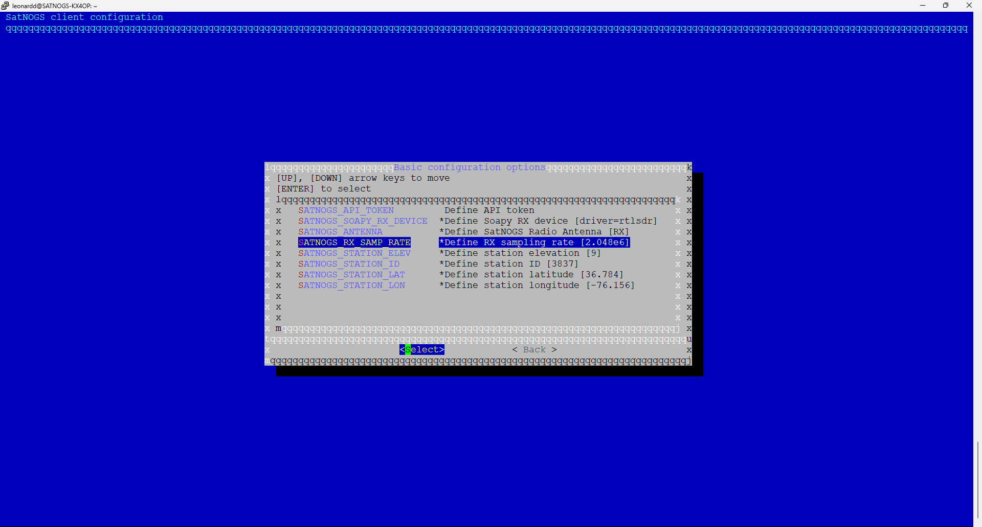

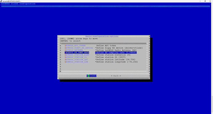

Satnog localhost file:
satnogs_antenna: RX
satnogs_api_token: 57b7633cfdb787723e925c4d0a00d2f3b3ca9b64
satnogs_rf_gain: ‘22’
satnogs_rx_bandwidth: ‘200000’
satnogs_rx_samp_rate: ‘0.032’
satnogs_setup_ansible_branch: oldstable
satnogs_soapy_rx_device: driver=rtlsdr
satnogs_station_elev: ‘9’
satnogs_station_id: ‘3837’
satnogs_station_lat: ‘36.7840736’
satnogs_station_lon: ‘-76.1562561’

clear out the rx bw
samp rate should be one of 1.024, 1.536, 1.792, 1.92, 2.048, 2.16, 2.56, 2.88, 3.2 for example 2.048e6
This is not good, @fredy is going to reset that for you. Don’t post the token publicly.
You need to fetch the new one and put in your satnogs-setup
Hi @dleondroid, as @SA2KNG noted the API Token is private and should not be exposed. Thus I’ve removed the exposed Token and you need to re-generate one.
For doing this you just need to login at the Network site, and in your dashboard page to press the API Key button, this will show you the newly generated API Token. This should be also changed in the Client side through sudo satnogs-setup, just don’t forget after changing it to hit the apply button.
For the future, please use the support report functionality as described in the yellow box in the troubleshooting page Troubleshooting - SatNOGS Wiki for sharing your configuration.
Crap!, I scrubbed all my user name info, but missed that.
Are there multiple config files? OR I had already changed it. this is what it shows in the setup wizard.
