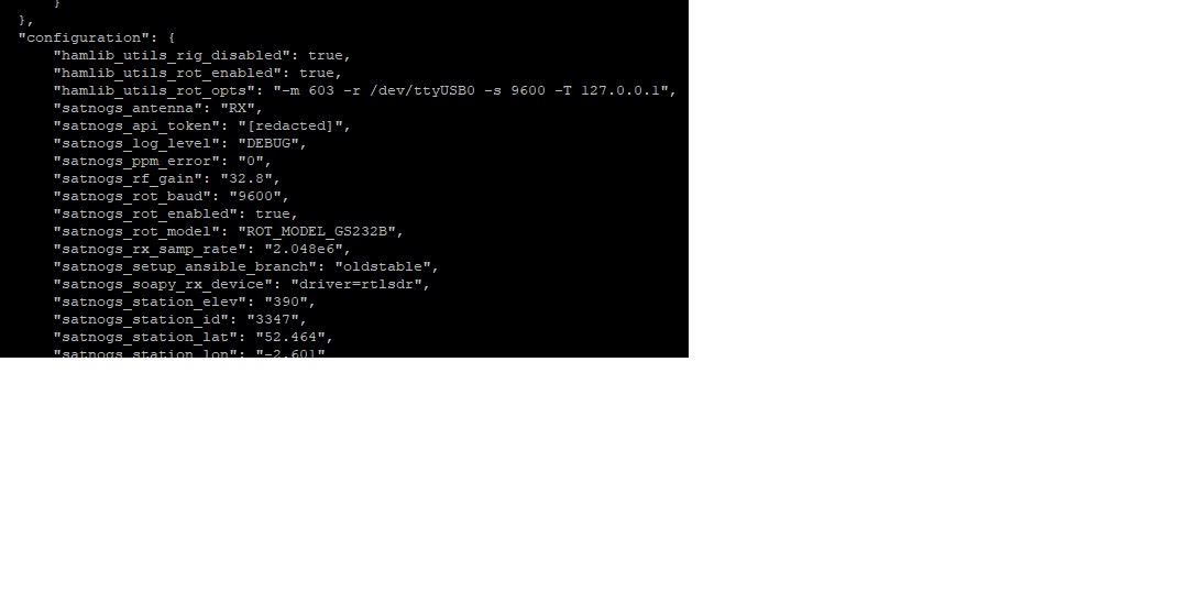

I could do with a little help to get my Yaesu G1000DXC up and running please.
Firstly I installed Satnogs Legacy from this link SatNOGS Setup Legacy - SatNOGS Wiki
onto the Raspberry Pi 3B+, I then set up the config file so the Pi would communicate with the K3NG rotator controller.
The rotator works perfectly with GPredict via the K3NG interface configured as a GS232 (Yaesu RS232 interface) So I am guessing my issue is related to my incorrect Satnogs config. see below.
If any one picks up on this I can share more information as needed , debug logs etc,
I have read many posts on here and none seem to help much, thanks
