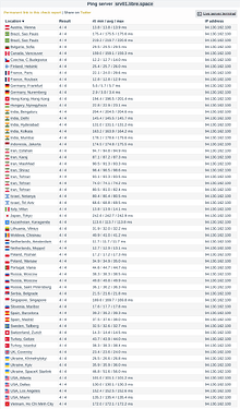

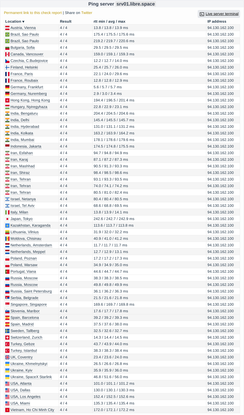

for real-time comparison check here
Perhaps my local ISP is dropping that address because I can’t reach it with any device at home.
